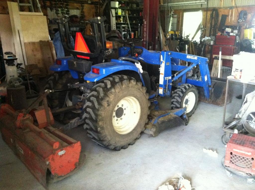

    Let's get a pic of that hook up. That's gotta be a beastly mower

    Here is my mower

    That's one nice machine! I'd be out playing in the yard all day with one of those. Dig a hole, fill it in, dig another hole....
    A 4 mile tow shouldn't be an issue as long as there's brakes on the trailer and it's not a 10% grade climb the entire way.
