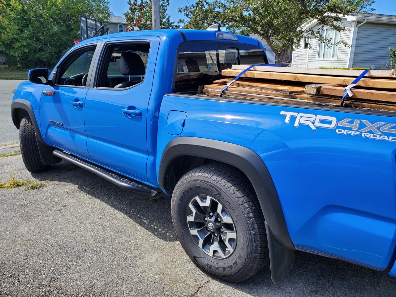

    My GVWR is 2540 kg or 5600 lbs and I weighed in at 2960 kg or 6526 lbs, which was 420 kg 926 lbs over.

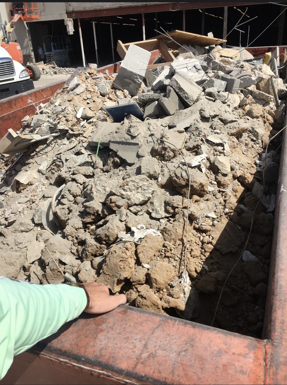

    Props to you for a tidy and secured load. I’ve worked around landfills for the last five years and you wouldn’t imagine the stuff I have seen coming into those places. Stuff loosely strapped from behind tailgates to front bumpers hanging off truck roofs, trailers with shit falling off the sides all the way to the dump site, you name it. We haul big boxes and it still gets...interesting.
    7A2B5F9C-A572-490A-9C58-822CD44F0589.jpg16E20AA5-07AB-4E15-A653-B29CEBDBECD3.jpgB18BDE7C-DCB4-48E5-B691-418878C63002.jpg
    Every customer is told “Nothing over the top and a 10 ton limit”
    My record haul has been a 24 ton load. Couldn’t recommend it lol
    Edit: Tonne to freedom units

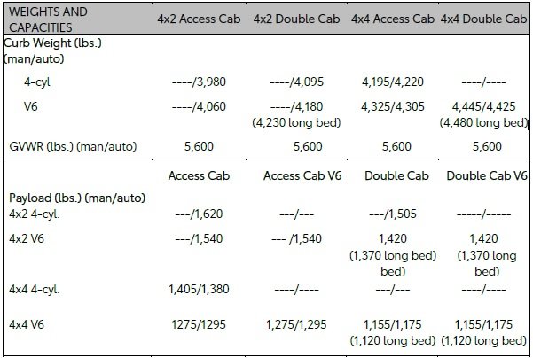

    That dealer hype you just posted is flat out wrong for “truck bed” capacity. Maximum payload depends on the model Tacoma you have. Actual payload includes weight of passengers, cargo inside the truck, cargo in the bed, and anything you have added to the truck. And in no case is max payload ever 1685 in or out the bed, far less for some models. Look at the door tire rating sticker for max payload for your truck. And here are Tacoma specs for a 2019, pretty sure 2020 is the same specs.
    My 2019 SR 4X2 4 cyl Access Cab has the highest payload rating of all models due to its lighter curb weight per the specs, 1620 lbs (Max Payload=GVWR-Curb Weight). My tire sticker for the OEM tires that came with it show a lower payload rating of 1500 lbs.

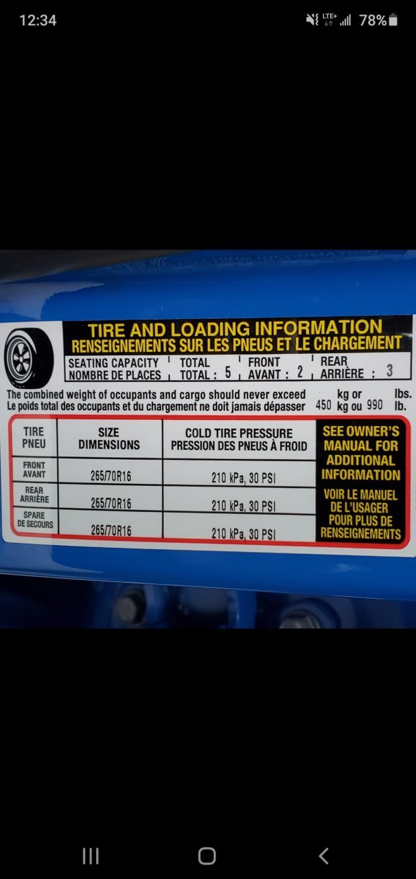

    My tare weight has been 2290 to 2310 kg so I use 2300 kg (5070 lbs) with me (240 lbs) in it plus cargo. Also have RCI rock sliders and other tools/stuff In the storage compartments.
    My payload is 990 lbs and believe it should be closer to 1175 lbs as listed on the US site.

    I think the tire sticker takes into account the weight of trim level options, which is why it is lower than what you see for the general chassis/cab/capacity list.

    That would make sense, except the only option my 2019 SR Access Cab has is the Utility Package, which deletes rear jump seats which should decrease the curb weight giving me more Payload capacity.

    You've got a premium, extra stuff that reduced the payload. Mine is also 990, with an additional yellow sticker further reducing by 60 lbs, presumably from the port added accessories.

    My SR had the typical factory door jam sticker with all the capacities and also a small, round yellow sticker underneath that listed my options (Convenience Pkg) and had a - 8 lbs with a note to subtract if from the door sticker. Wonder if you have something similar that says to + some capacity?
