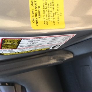

    Hey you’re right, I do have a little yellow sticker, never noticed that before. Sticker says Reduced By”, 0 for me. I guess you don’t get credit for any increases :p

    Cool! That means that the sticker is the MAX payload and it can only be reduced depending on the configuration/options. You have the mac daddy of Tacoma payload ;-)

    -8 lbs thats funny!
    I do not have any extra yellow stickers.Checked all 4 doors.

    Say gulf states get yellow sticker and 0 lbs is common if no additional accessories added.

    Tow package doesn't change payload. Payload is determined by subtracting the trucks actual curb weight from GVWR. The GVWR is the same on all trucks. The only way to get more payload is to have a lighter weight truck. That payload is possible on a stripped down 4X2 SR Access Cab with the 4 cyl engine. The OP has a DC, 4X4.

    You mean to tell me that your max payload is (650kg-420kg) = 230kg = 507 lbs?
    In that case, that one guy with the large girlfriend may have been right all along!

    My GVWR is 2540 kg or 6500 lbs and my tare weight with accessories, cargo and me in the vehicle is 2300 kg or 5070 lbs. Available payload is 240 kg or 529 lbs.
    Also curb weight is 2007 kg or 4425 lbs so I am using 293 kg or 646 lbs of payload.
    My sticker states 450 kg or 990 lbs payload but I believe it to be higher as no yellow weight offset sticker is added.
    5600 - 4425 = 1175 lbs total payload
