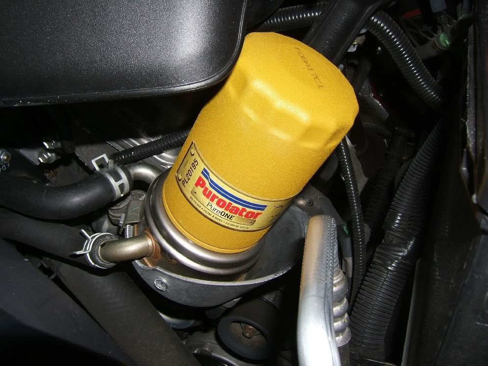

    PureOne's are a bit more restrictive due to their increased filtering capabilities. The increased pressure is minimal and nothing to worry about. Here is an extended filter on the 1GR (not my picture). The owner does state that there are no clearance issues with this filter.

    i use a regular pure one on my 2.7, no issues. it already uses 6 quarts of oil...thats alot for a 4cyl. to start with.

    Thats not where our filters are <--very jealous of that....would be nice though.
    Although we do use the same oil filters. so that part # he has can be used on the 2.7

    Yeah dumb ass mistake on my part. Totally missed the 2.7l comment. Ah well.
