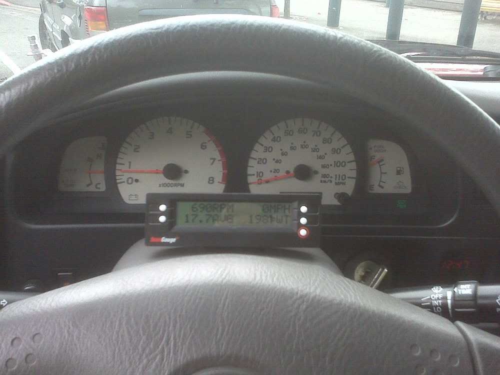

    I have a Superlift Truspeed recalibrator.
    It is adjustable so you can make your speedo & mileage spot on.

    So a scangauge can recalibrate the speedometer, or are you saying to use it to read the actual speed? I want to upgrade at some point and this will be good to know.

    it will NOT recalibrate the speedo. what it will do (when configured properly) is display the adjusted mph and distance (plus a bunch of other cool stuff).

    A scangauge can be dialed in for the percentage of error your larger tires introduce. The ScanGuage can then be set to display RPMs and MPH. And for fillups, calculate your MPG average and fuel remaining in the tank.
    As others have said, your speedo was likely off by as much as 5%. By going from 31's to 32's your likely showing much closer to accurate now.
