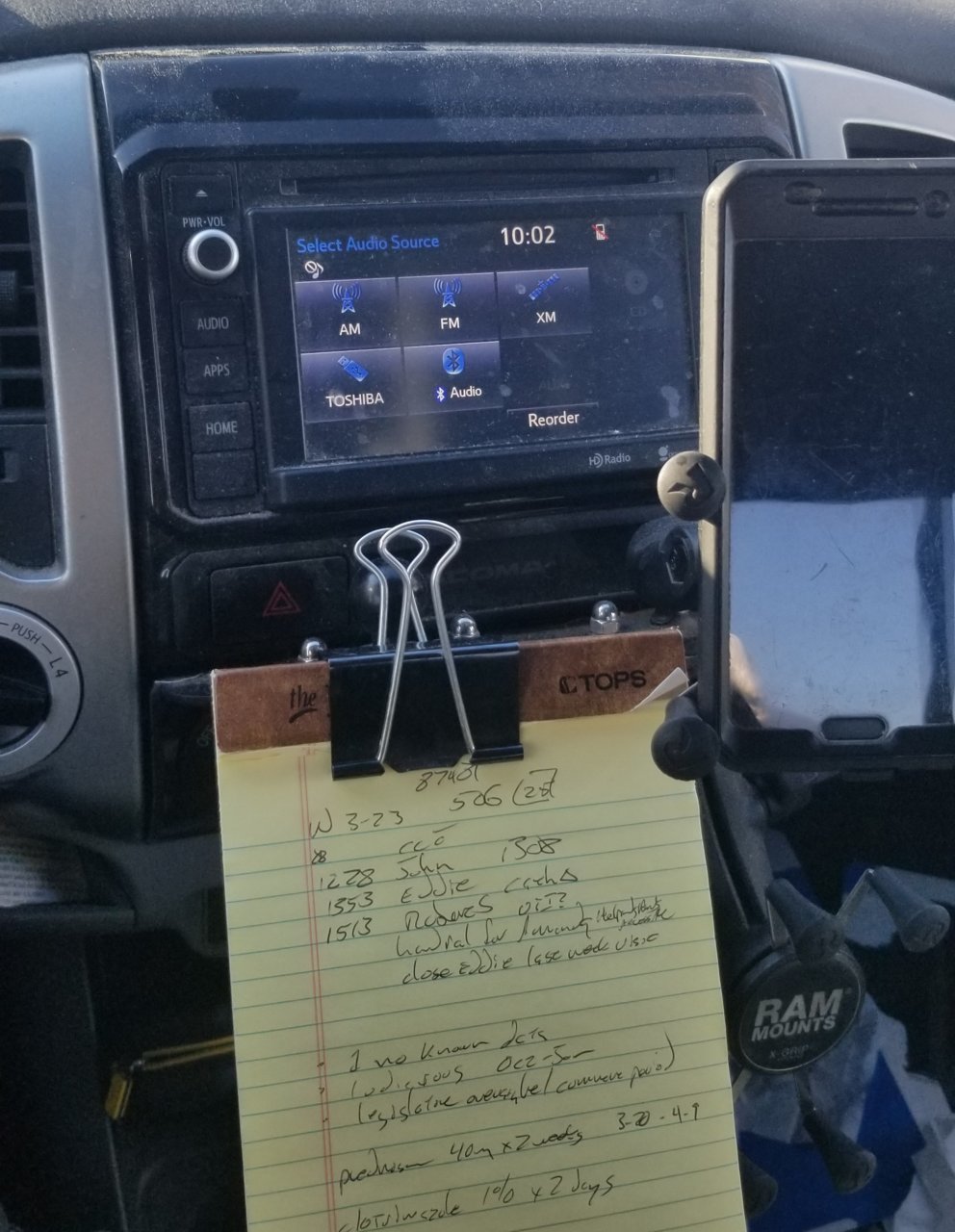

    I am starting to let go of keeping the head unit. Three in a row from all y'all, plus pulling a line level output out of the factory deck is looking problematic, and I am going to need an active crossover for the sub, adjustable on the fly - so I am going to need gain and cut knobs for the sub-system where I can reach them while driving.
    From the head unit I want a visible clock, CD player, FM, and a USB port that will read .wav files from a thumbdrive. .mp3s are right out, I gave up on those before 09-11-01; and L/R line level out.
    I have two challenges that aren't going away.
    1. My truck is my office. The empty RAM mount is for the phone I used to take this picture. The heavy duty RamBall doohickey from birddawgtech is non negotiable, it has to stay or be replaced. One piece of it is epoxied to the bottom of the factory head, so I guess I can go ahead and order a new one of those.

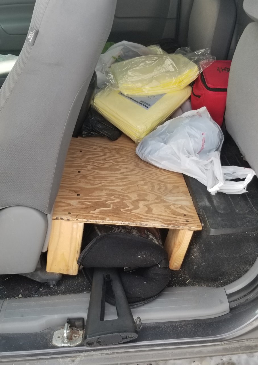

    2. The moose rifle on the floor in front of the jump seats stays. Period.
    If you get to come to Alaska someday, and you see a brown or grey horse that isn't in a pasture - you are looking at a cow moose and you need to stay in your vehicle until you spot the calf or calves. Twins happen. While you are in your vehicle, you are part of the landscape. When you get out of your vehicle you are a predator that managed to stalk however close before mama spotted you. She is going to take you down hard and fast.

    The most dangerous wild animal in Alaska, based on annual humans injured, is the cow moose protecting her calves. You can roll down your vehicle's windows to take pictures, but stay in the vehicle. I like rifle calibers that start with .338 or greater. 45-70 is effective.
    I am going to look for build threads by these two users, but I have an imaging problem, a sound stage problem. I need to keep the plywood shelf, and I would _like_ to keep the jump seats intact and usable. But I want midbass to unload the 6" drivers in the front door. I want an isobaric midbass pair crossed from 400Hz down, and a sealed sub with an active crossover on it so I can adjust the cut frequency (mostly from 60-80Hz-ish) depending on what music I am playing in the back area of my access cab.
    I did page through a few of my favorite female vocalists, Lita Ford, Pat Benatar, nope, the 6" rounds in the factory system aren't handling the band, even with the vocals upstairs.
    One option is to stack the midbass box on top of one of the sub boxes pictured. That would have to be extremely well built dual chamber box.
    The other option is to upgrade the shelf. I do have a pretty good metal fabricator on speed dial, so I could come up a metal frame work that hits some of the seat bolts front and rear, and then lay a plywood shelf in the metal bracket- and then bolt both the midbass and sub boxes to the shelf. That would also have to be extremely well built.
    I am kinda leaning towards the stacked pair and having the plywood shelf remain a drop in for when I need the jump seats. I have used one jump seat one time in the first 90k miles, but I am planning to keep the truck up to the 250k-300k area. No grandchildren on the immediate event horizon, but I expect to keep this truck another 20 years.
