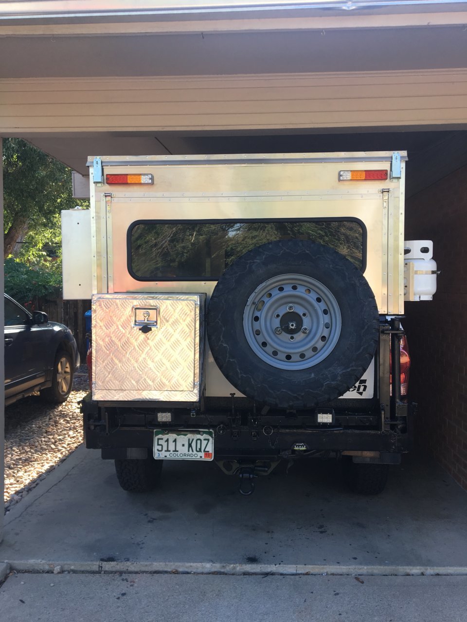

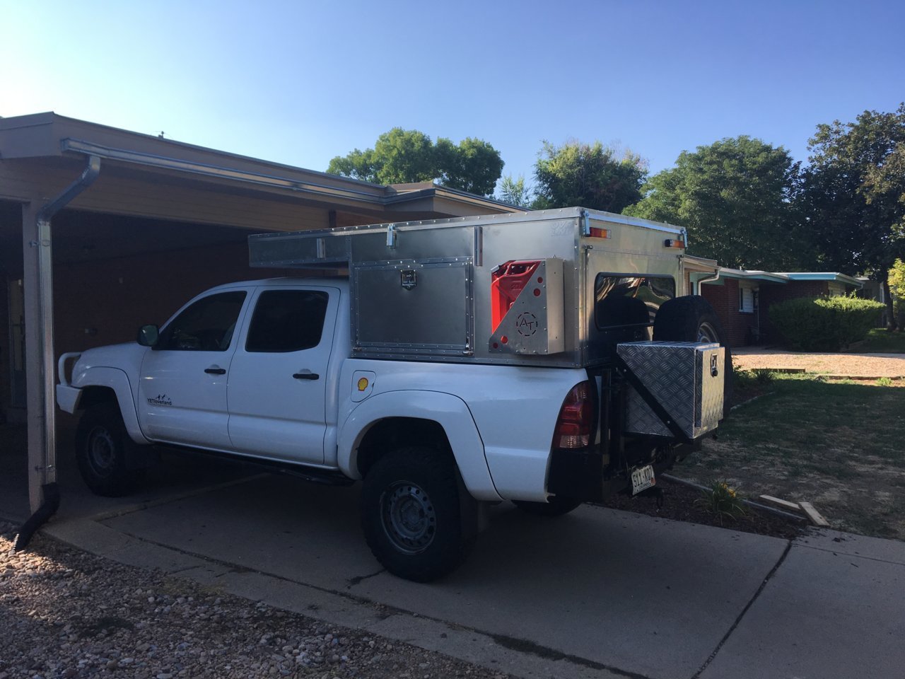

    Jay from Ovrlnd Camper rolled in this morning at 9ish and we started finishing off the small details left
    Mounted up Jerry can, solar access port, and propane tank mount

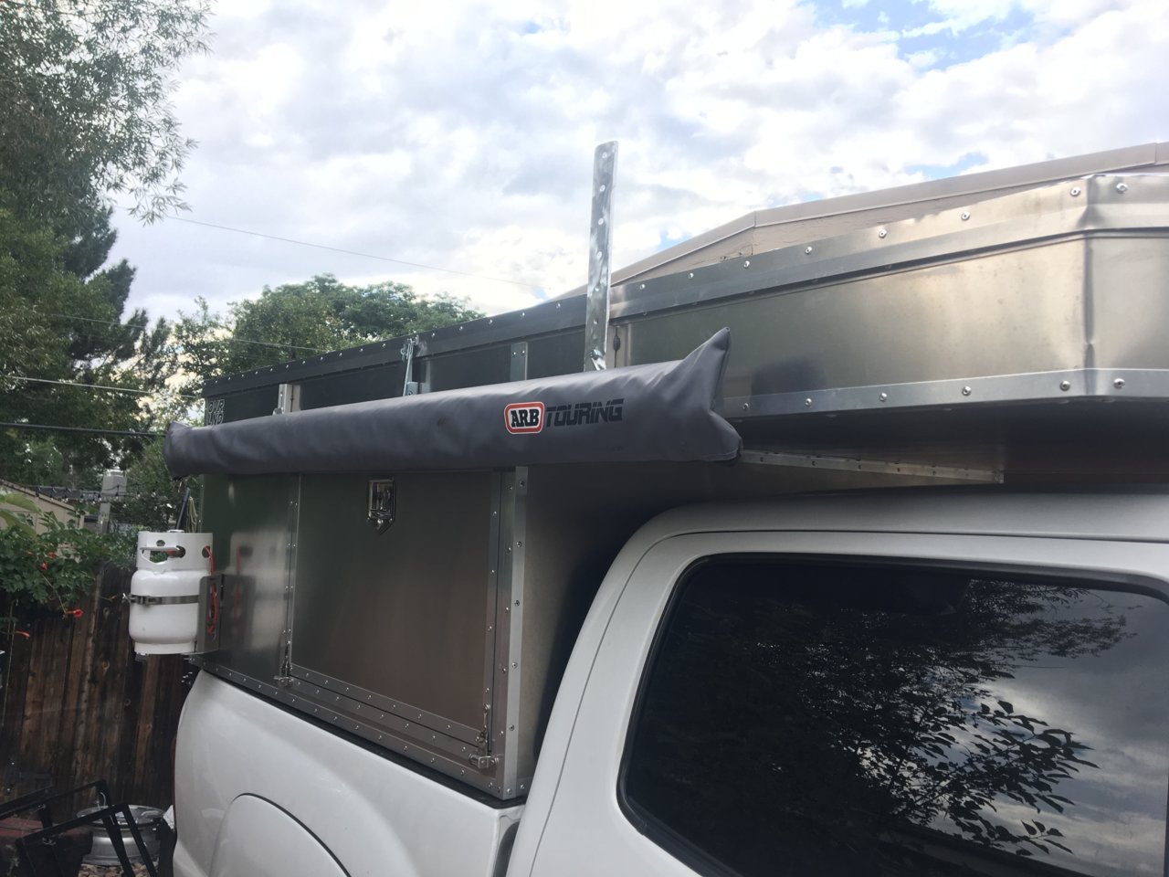

    @crolison Is it possible to mount an awning or do the latches get in the way?
  9. Aug 15, 2018 at 11:28 AM
    #29
    crolison
    crolison [OP] Well-Known Member
    May 17, 2011
    #56801
    3,157
    Ar vah da, CO
    POS

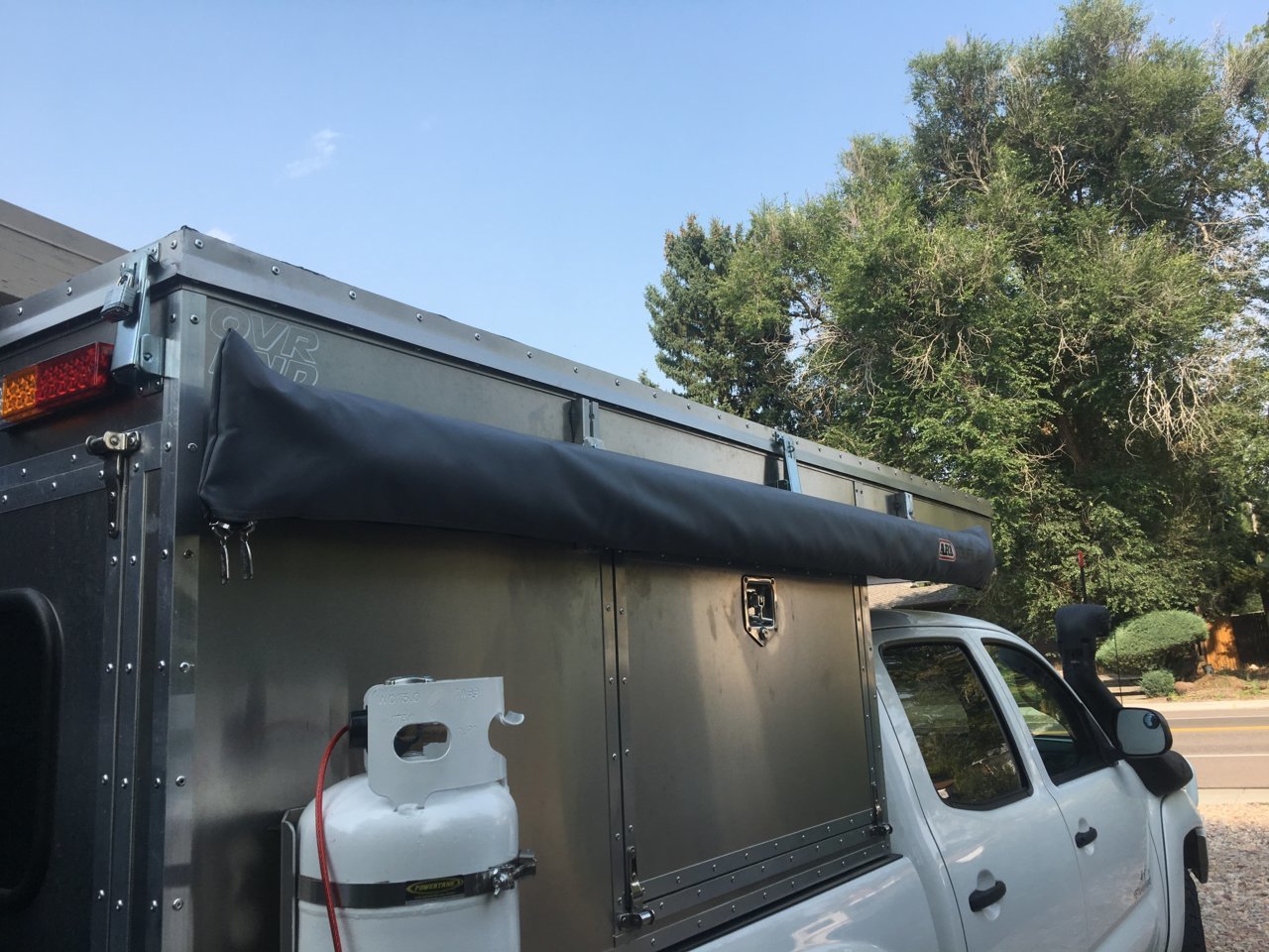

    I have preliminary awning brackets made up, just need to get the time to install the awning and adjust the mounts. There is enough space to add an arb awning between the latch and the side door.
    The extruded aluminum attached the camper is the basis of the mounting system.

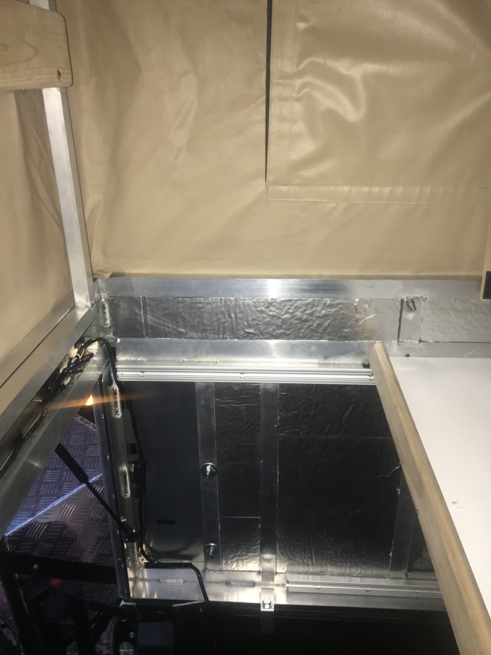

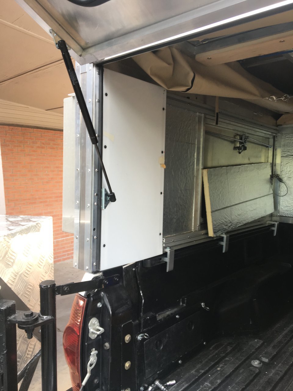

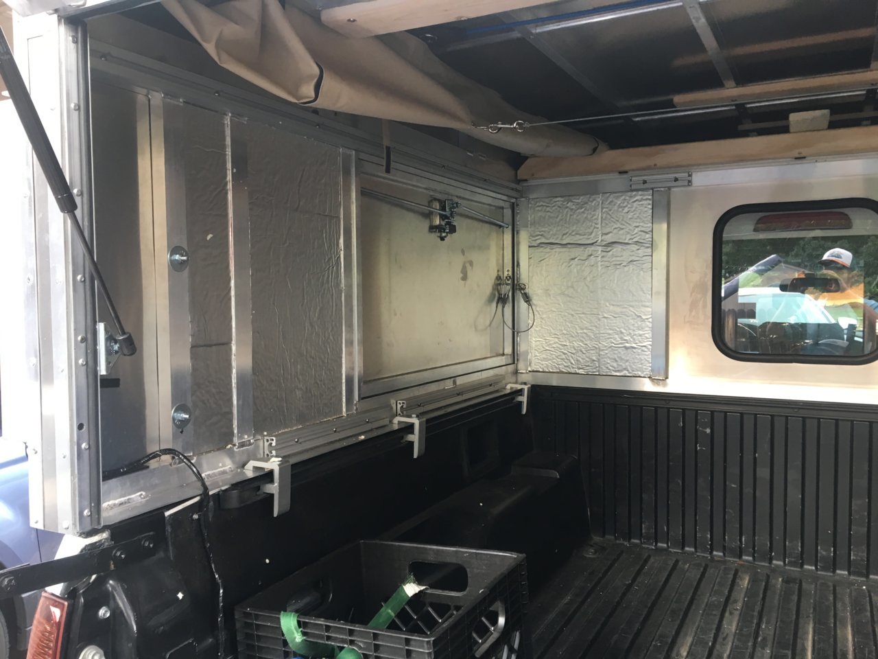

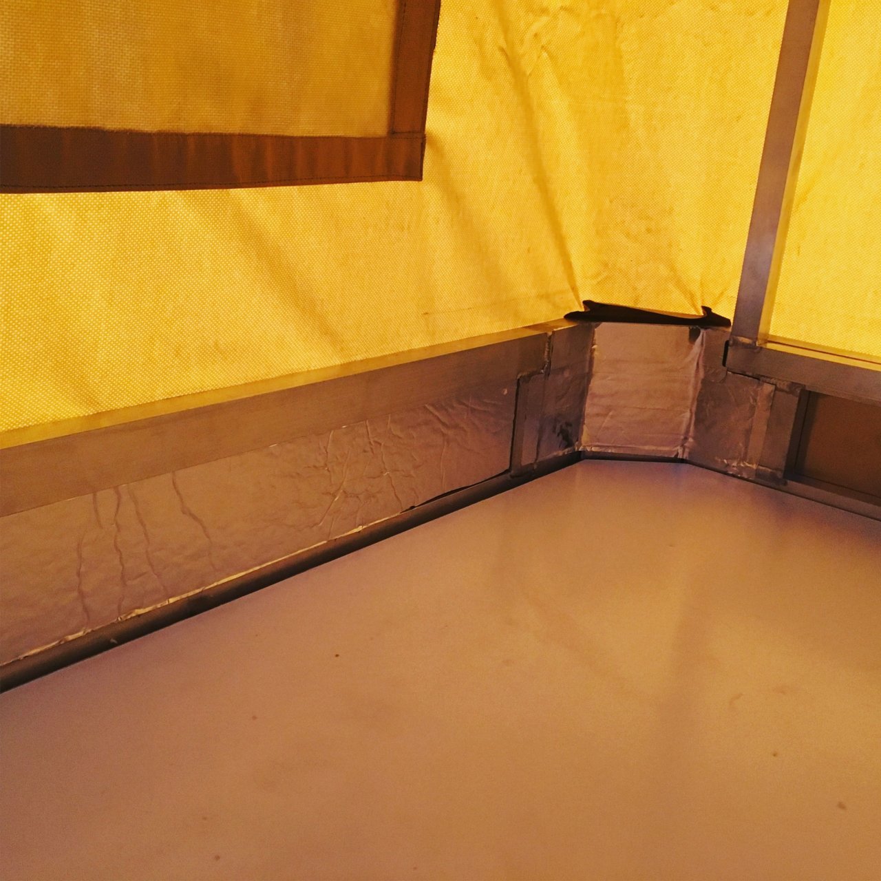

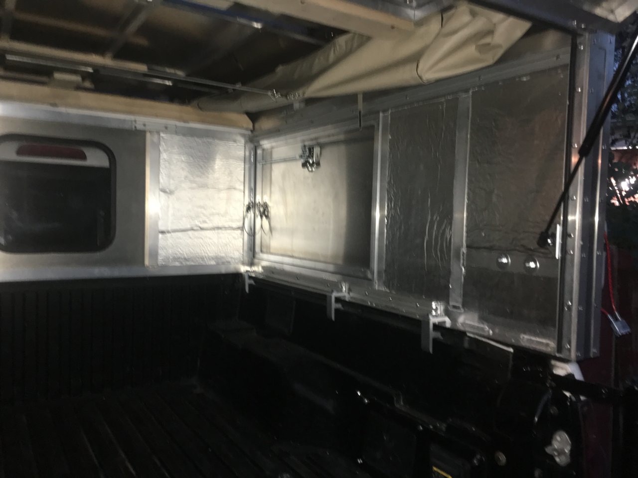

    Working on the insulation today, got mos of the downstairs done, going to focus on the doors/mid section tomorrow.
    Then the fun part is the roof D62498BB-833A-4897-8745-4197ADB04190.jpgD2D27536-F715-42FA-93DA-4090A9FCE9F2.jpg

    Some more insulation from yesterday

    Working on some arb awning mounts for the camper

    Finished up the prototype awning mounts. Going to redesign and have them cut out nicely for a final version

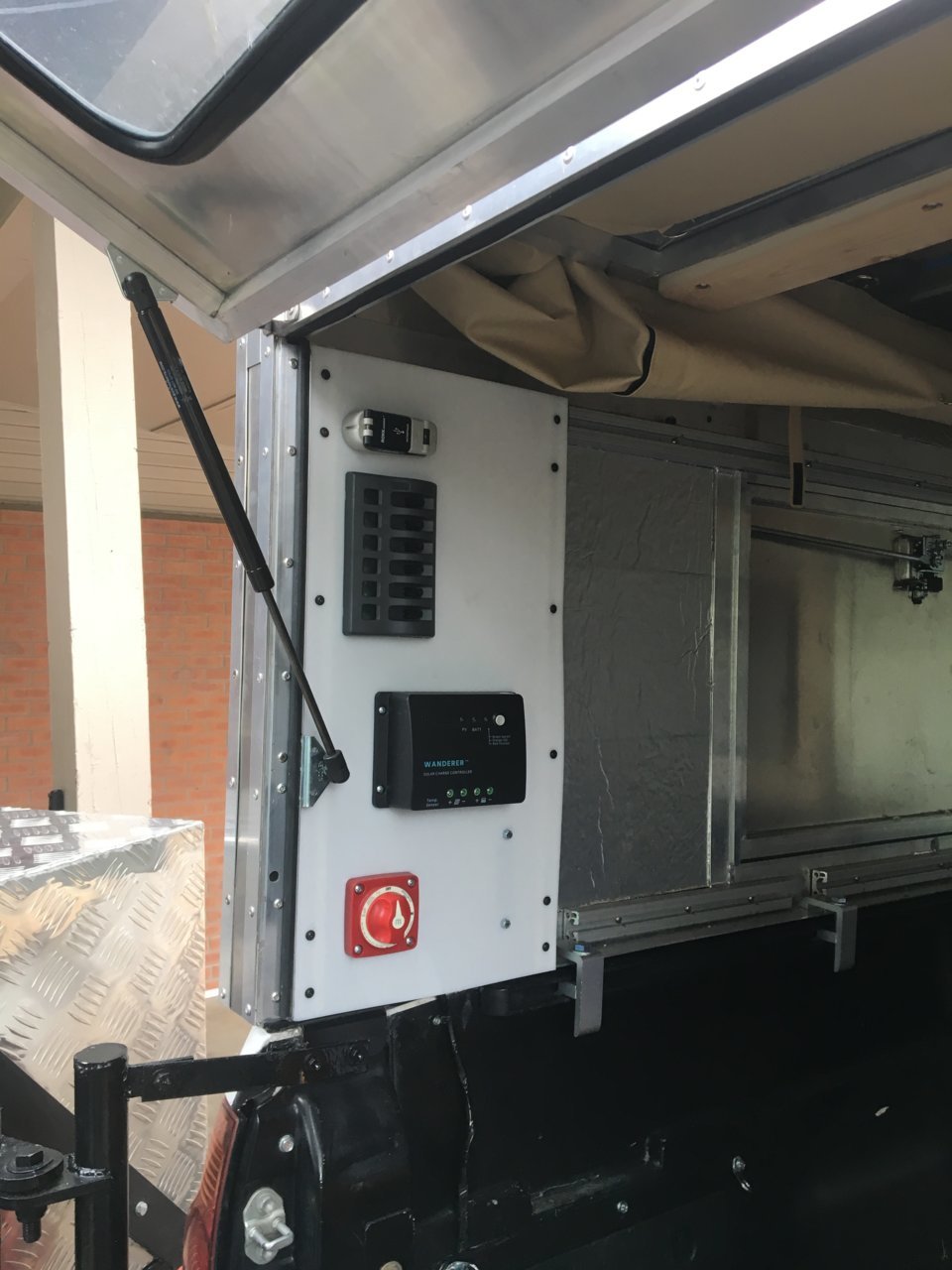

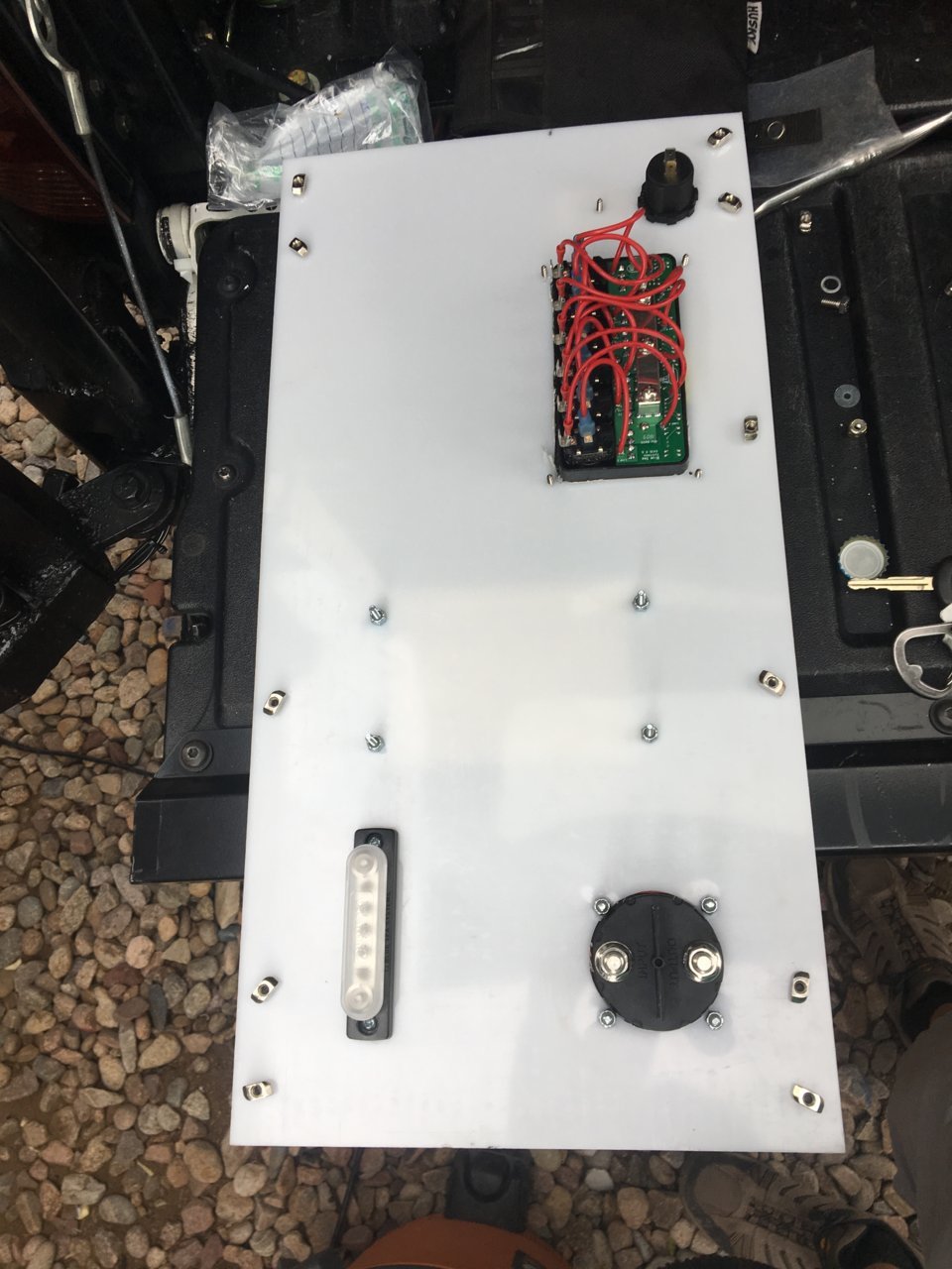

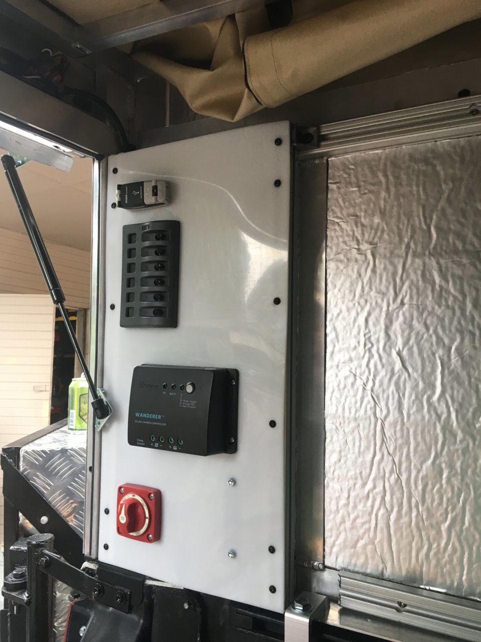

    Worked a little on the electrical system
    Blue sea battery disconnect, negative bus, switch panel, renogy wanderer solar controller, and scanstrut USB port.
    Just have to wire it all
