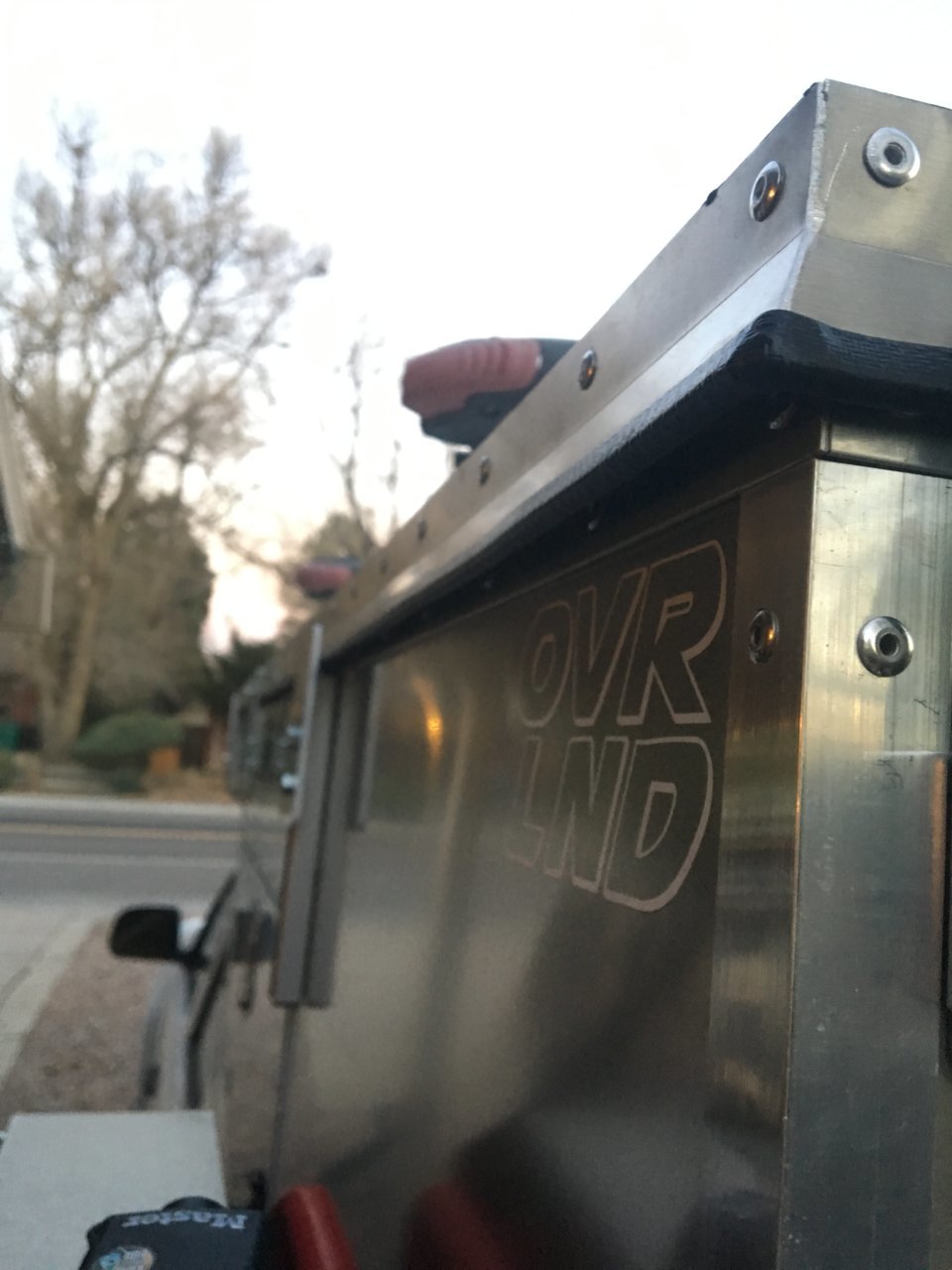

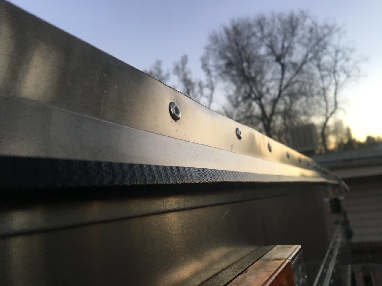

    Super small update, added some trim to the roof, hand for tired of holding up the edge while messing with random stuff / testing out closing the roof from the outside

    When riveting the panels or sheets of aluminum, is there caulking in between sheets to help with water proofing?

    There is mastic tape for a lot of the major components where they interact.
    Also the rivets are “waterproof” ie sealed ended rivets. I have had no leaks except for my bed of the truck (not campers fault)

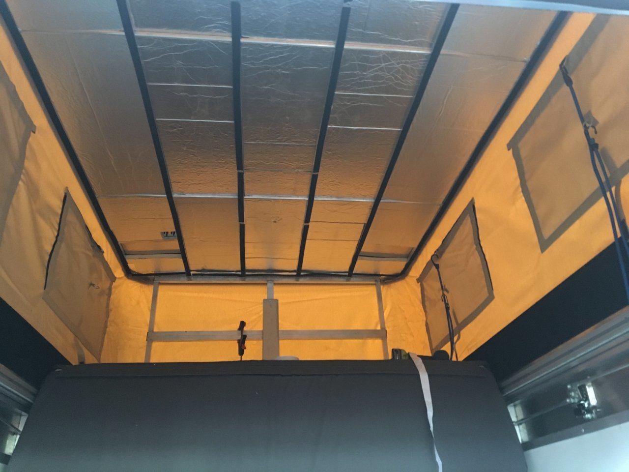

    Pretty cool set-up. The OVRLND website lists a base weight of 300-350 lbs. I'm guessing this build gets close to 500-600 lbs which is respectable and very manageable for a mini-truck. Are you going to finish the walls with anything over the insulation?

    Currently I have abs / velcro fabric on all of the walls, I will be adding a “headliner” to it in the next couple of days (depending on work). I have a couple of fabrics picked out, but looks like loose loop felt will probably be the option I go with.
    And once the interior storage / kitchen / fridge are in it should be about 5-600 extra weight.
    Also semi soon I will be starting on the interior and roof rack storage for wood. Waiting on materials and a coworker with some fancy tools to let me work while he wrenches on his samurai

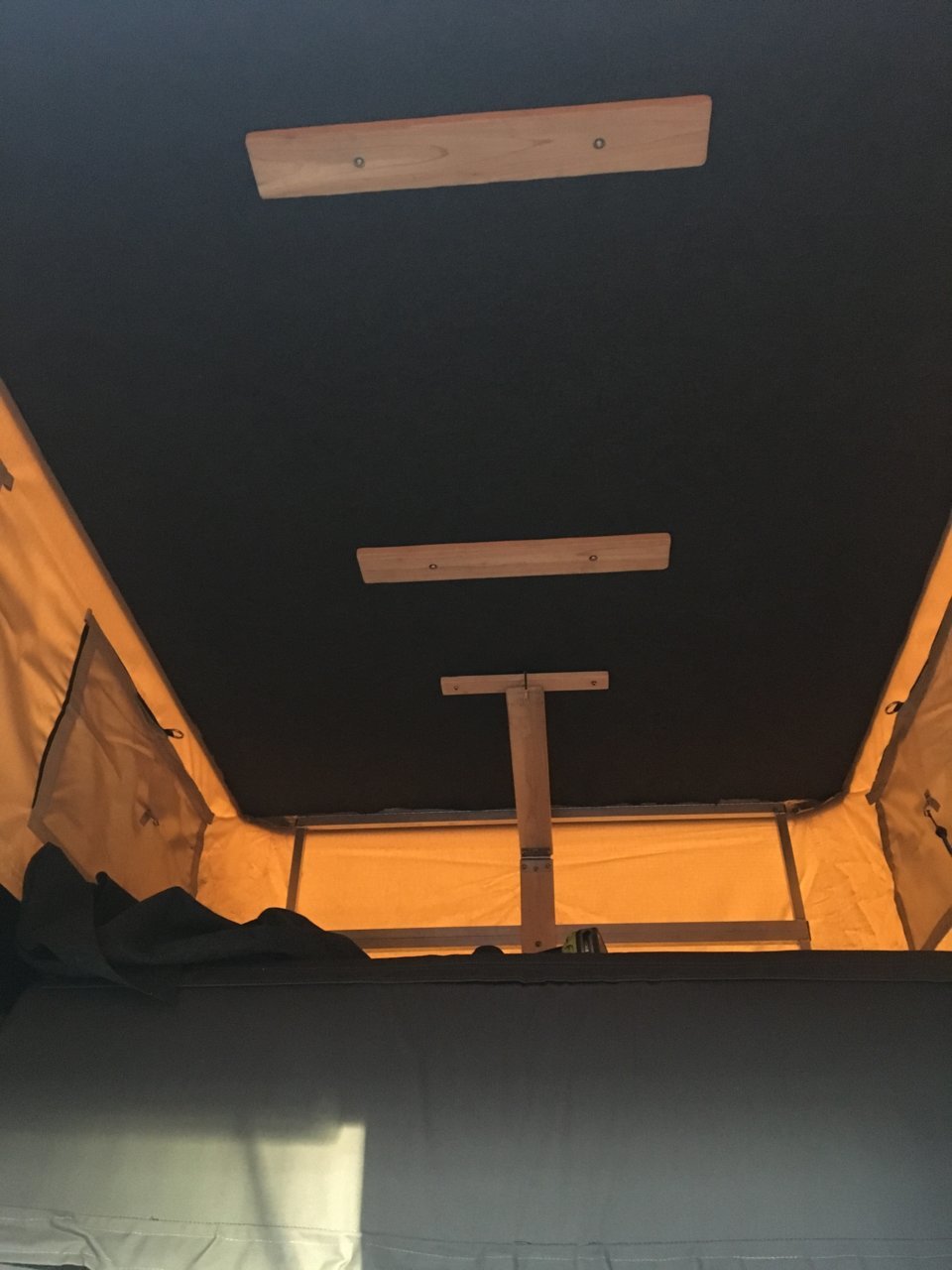

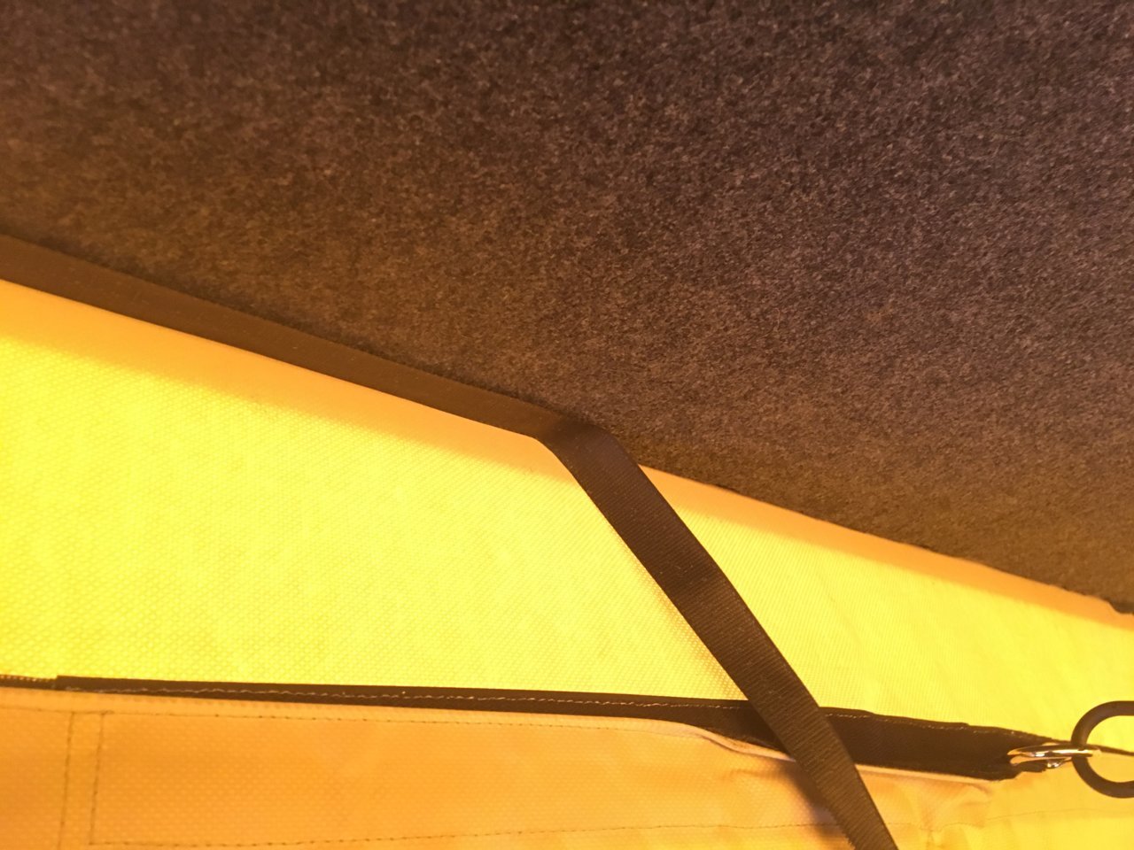

    Spent some time today working on a headliner. Think it turned out well, not done yet. Learned a lot

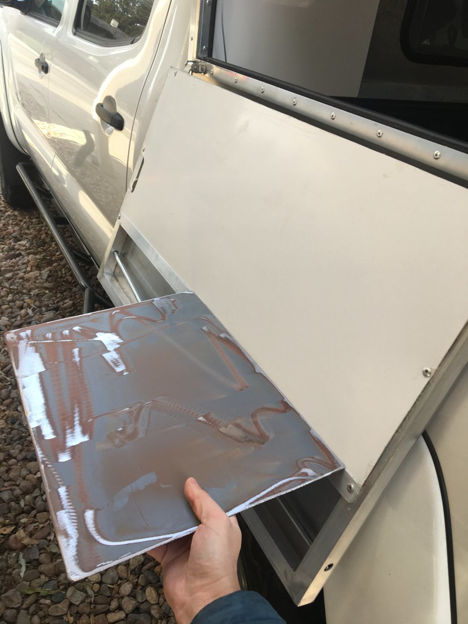

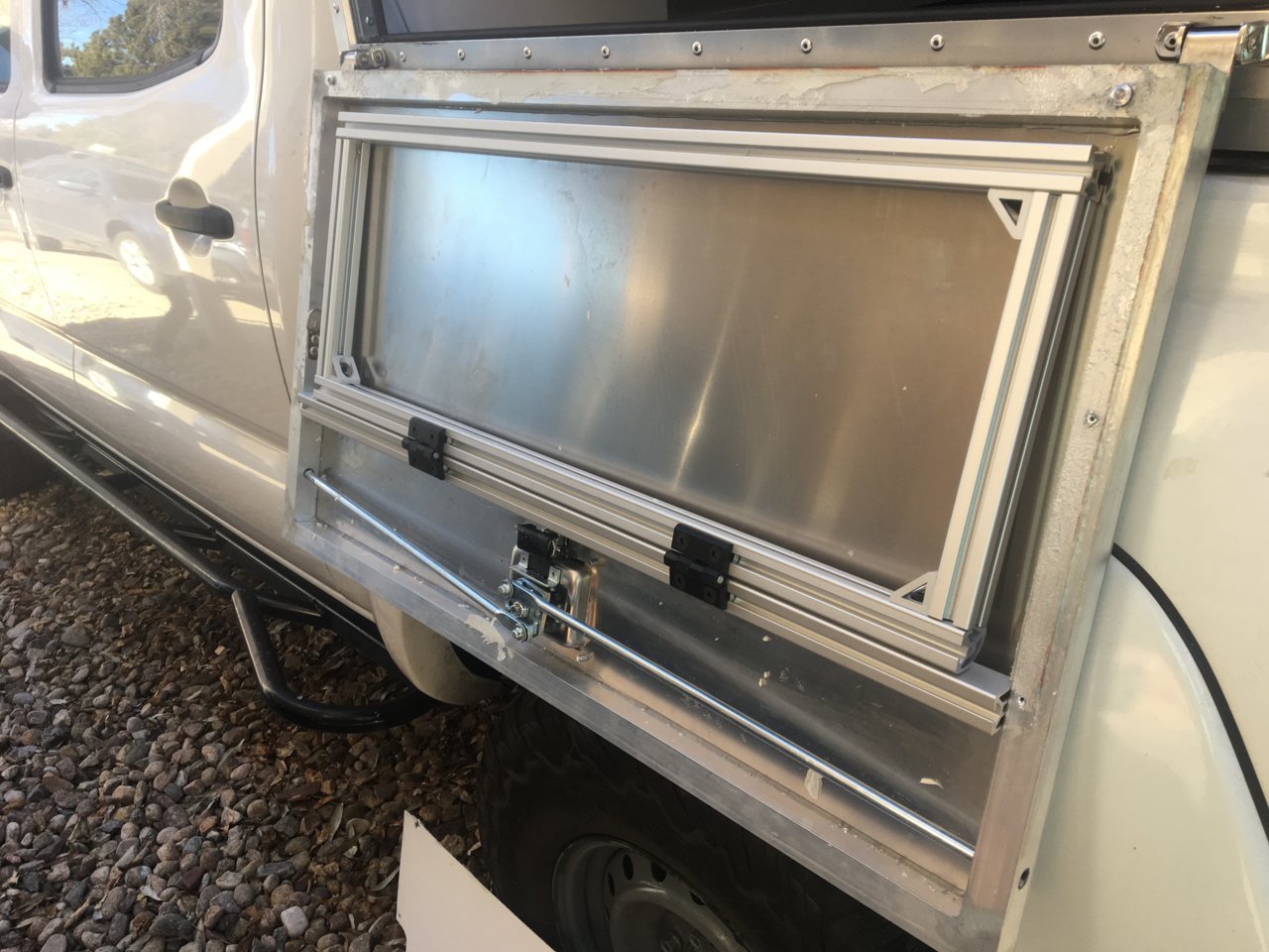

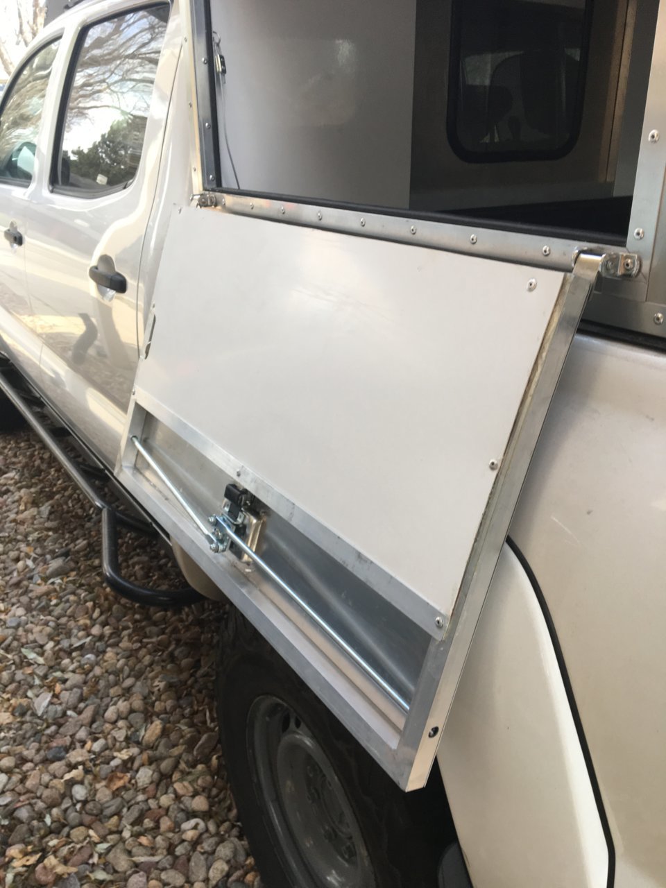

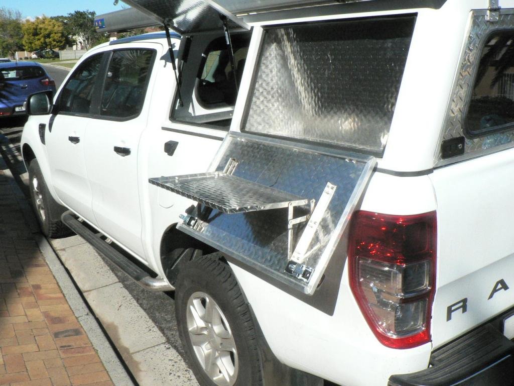

    Messing around this weekend, decided to reimagine the side doors. They were a little tall for the wife to use, so figured I could do something to lower them.
    Found some inspiration from Australia / South Africa
    My door down
    Steel as an example

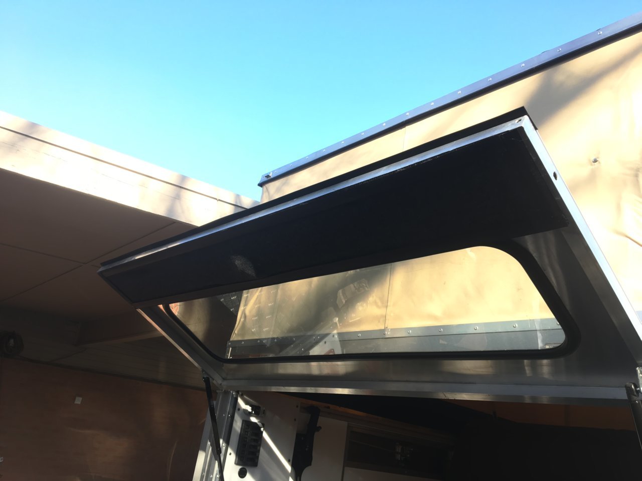

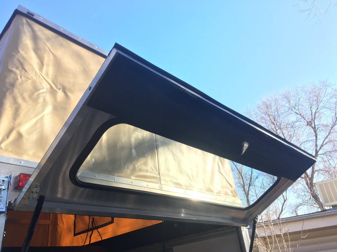

    Added some “trim” to clean up the Ceiling and covered up the back door mechanism todayB7A386FE-FB8D-4D7F-92F1-F184A26FBE52.jpg1D996704-AC8D-4B43-A7E8-89F01252DE73.jpgACBD9D67-9C62-4BC5-B318-9377EDD3633D.jpgC42F7DAA-26C3-436A-89CC-6993DB73580A.jpg

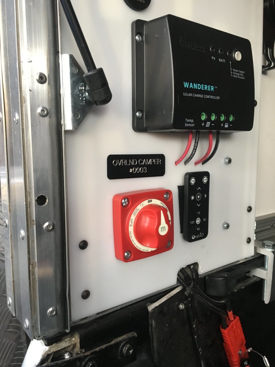

    Let the interior begin

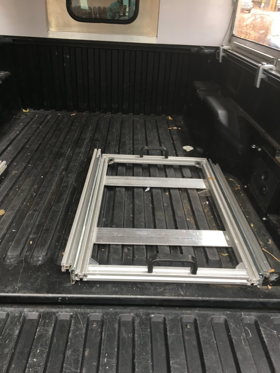

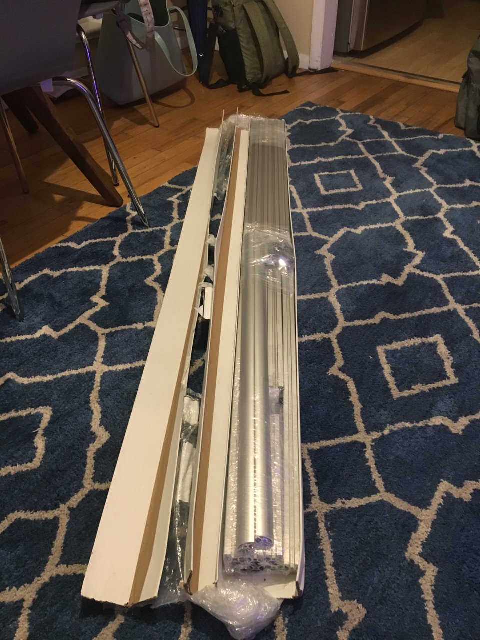

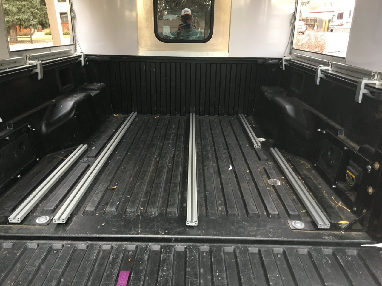

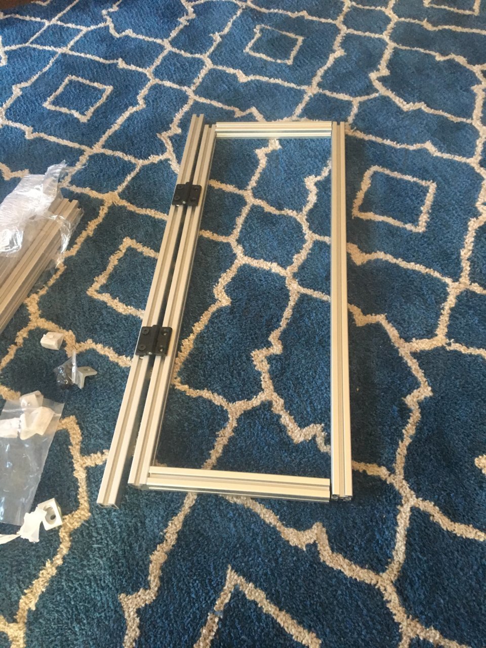

    Just working on the interior layout. Should come together pretty nicely/quickly with the 80/20 construction.
