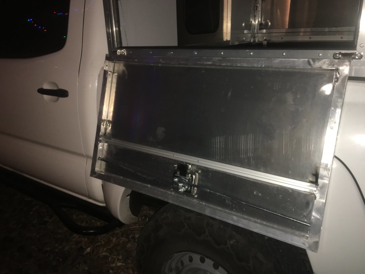

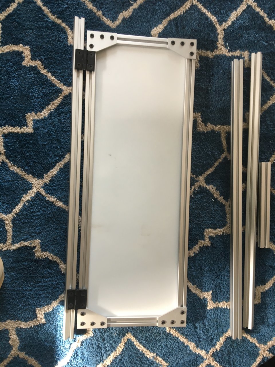

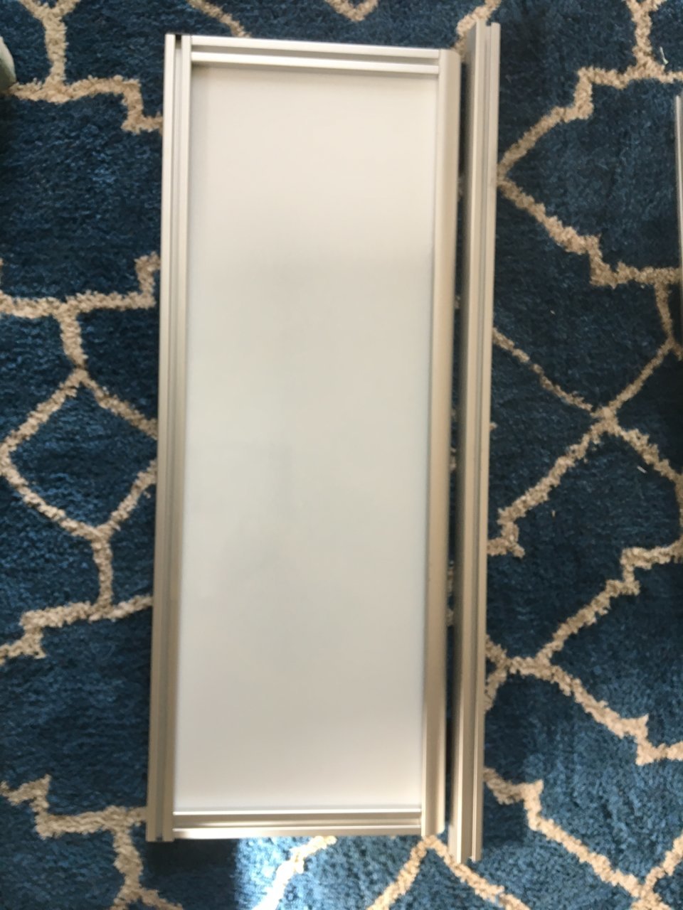

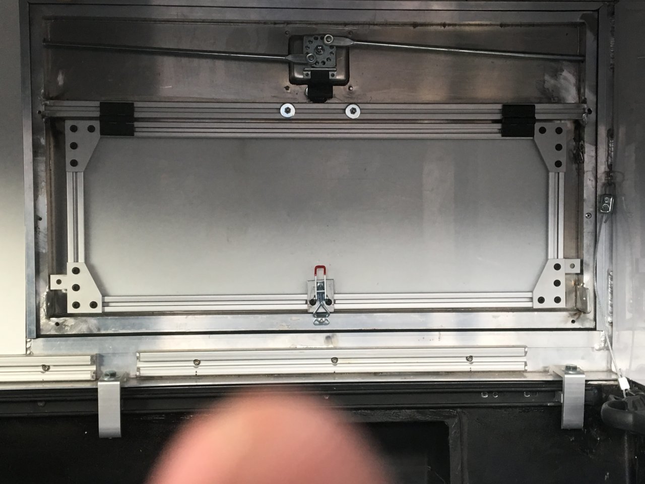

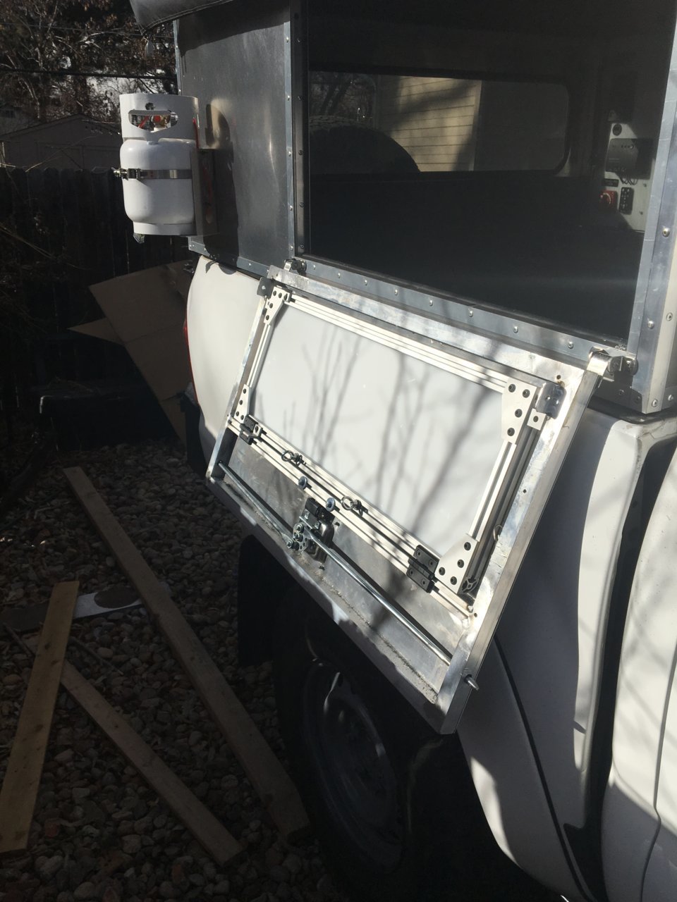

    Working on the side doors today, and probably the bed 8020 portions
    D2F32998-29B5-44B4-8036-7BE649B679A5.jpg 333E7347-B132-4F60-AC5D-B54DD10670B0.jpg

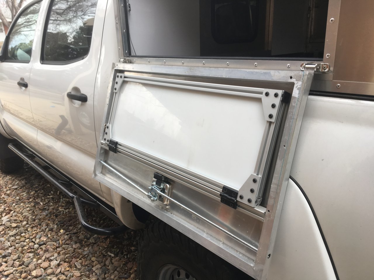

    Just gotta have the main bar welded in and these should be pretty done!
    BCBF212D-22B1-4336-A391-52986304C2D5.jpg DD8BA188-B722-4950-8DC4-565D509A0400.jpg

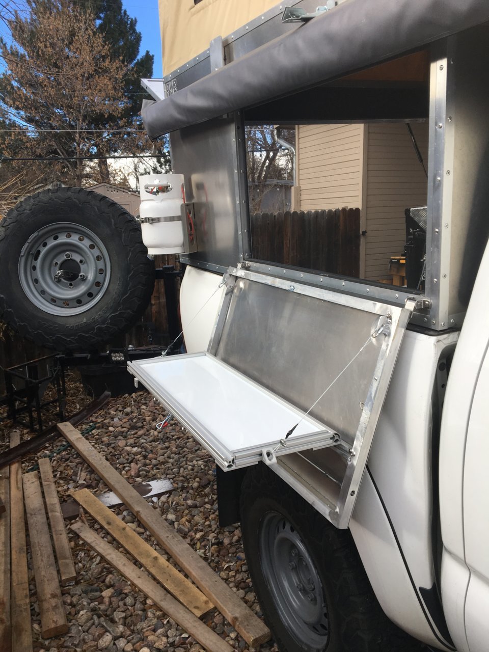

    Well done! What material did you use for the table surface?

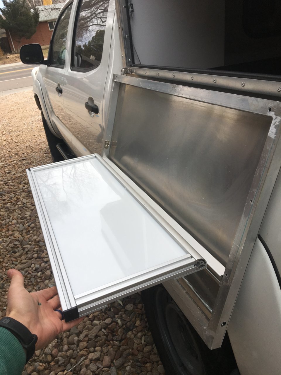

  6. Dec 12, 2018 at 2:13 PM
    #106
    crolison
    crolison [OP] Well-Known Member
    May 17, 2011
    #56801
    3,157
    Ar vah da, CO
    POS
    1/4” hdpe I had laying around. Probably make a third table for somewhere with what I have left

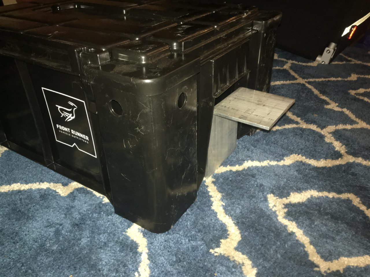

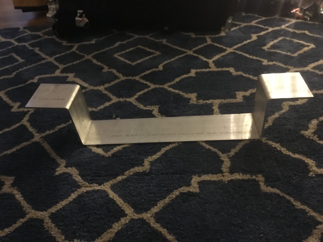

    Went to a coworker who has a press and worked on some brackets / front runner outfitter box holder

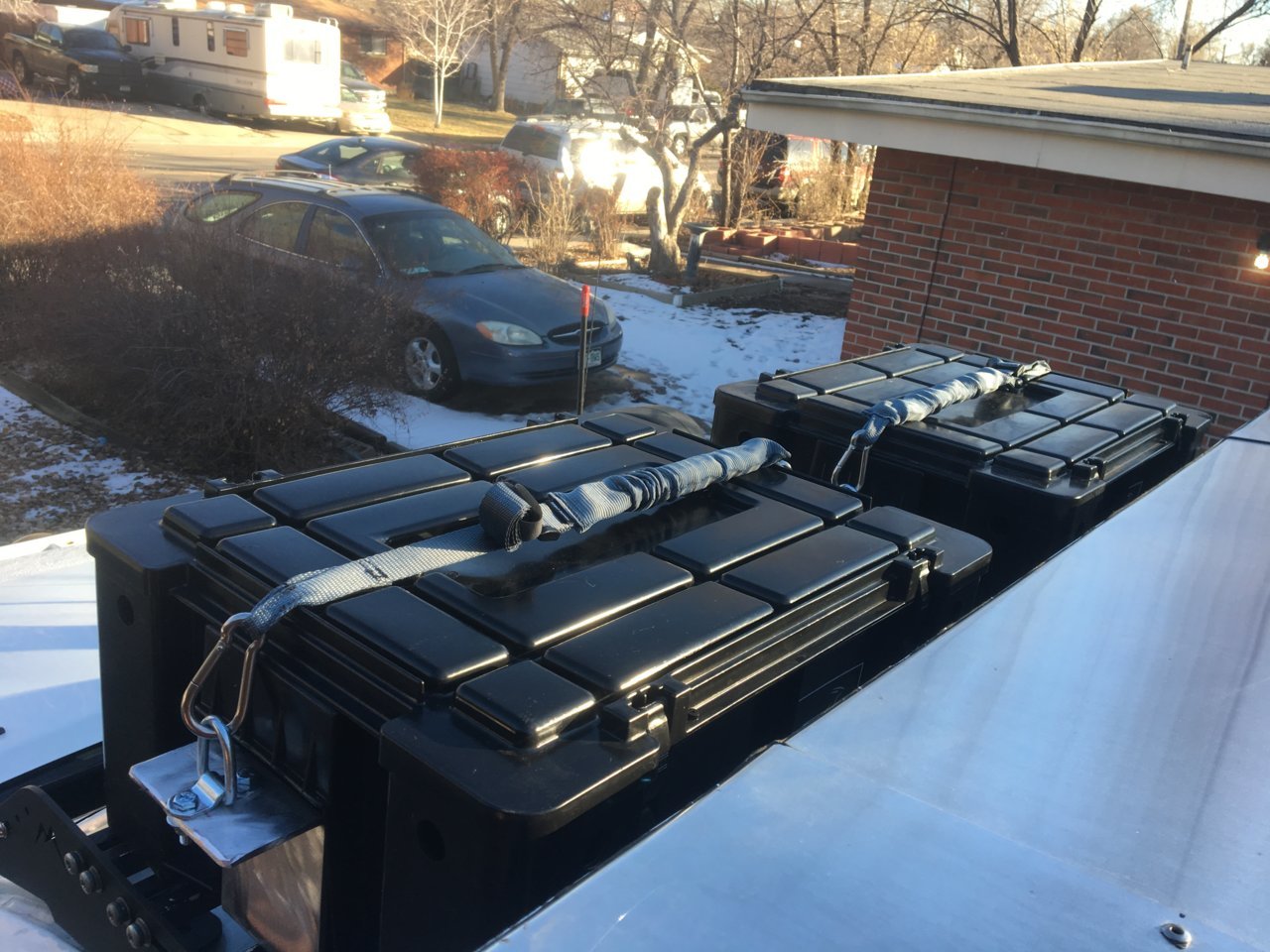

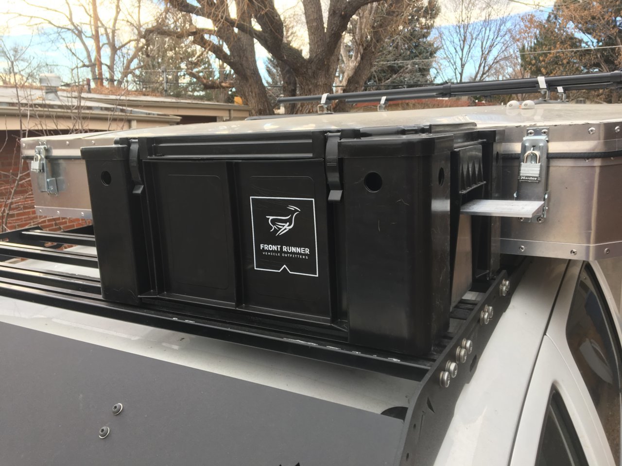

    Some more photos of how the front runner box will mount.

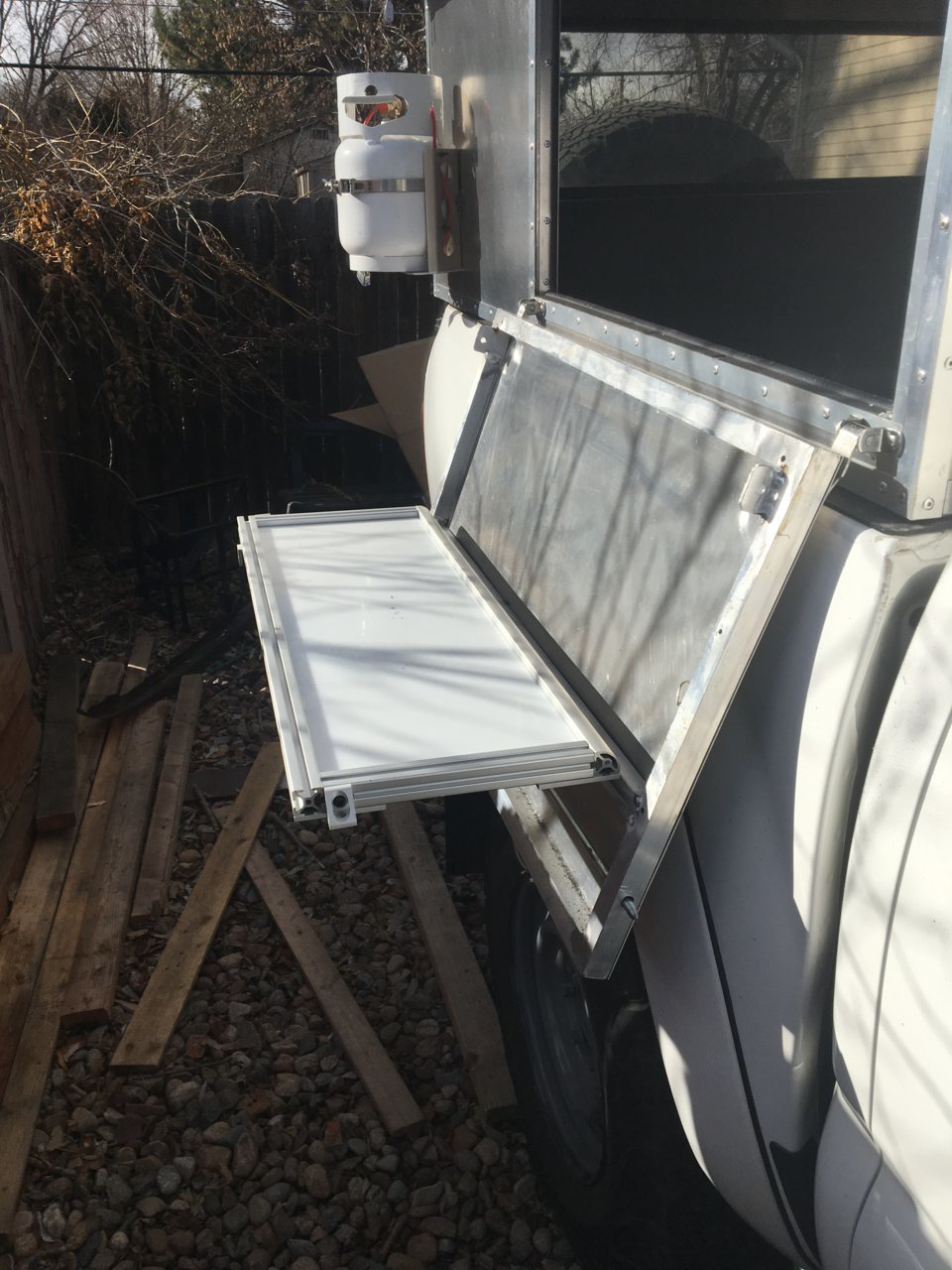

    I also got th supports and basis for the fold down tables welded up last night

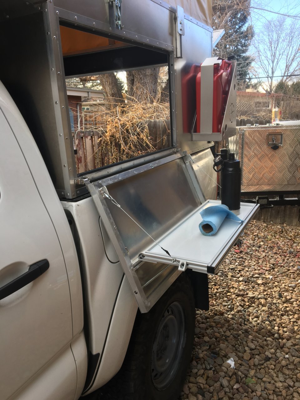

    More work on the side tables today. Almost done with them. Added rubber bumpers for the fender, mounted, them up, added patches, just need cables to call it done.
    8448AEC0-8E57-47A7-BC9B-779F6E6BB78D.jpg AADB6A5D-BEA7-4C02-ACD9-376ACDD8B29C.jpg E657C26D-B570-481E-88FA-12D1F3BB80D2.jpg C362783F-F328-46C3-A05B-FF8A429977AB.jpg

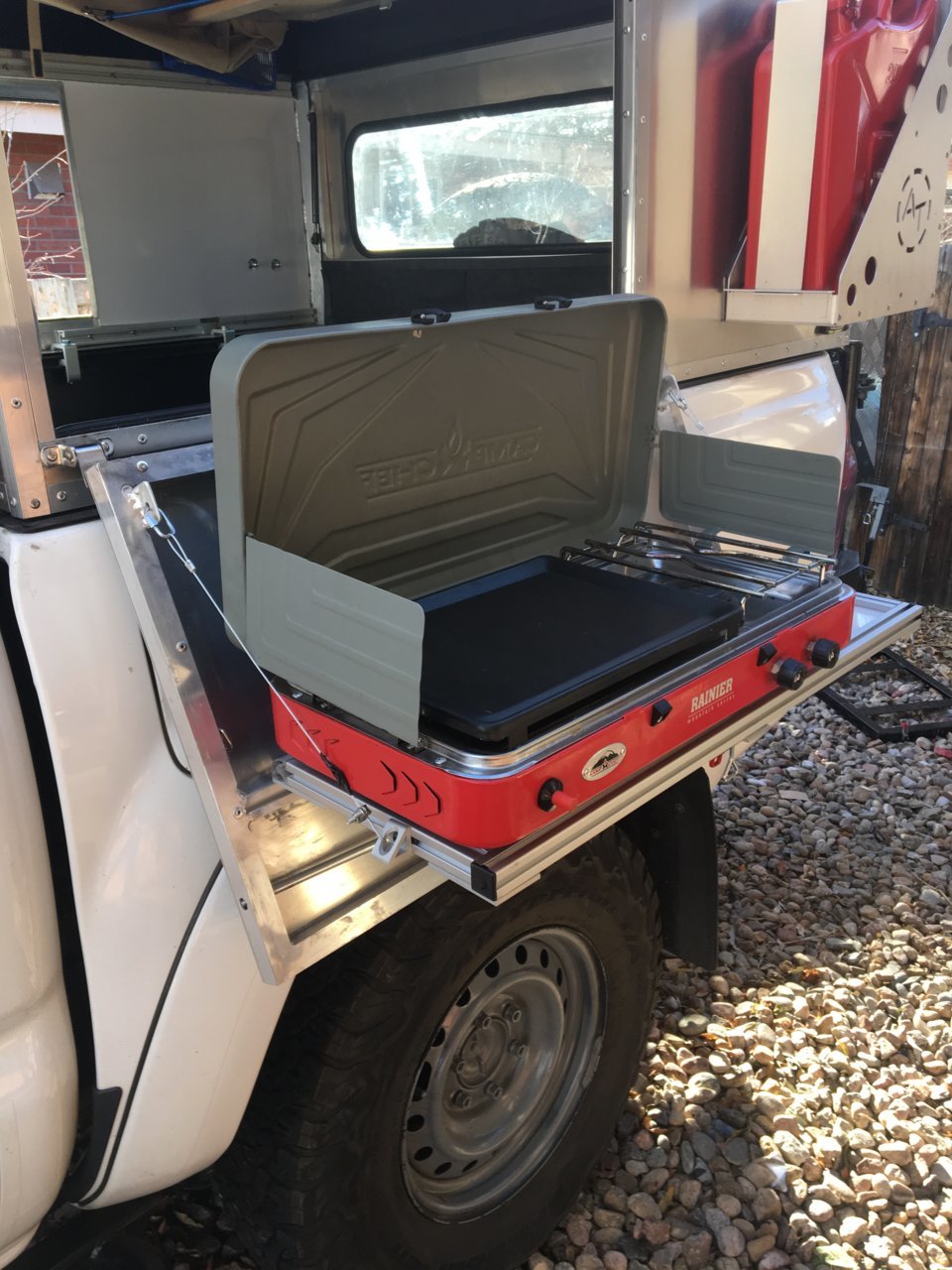

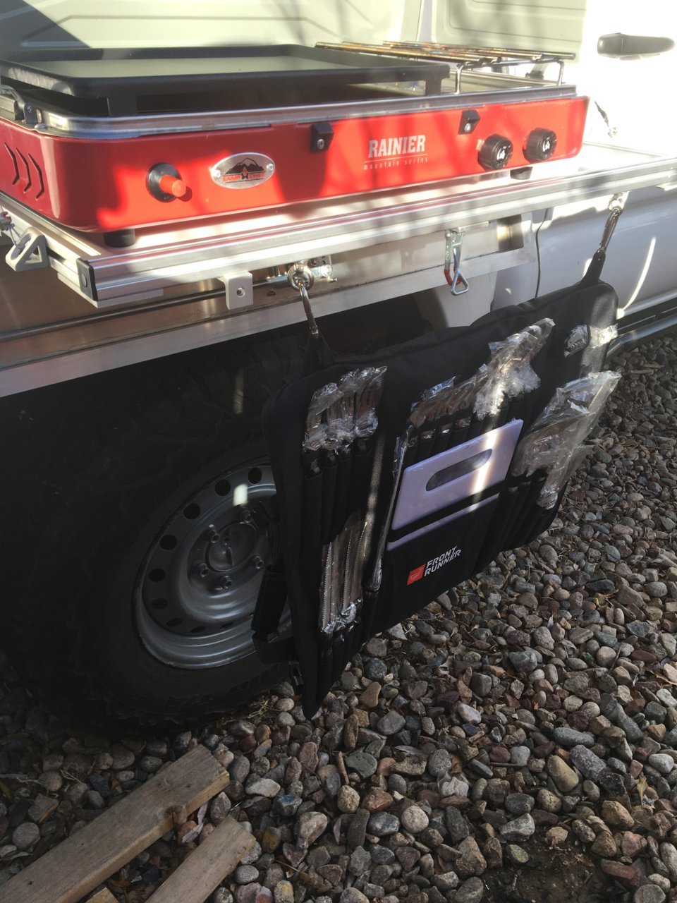

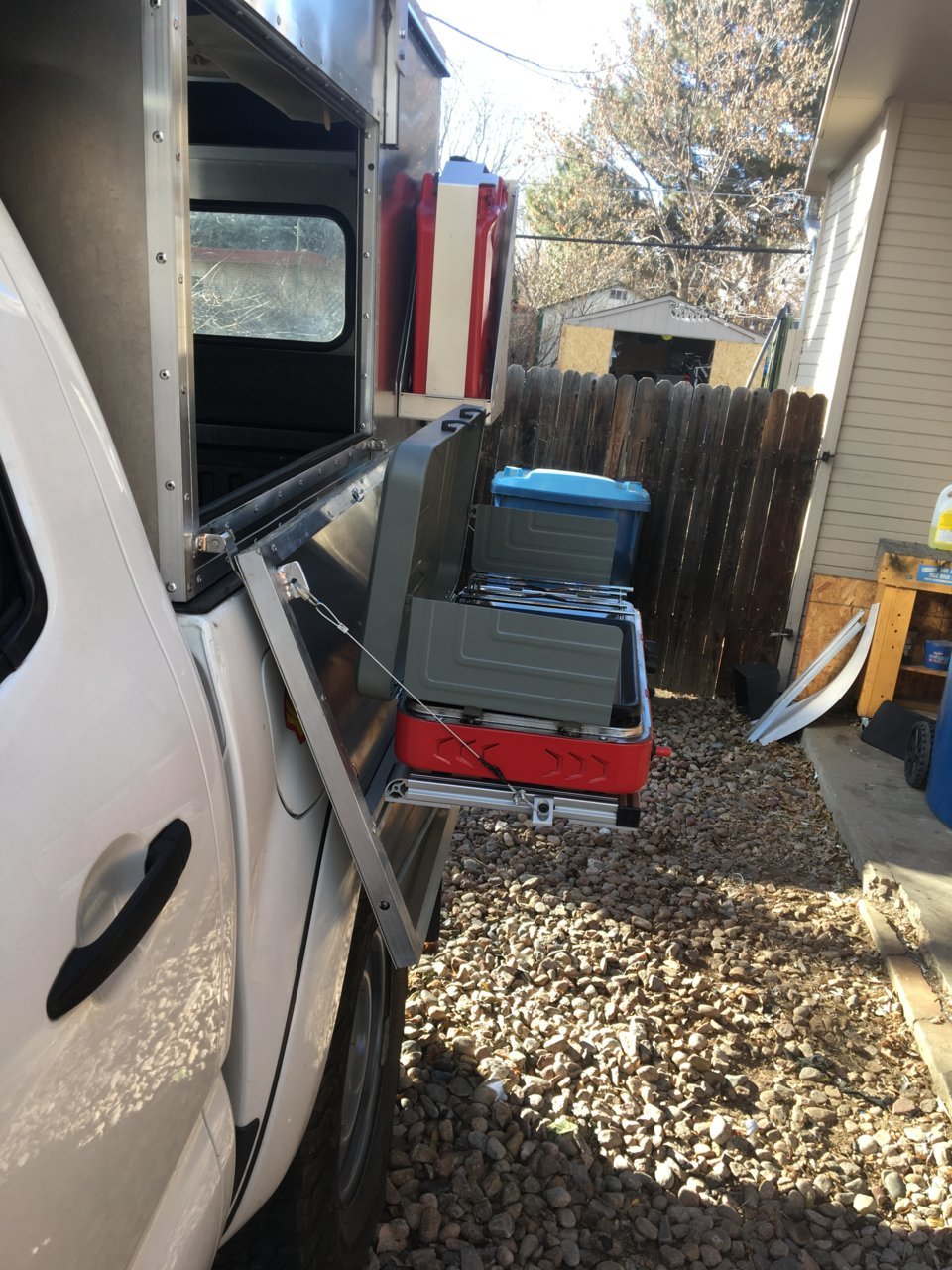

    Finished the tables up, tried out the stove fitment and the new front runner cutlery. Think it fits quite well

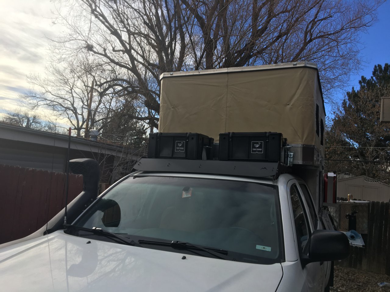

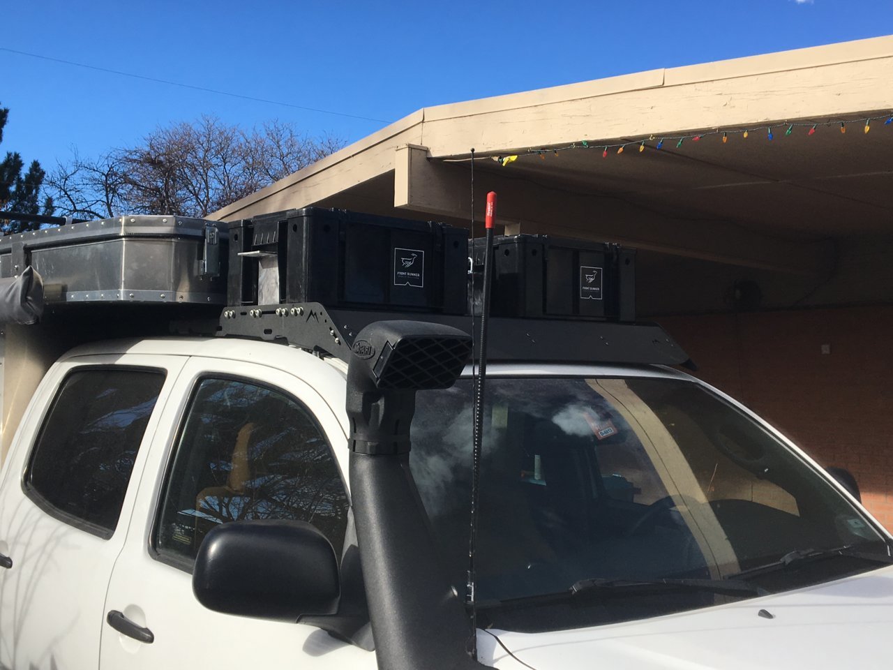

    Also worked on the front runner wolf pack fitment 13E40C5E-ED49-4BF7-90B4-0BD9E74A67DA.jpg16F6C02D-648E-4F09-B093-311F03ADA2CC.jpg

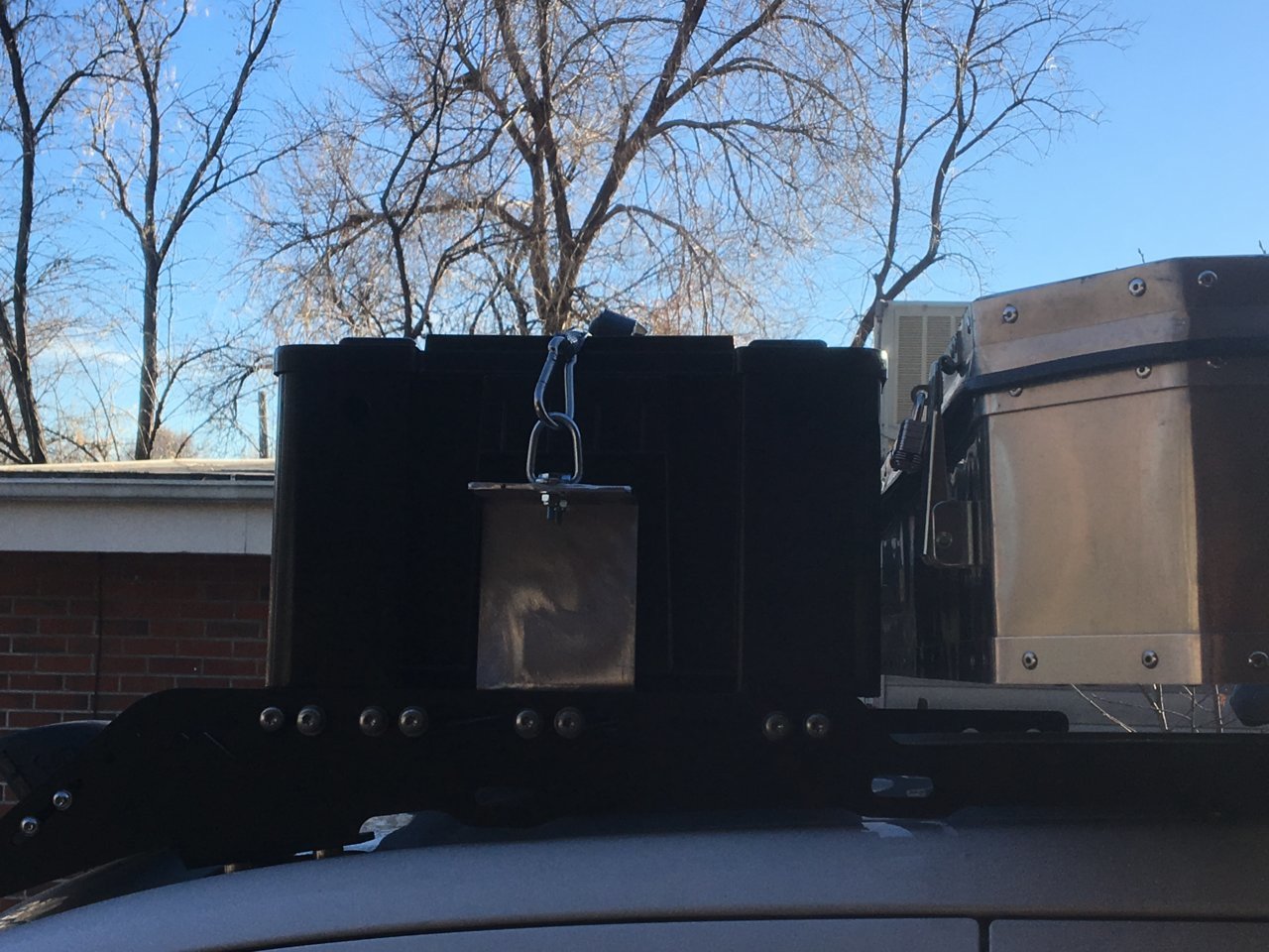

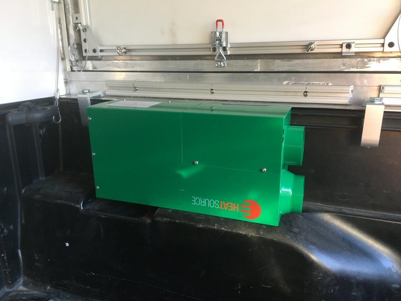

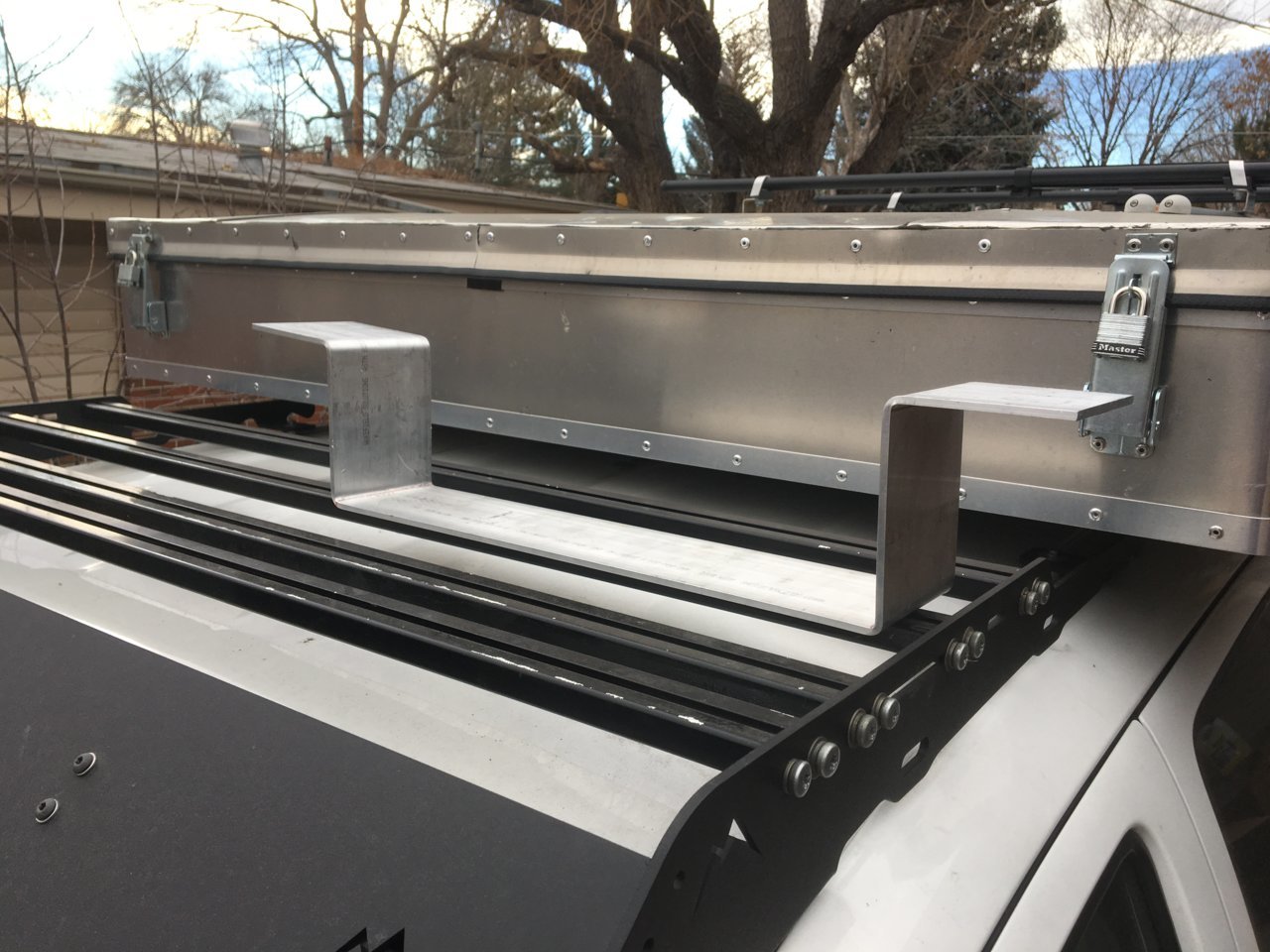

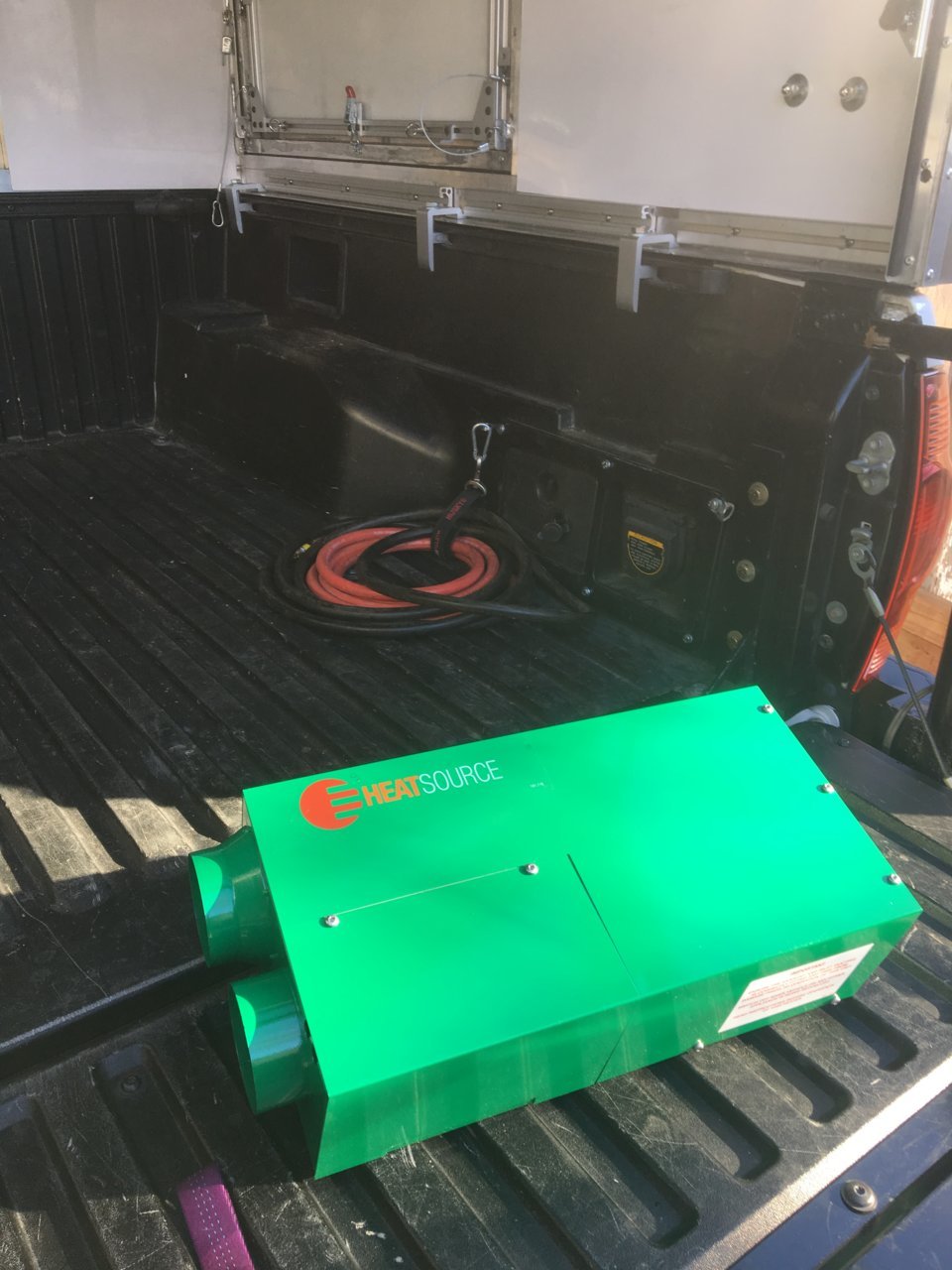

    The new propex hs2800 arrived in the mail today, time to start fabbing our some mounts and cover panel for the intake and exhaust. Also finished up the wolf pack mounts for the roof rack.
    1F59493E-9011-4144-B58B-8EF64CFEBEFF.jpg 5AB629E6-E6C2-45FD-A351-A744BBBA78BE.jpg 527D2CDD-54DD-4017-B590-B472101516D9.jpg 4C1D88E9-B148-44A4-B67A-8DAEA8DEA3D6.jpg DBCCB02B-74B6-4687-8D8E-94B5820AF3B2.jpg

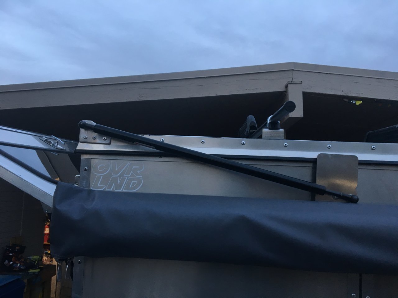

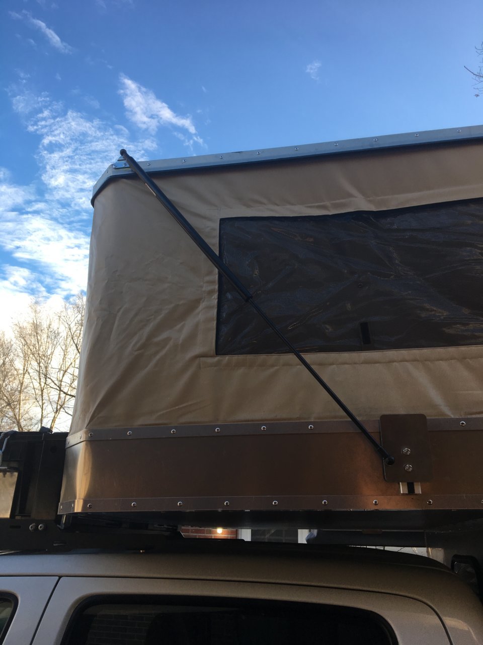

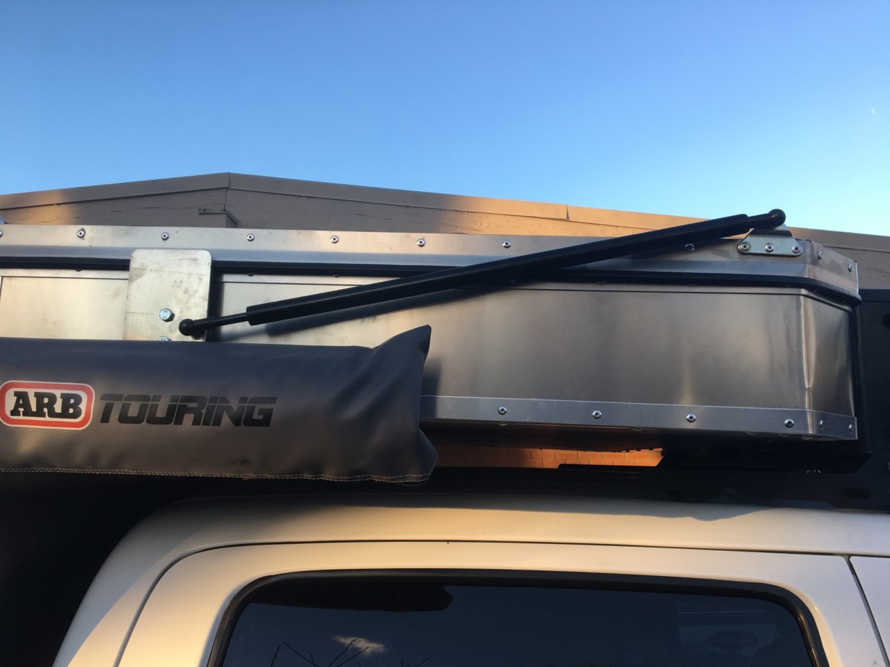

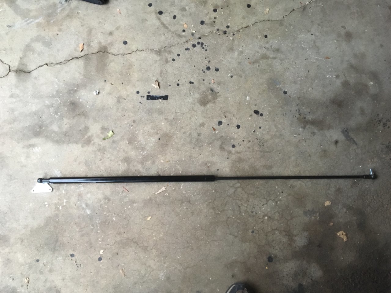

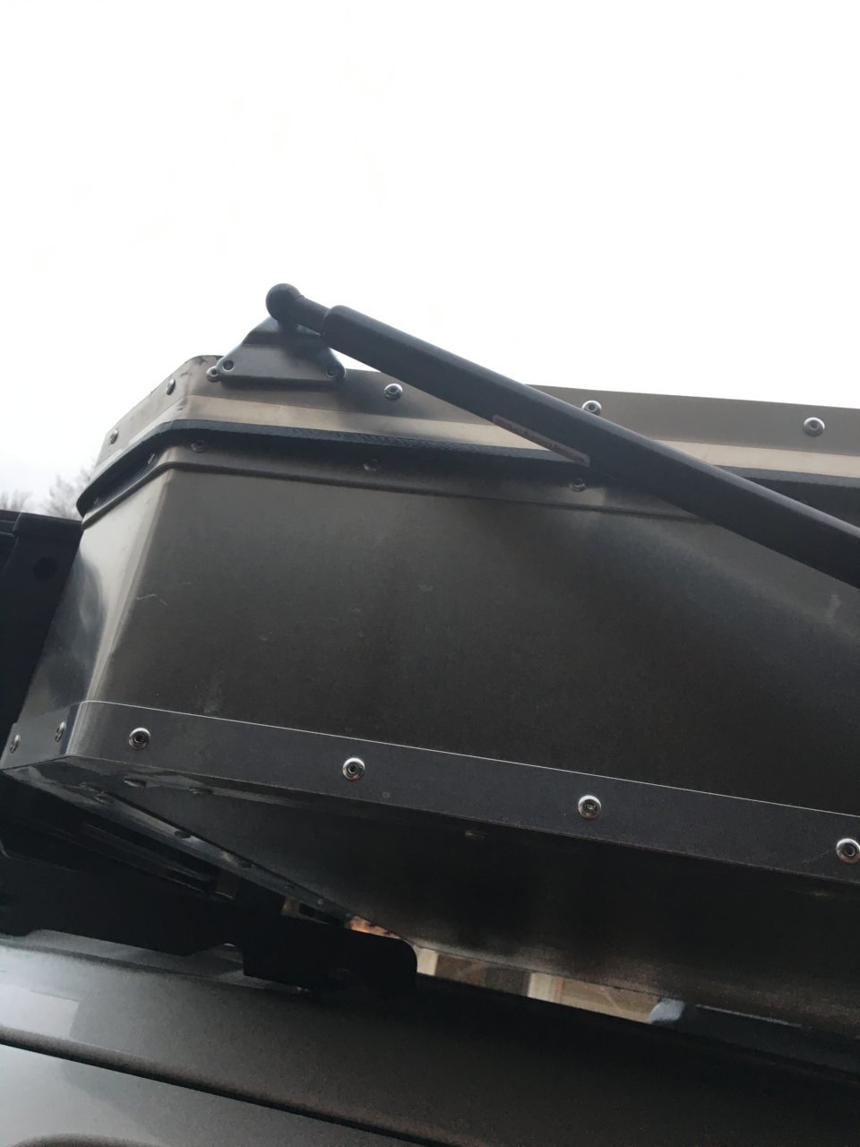

    Got some 20lb 44” lift struts in today. Should help easily with the roof lifting.
    58B994EA-0D03-449D-8FE0-9F5D2A71C8BF.jpg 9B396F23-5E91-4353-BA5F-837B67E9F7F3.jpg

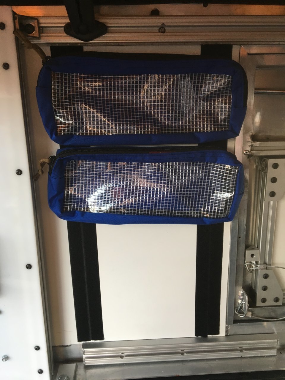

    Installed my new lift struts on the front of the camper, make it easier to lift up. Ordered some for the rear, as the fronts were a proof of concept. I also found a place for my blue ridge overland gear bags, just gotta order 1-2 more to fill up the wall.0DC8A47A-ADC8-4F8F-ABB8-5792ADDD31AB.jpg6EDB7875-7485-4A86-8D36-34EB87677CAC.jpg4D3C5515-0DCE-40F2-BA15-5C1D41DA61CB.jpg5F060D94-4BDF-4990-9828-173527236C2E.jpgDFD0A80E-D6A4-46D7-B316-7E0FBAFB2B41.jpg

  16. Jan 8, 2019 at 1:50 PM
    #116
    Bajatacoma
    Bajatacoma Well-Known Member
    Dec 10, 2010
    #47503
    1,932
    SC
    05 TRD Off-Road, SR5, 6 speed
    It's looking really nice, I like the bag idea too.
  17. Jan 10, 2019 at 11:23 AM
    #117
    crolison
    May 17, 2011
    #56801
    3,157
    Ar vah da, CO
    POS

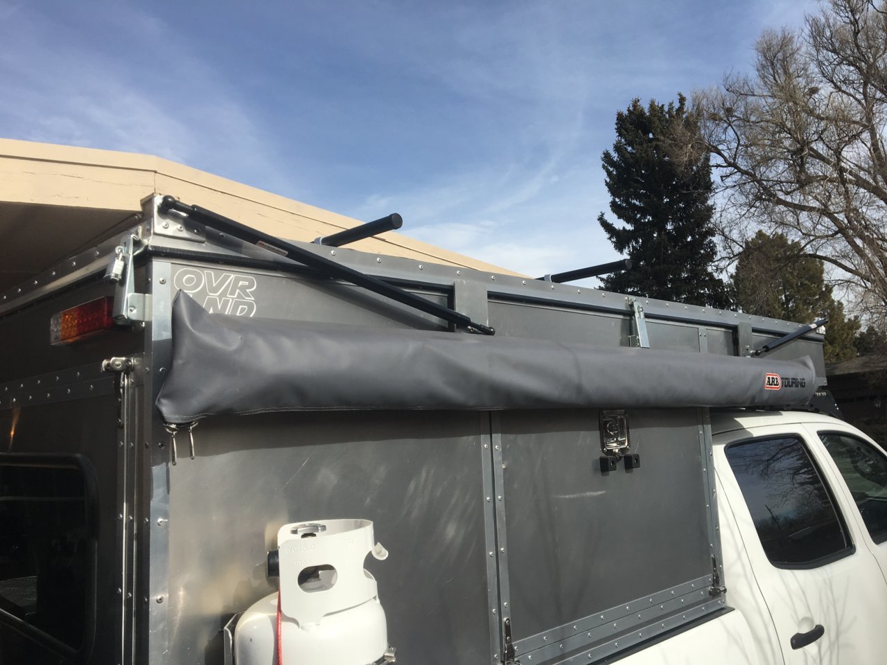

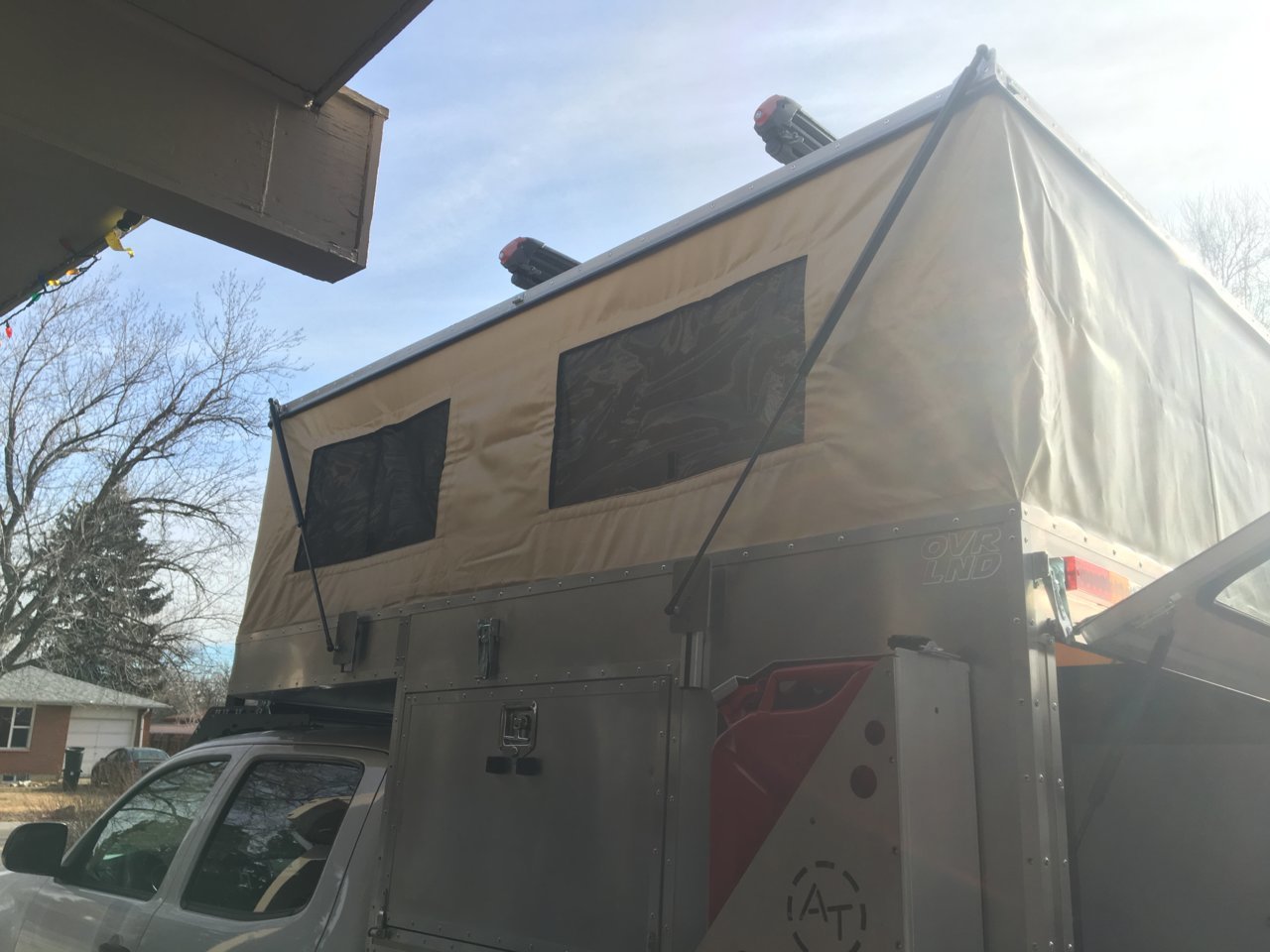

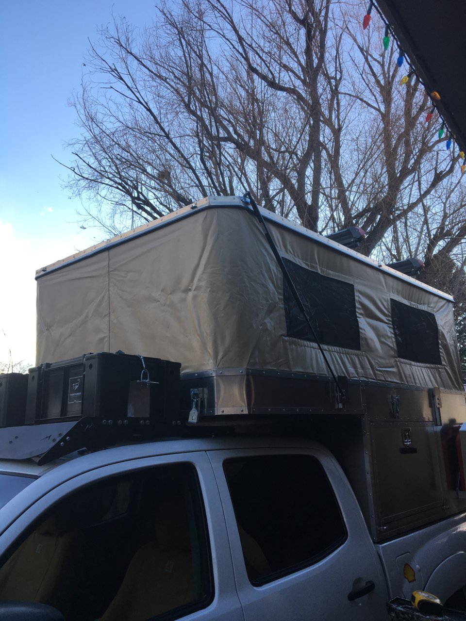

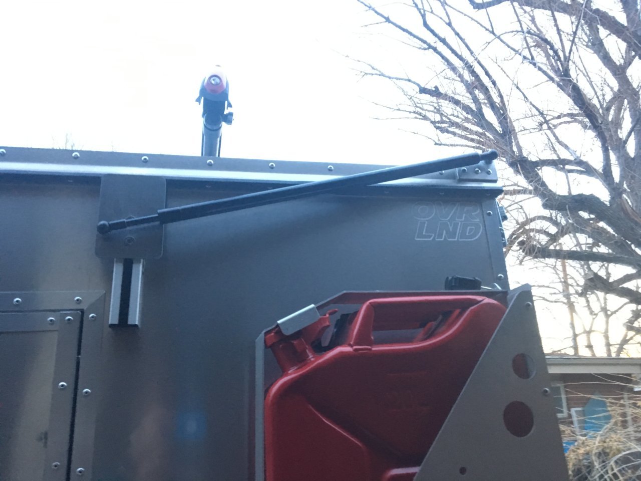

    Got my second set of lift struts in, and totally worth it. Makes opening easier, and closing much easier.
    3932FA7B-A985-46E5-B7D7-3322BAB5DE4E.jpg EC745139-37F6-4BBD-BFE7-C3F7A766FFBE.jpg 6BD11F98-646A-483C-9F00-4371094C7169.jpg 1FEFAAA9-58B6-4701-8682-A90D68C172C0.jpg
  18. Jan 10, 2019 at 11:58 AM
    #118
    jbumx2
    jbumx2 Member
    Sep 13, 2016
    #197186
    21
    nice job!

  20. Jan 11, 2019 at 11:15 AM
    #120
    danneskjold
    danneskjold Well-Known Member
    Aug 20, 2017
    #227402
    1,285
    Brian
    Shoreline, WA
    2018 F150

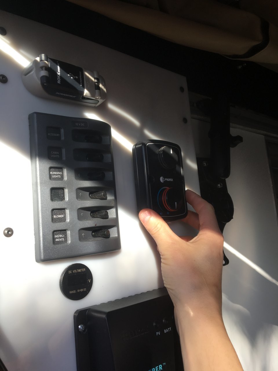

    YMMV, but I would suggest putting the Propex controller within reach of your bed so you can adjust it while laying in bed.
