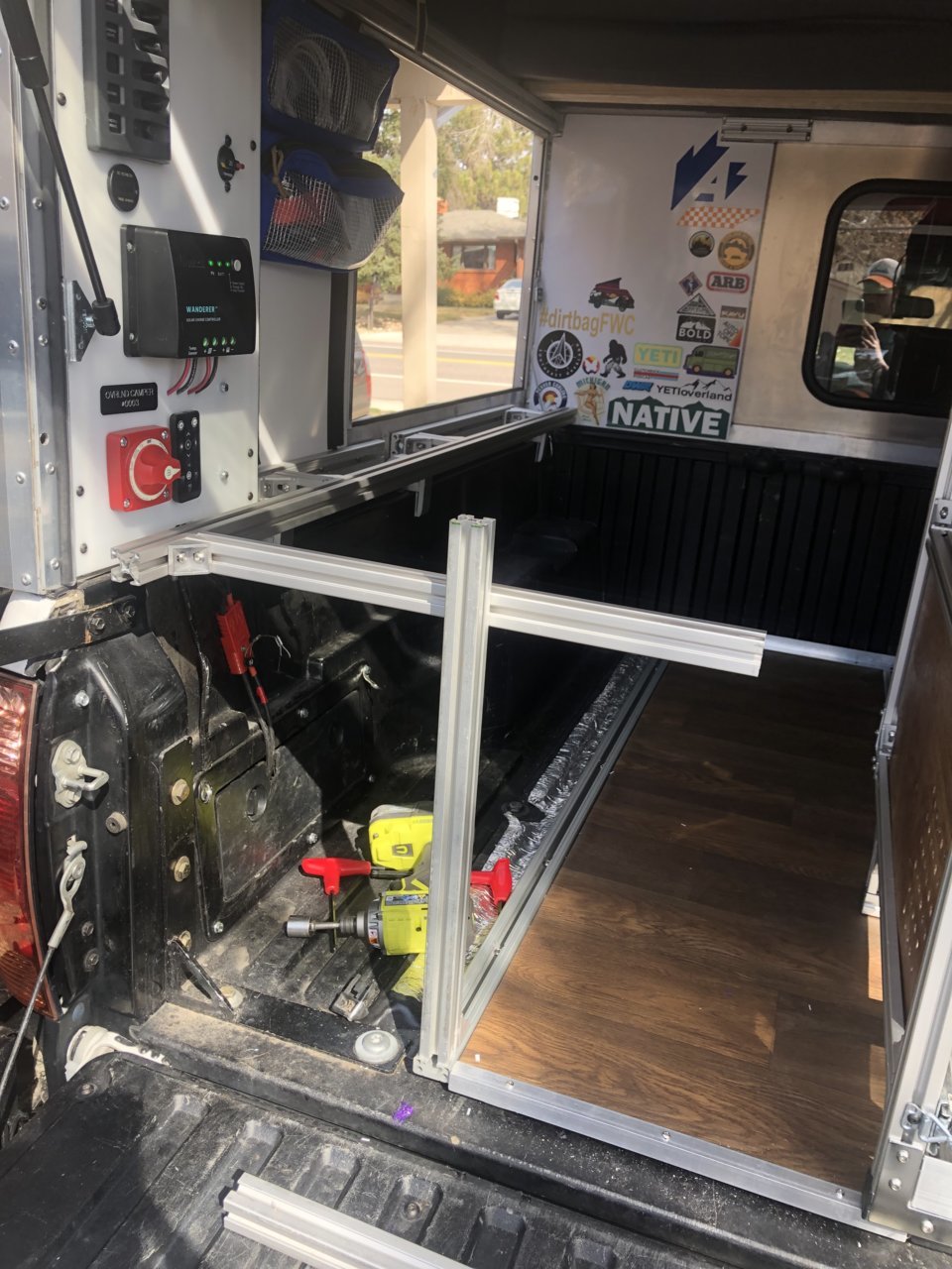

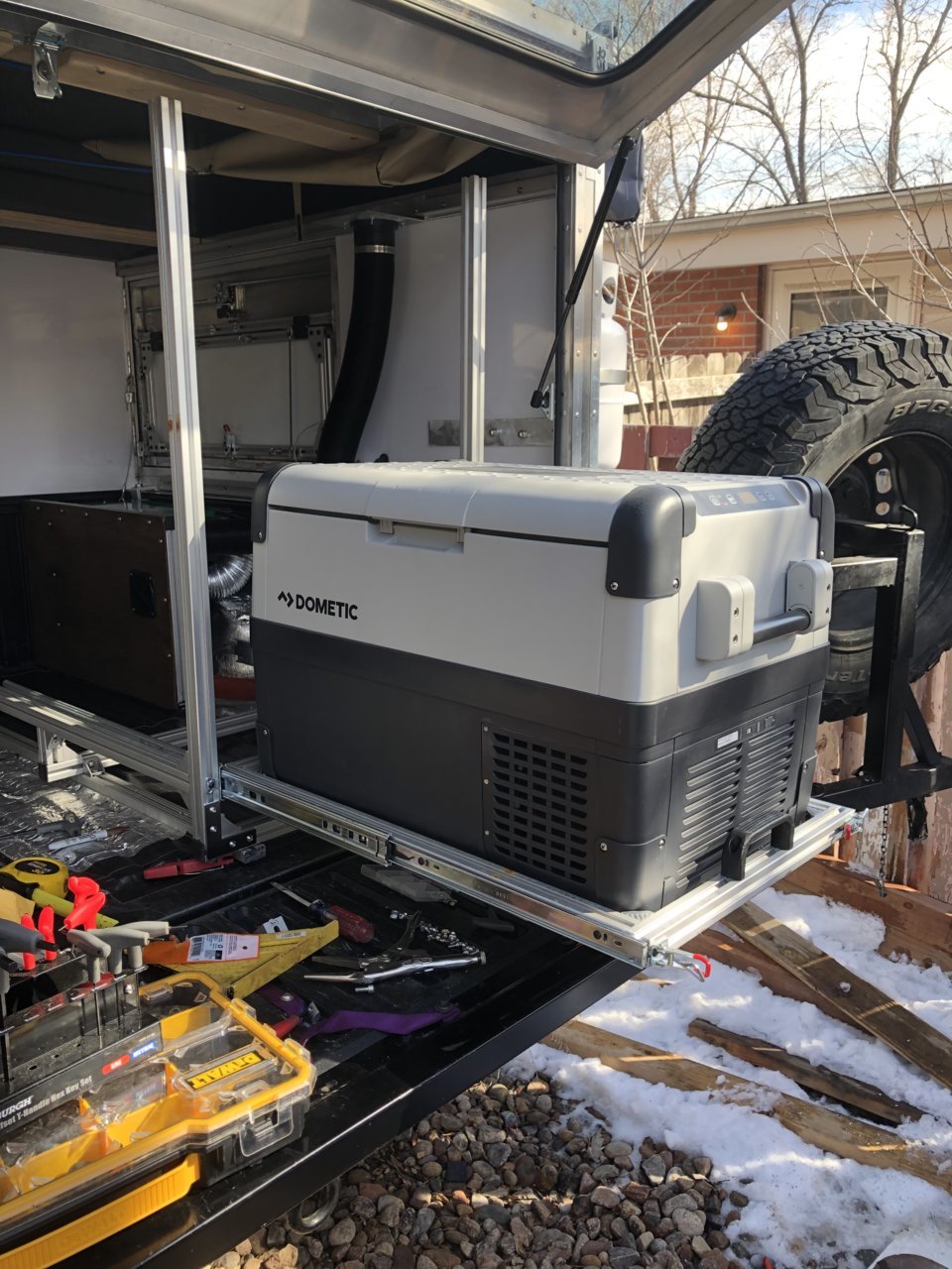

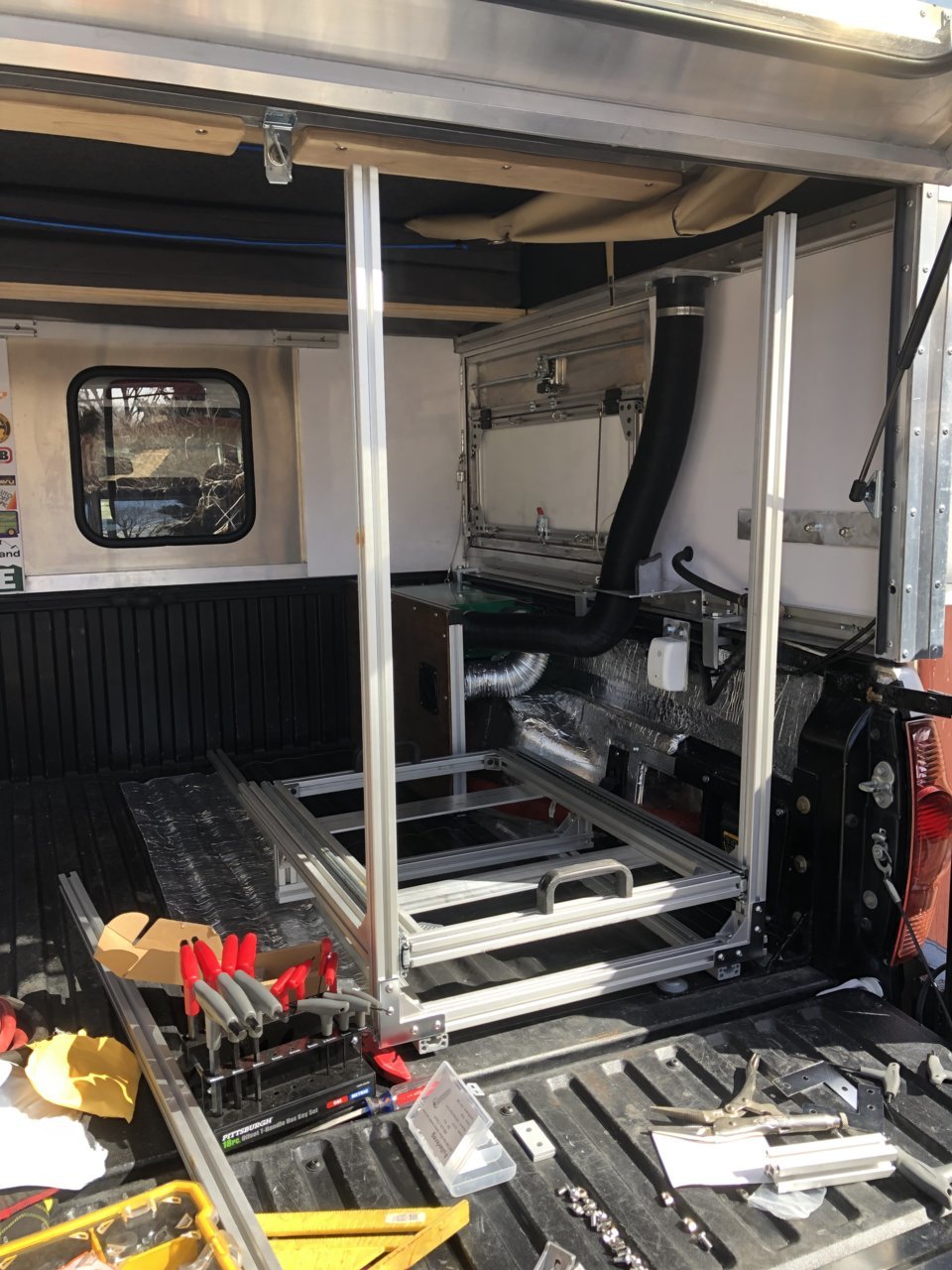

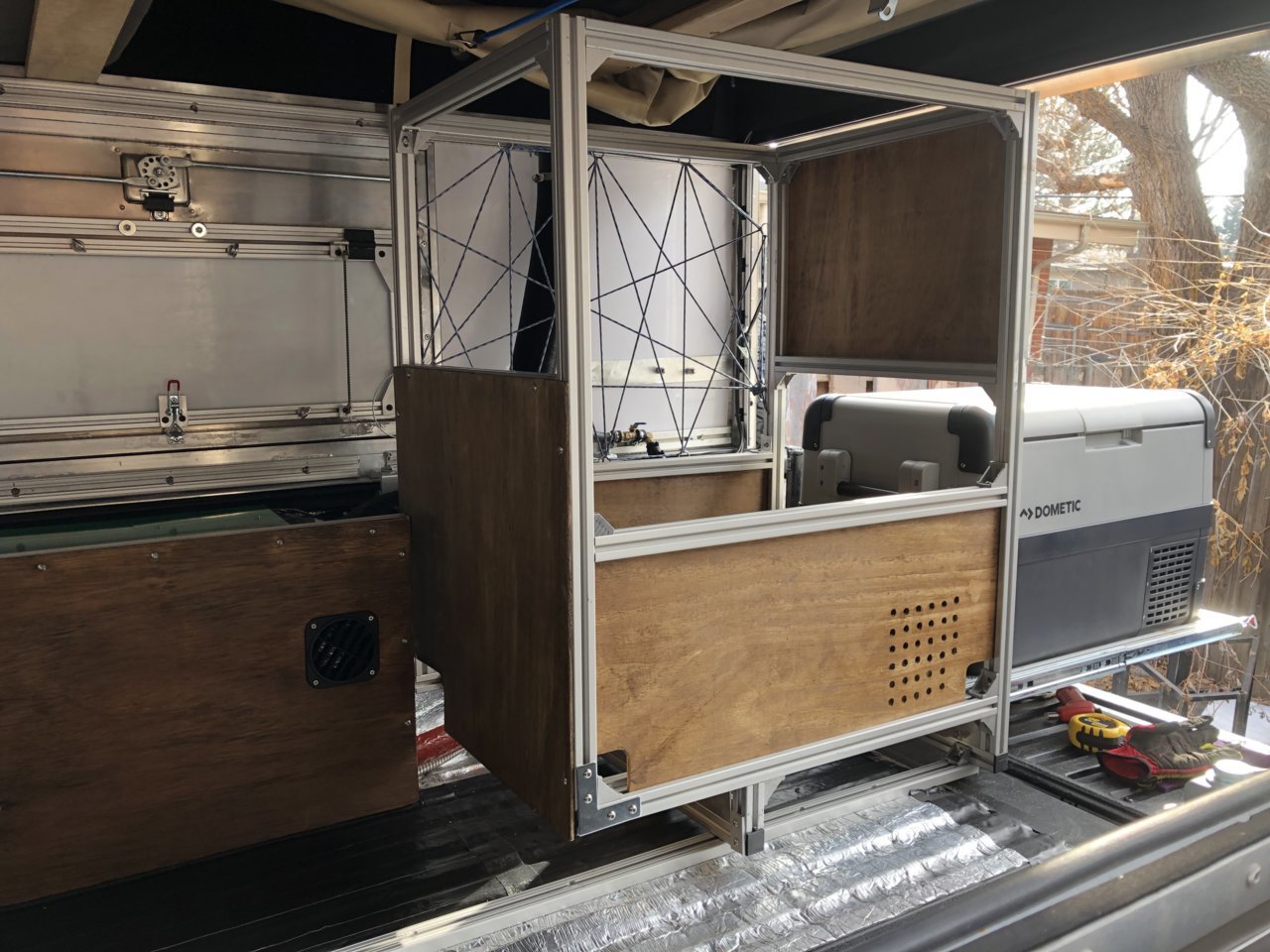

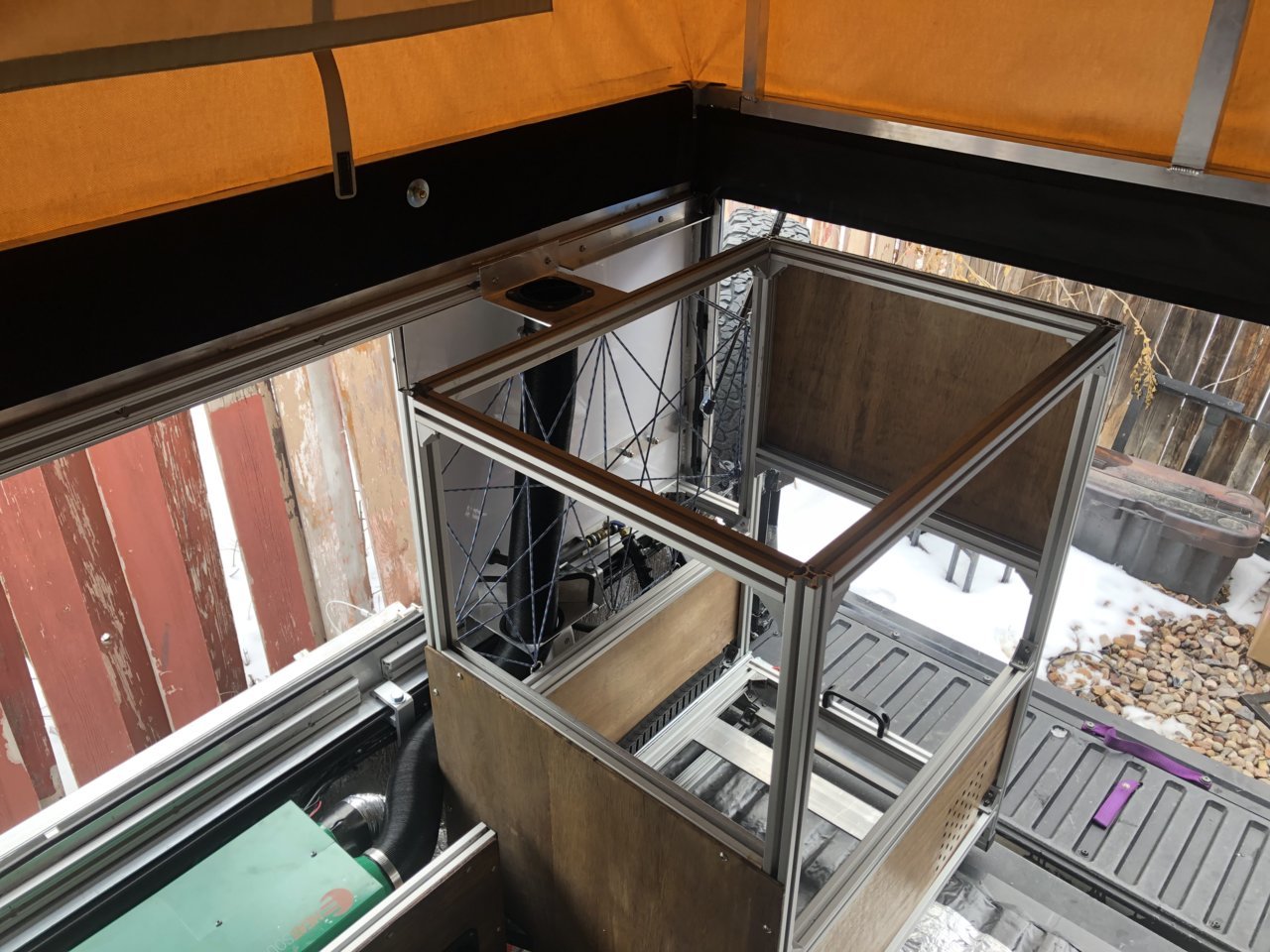

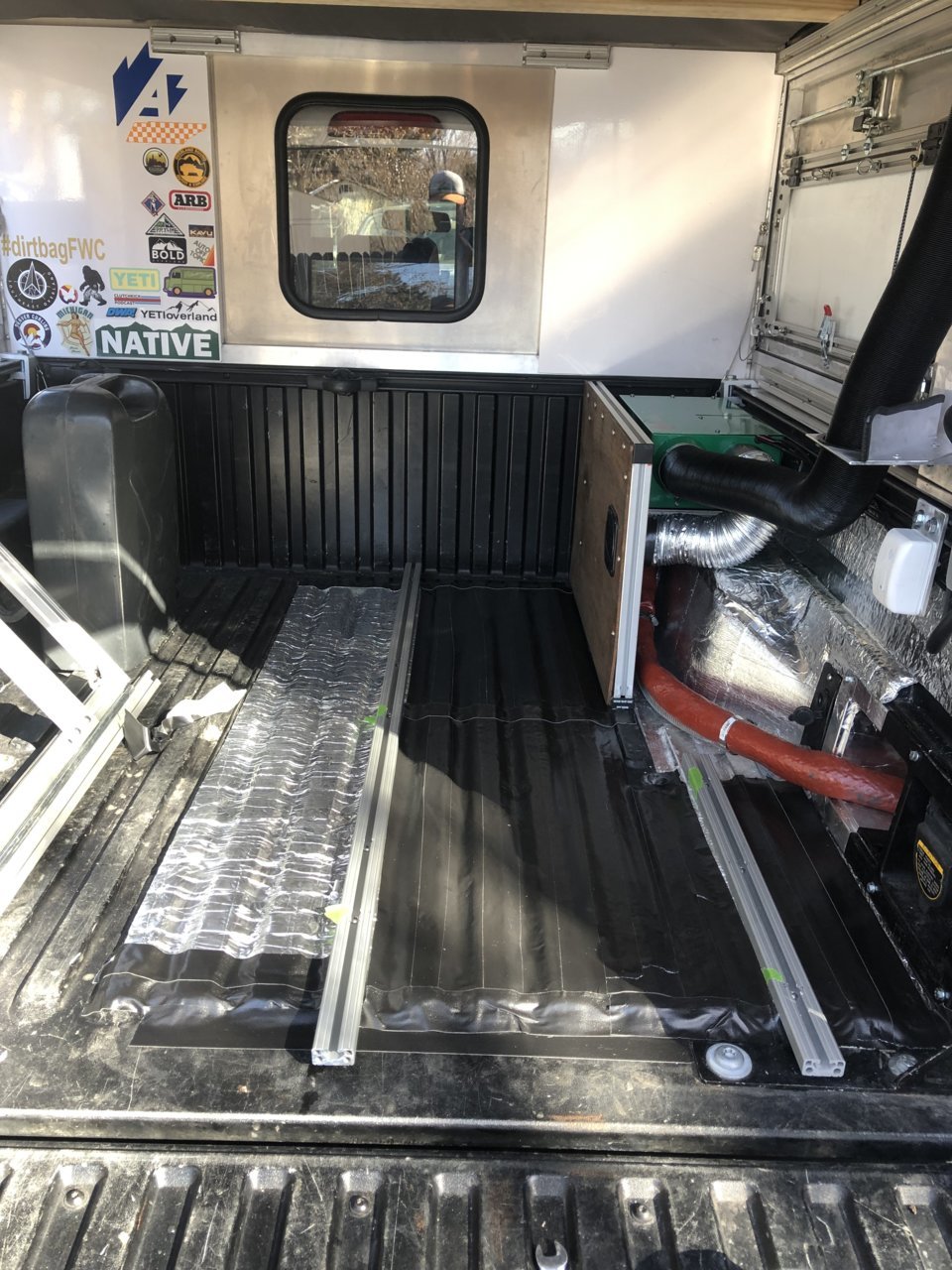

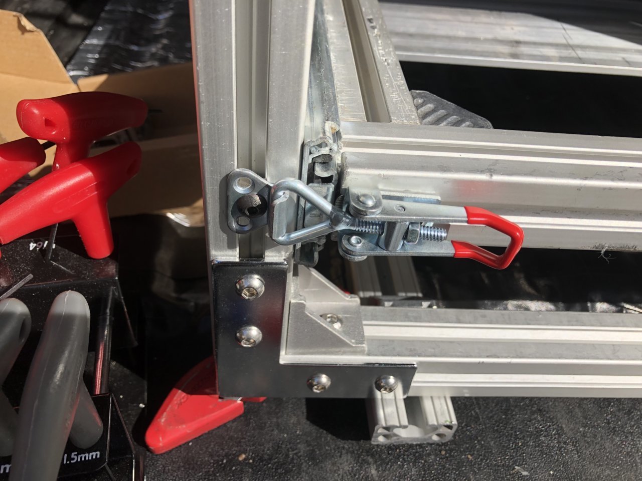

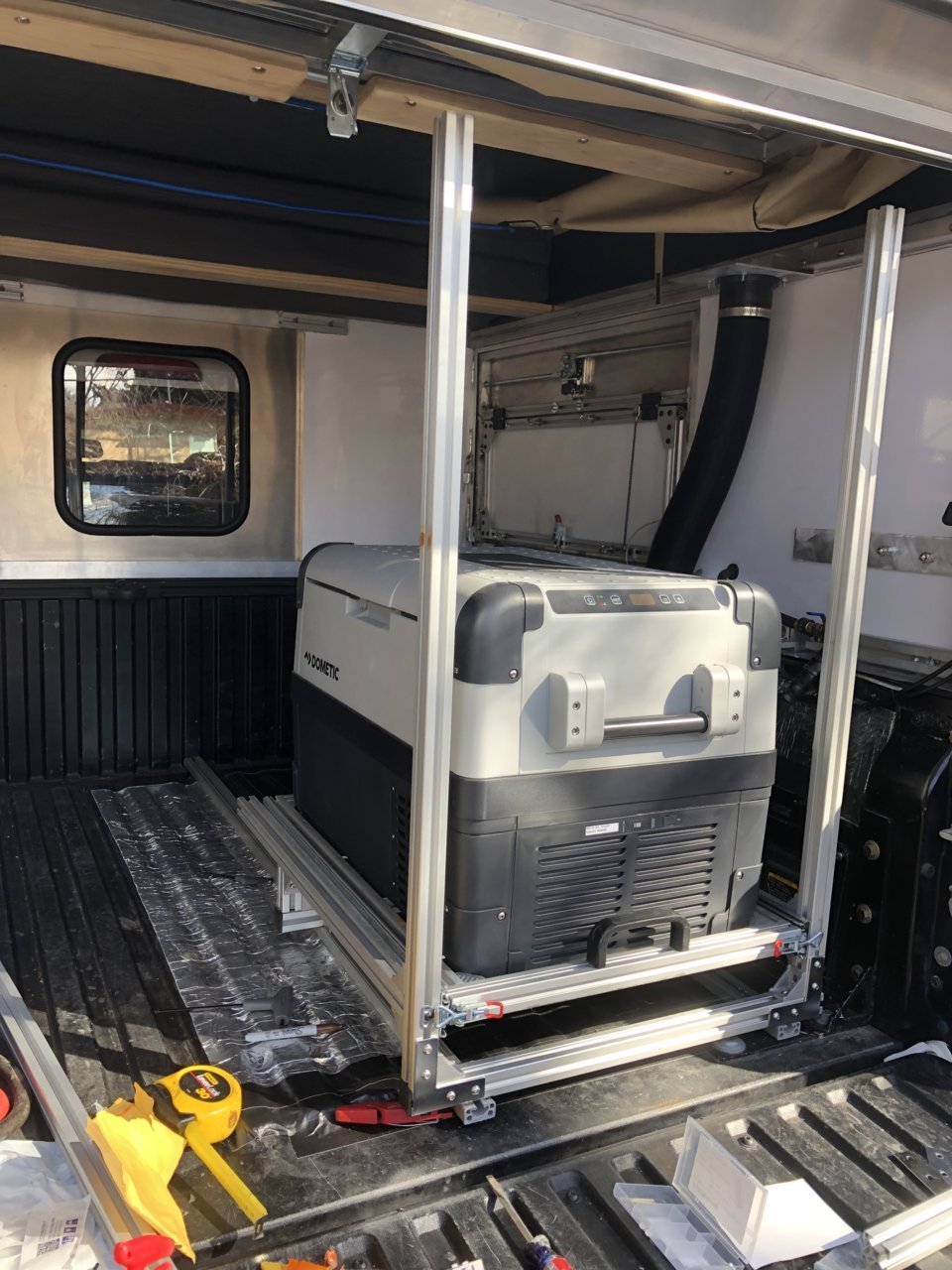

    Worked some more on the interior of the camper. Ran out of 8020 fittings, so cut a bunch of parts cut and made up. The final assembly, minus the panels should go pretty quickly. I am not sure if I like my latches yet.
    The reason the fridge is so high up is to leave clearance for the propex exhaust.

    Did you get those latches on McMaster? Can I get a PN for those and the catch? I’m currently using a slide bolt lock on my cooler slide and it’s just not working out. Thanks!

    I used these for my slide
    POWERTEC 20311 Pull-Action Latch Toggle Clamp, 220 lbs Capacity, 4001, 4PK https://www.amazon.com/dp/B06XSWYQT3/ref=cm_sw_r_cp_api_i_oVRDCbCW01NMW

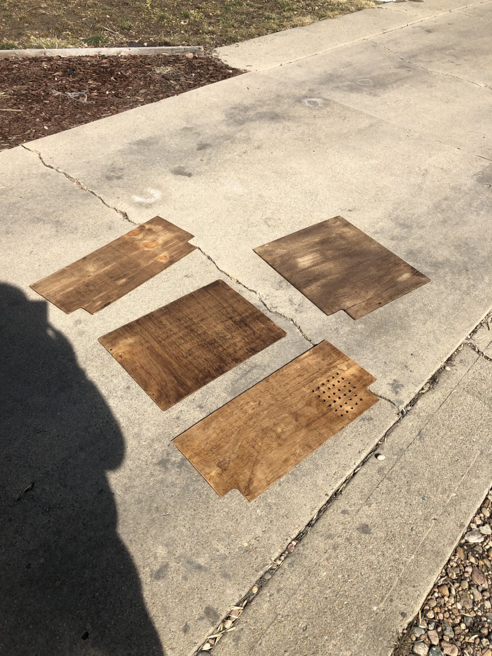

  6. Feb 27, 2019 at 5:02 PM
    #146
    crolison
    crolison [OP] Well-Known Member
    May 17, 2011
    #56801
    3,157
    Ar vah da, CO
    POS

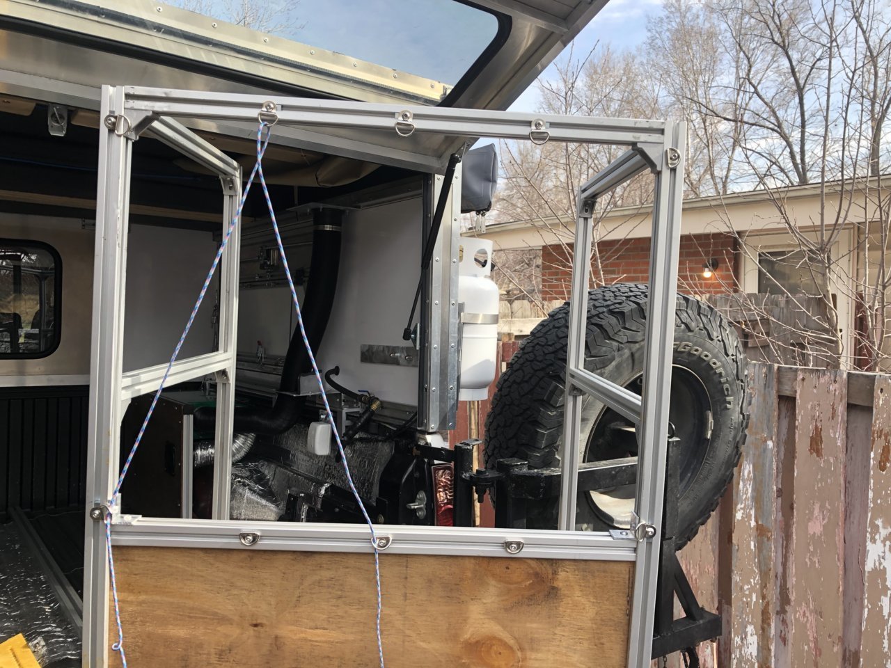

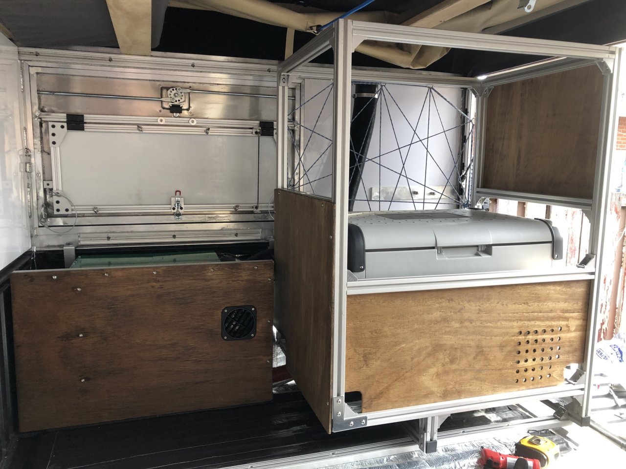

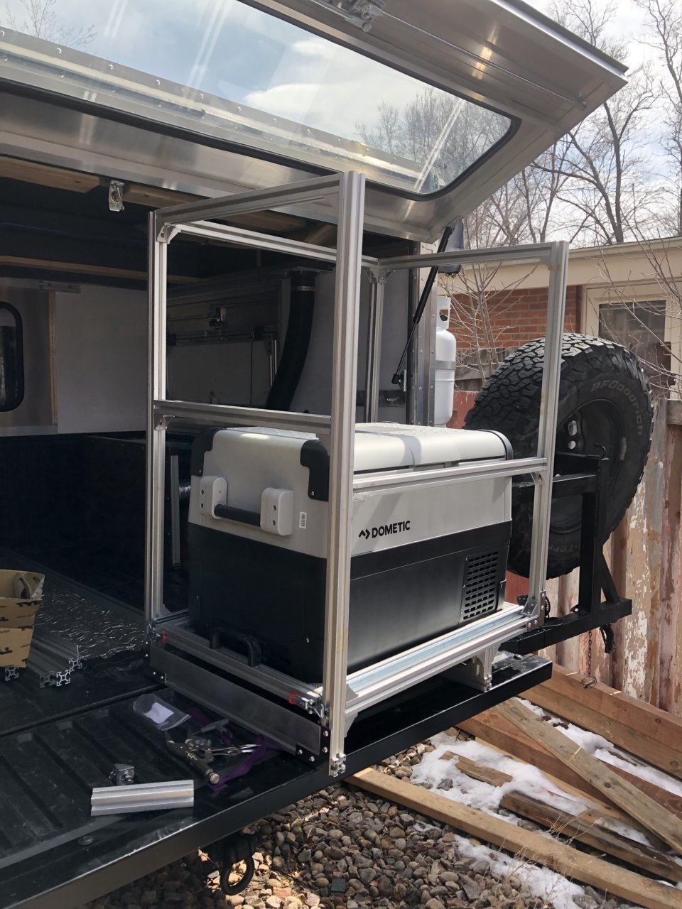

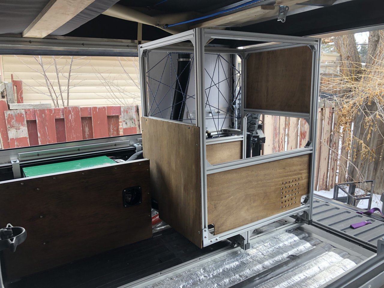

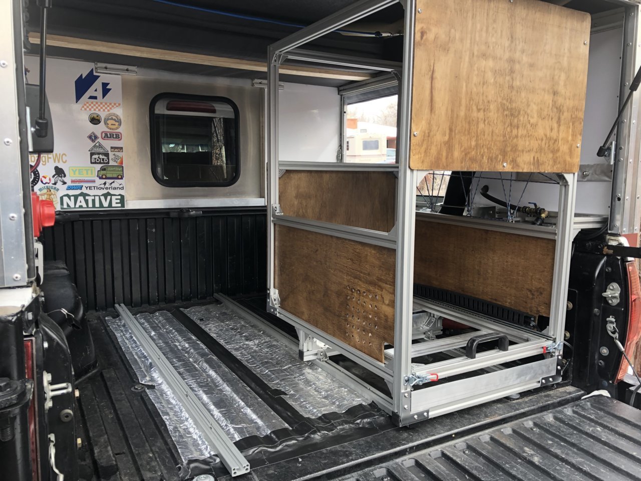

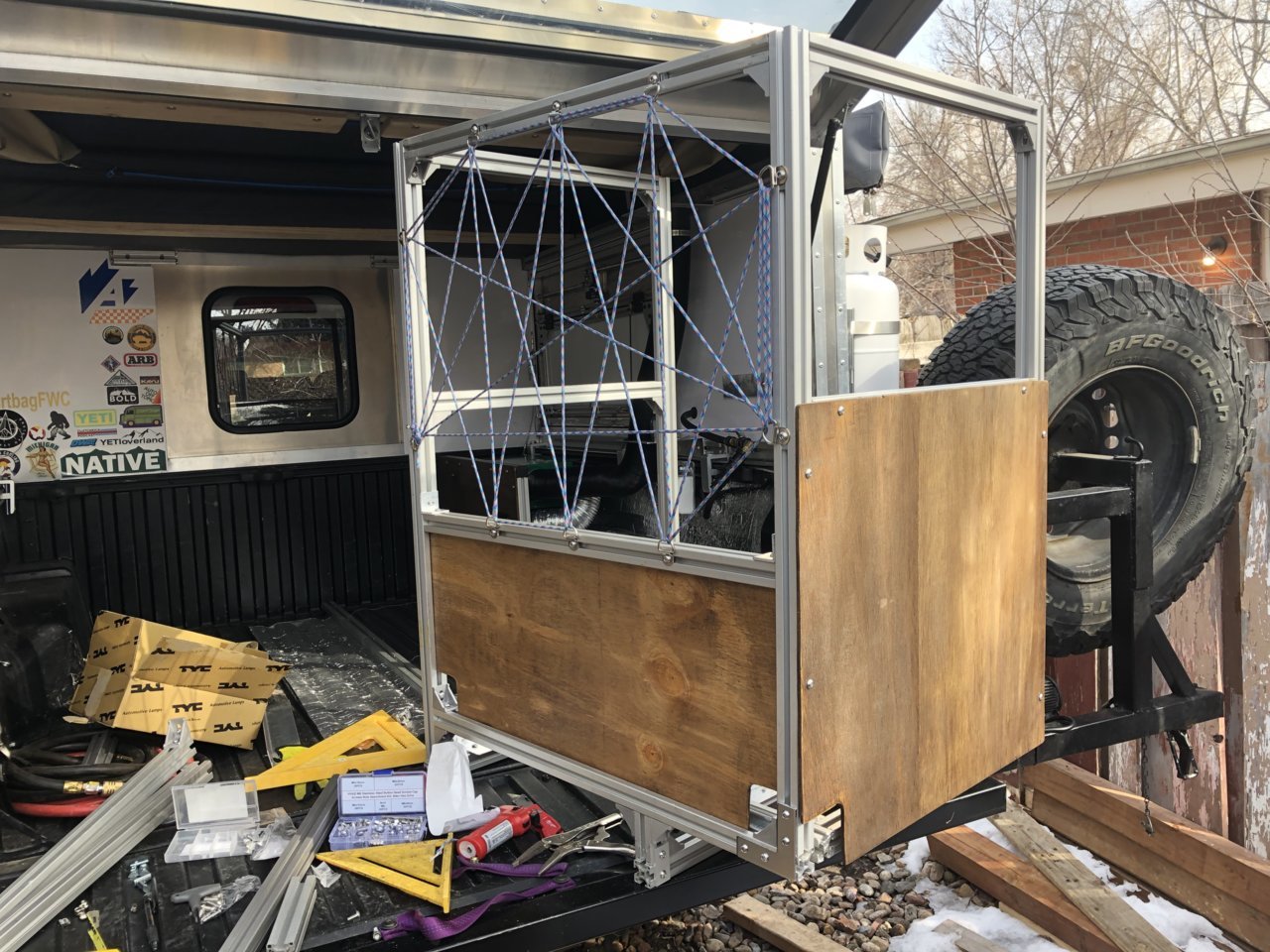

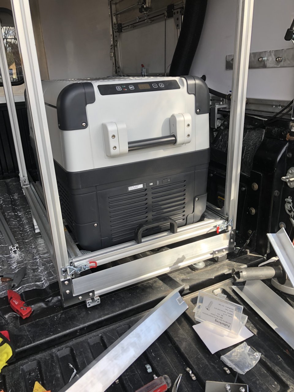

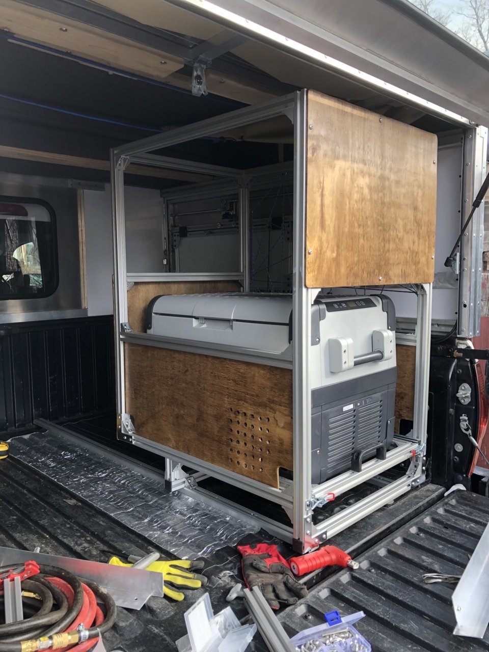

    Worked on the fridge slide more today. I was taking off all day to work on the truck but of course work emergencies happened.
    But I have the skeleton done and most of the panels made up. Think I’ll head to Home Depot tomorrow to get the shelve and top for the fridge slide.

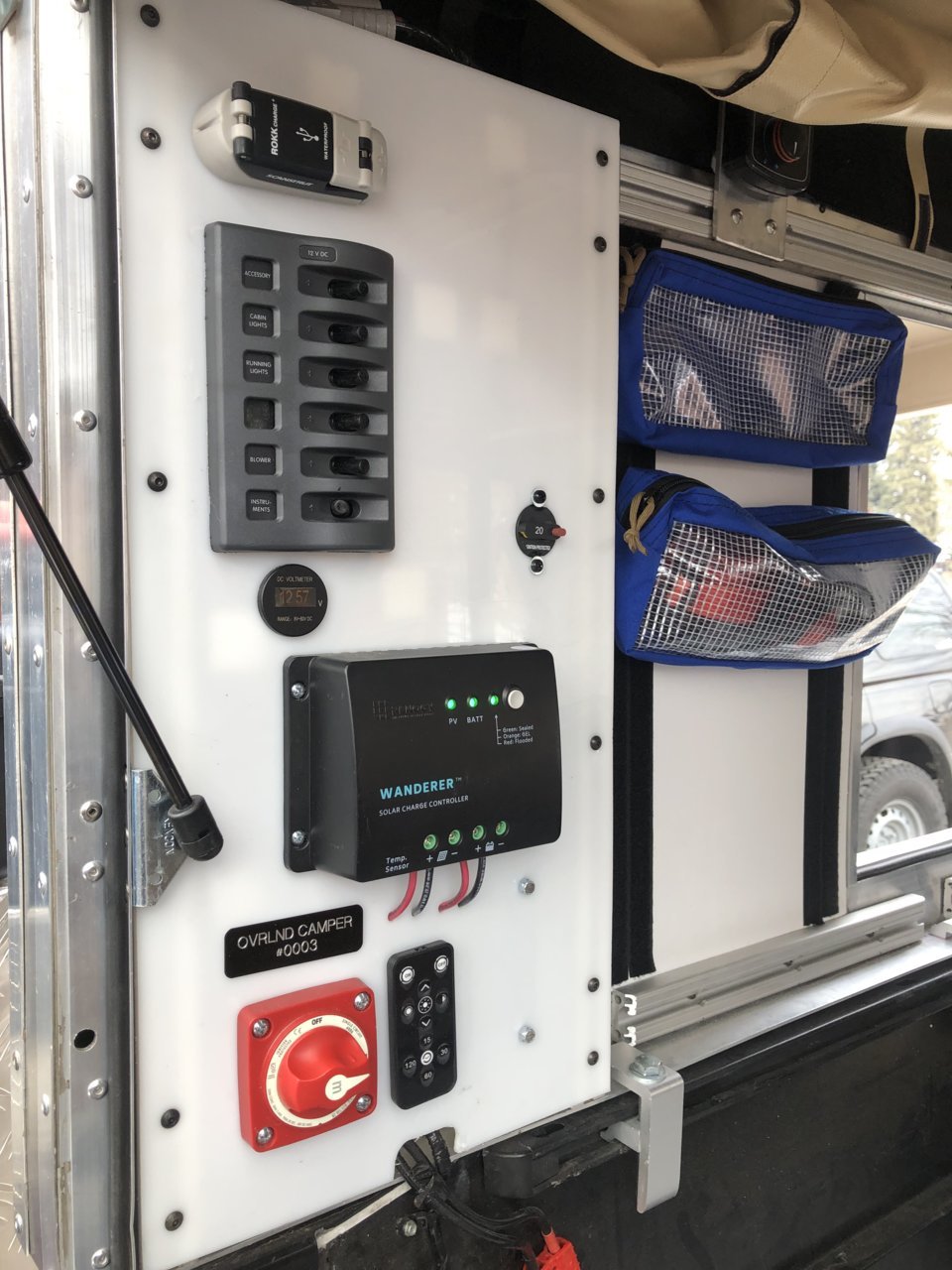

    Worked some today on installing a renogy 160w flexible solar planet.
    I used industrial outdoor extreme Velcro to hold it down. I need to add a small windbreak on the front of the panel.

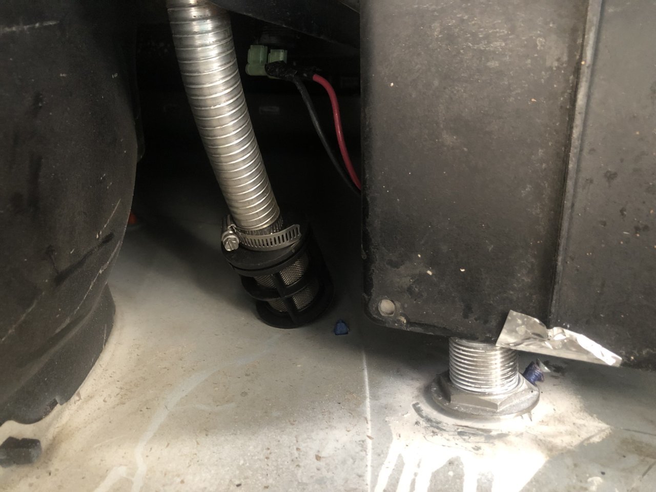

    Looking good. Make sure that your Propex exhaust is routed so that it will be away from the vehicle, not under it, and also that it can't get blocked by snow or collect mud. I've seen a couple of guys in the VW camper community set theirs up so that when camping they could connect a section of flexible exhaust tubing to the exhaust and have it dump several feet away from the vehicle. It was an extra safety measure but also so that they could crack windows on both sides and not worry about exhaust smells. It's doubtful that you'd get enough to hurt you but it still smells a bit. :thumbsup:

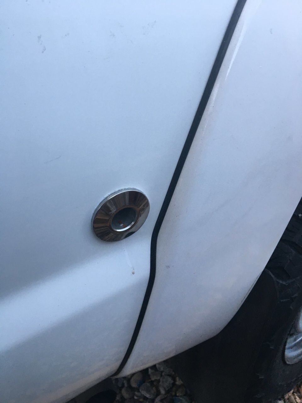

    My propex exhaust is via a boat exhaust port in the beside behind the passenger side fender. I also picked up a plug for it for everyday to keep mud / snow / dust / bugs out

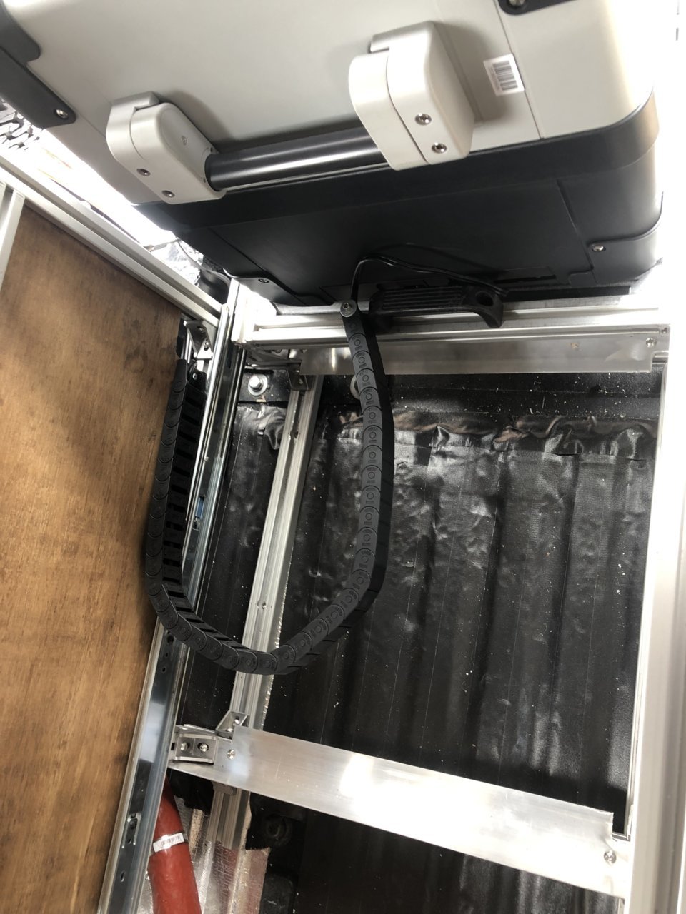

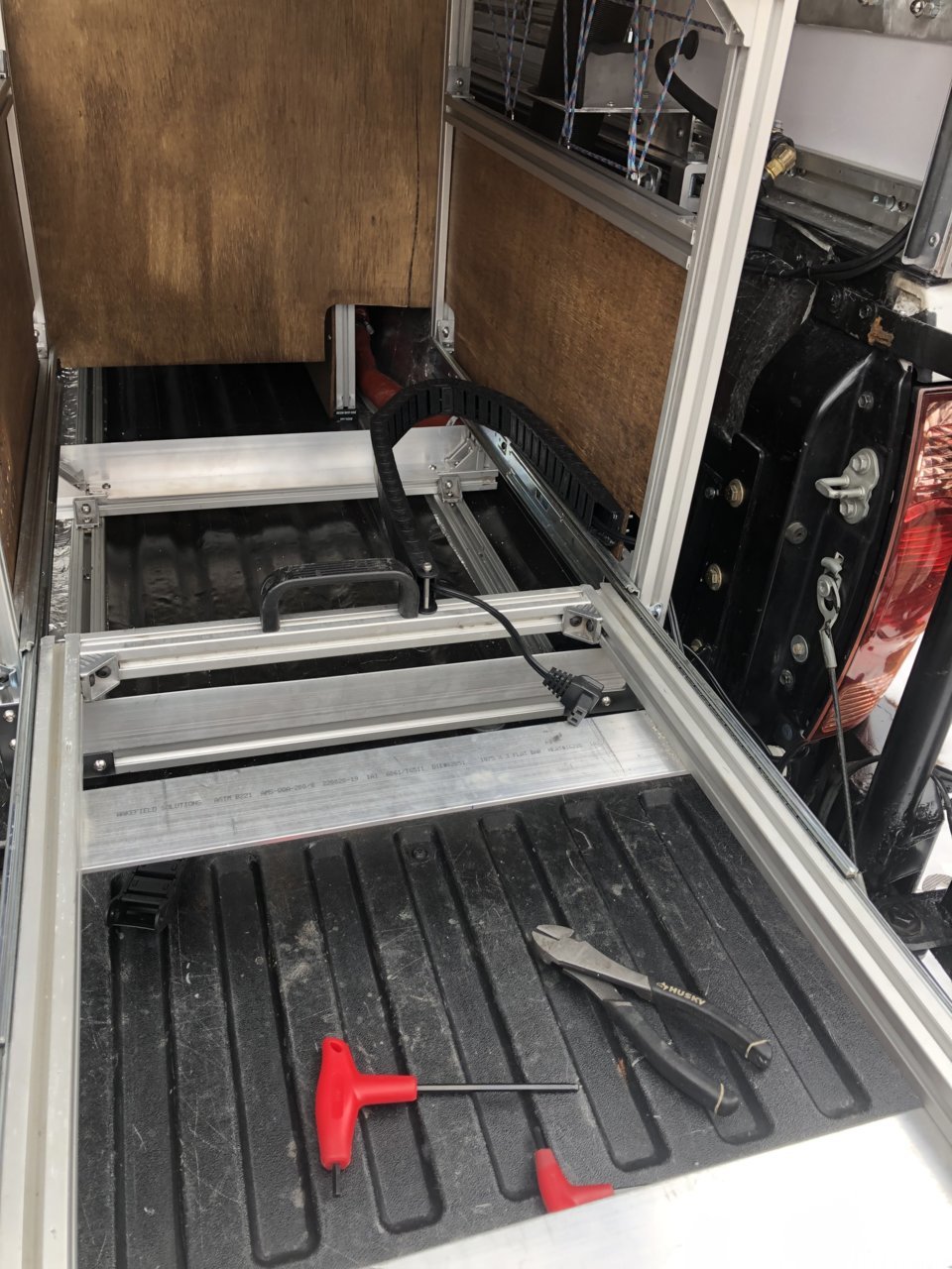

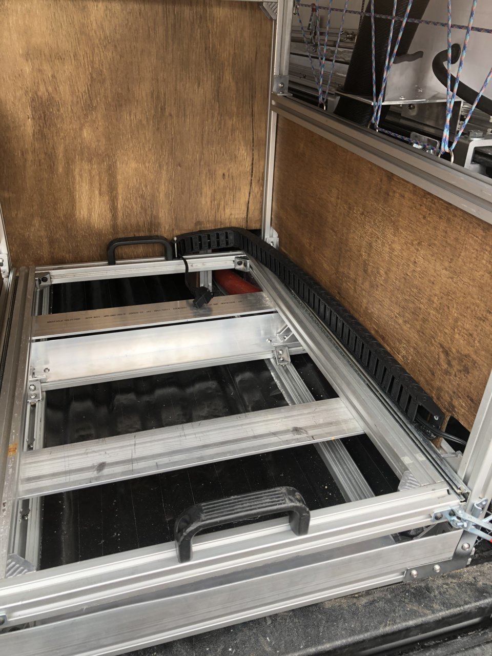

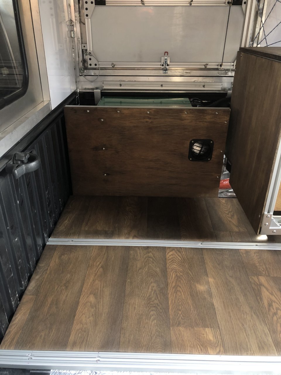

    Got an hour to work on the camper today, finished up the fridge portion of the storage. Used a cable chains to guide the power cable in and out. Turned out nicely. I also got another 8020 section installed through the floor. Now I have the measurements needed to start my floor finishing. Which will be vinyl sheet over marine plywood. Also took some updated interior shots for an article.

    Worked on the flooring today, used some vinyl sheet remenance from Home Depot. The plywood wrapped in the sheet vinyl is near a press in fit.

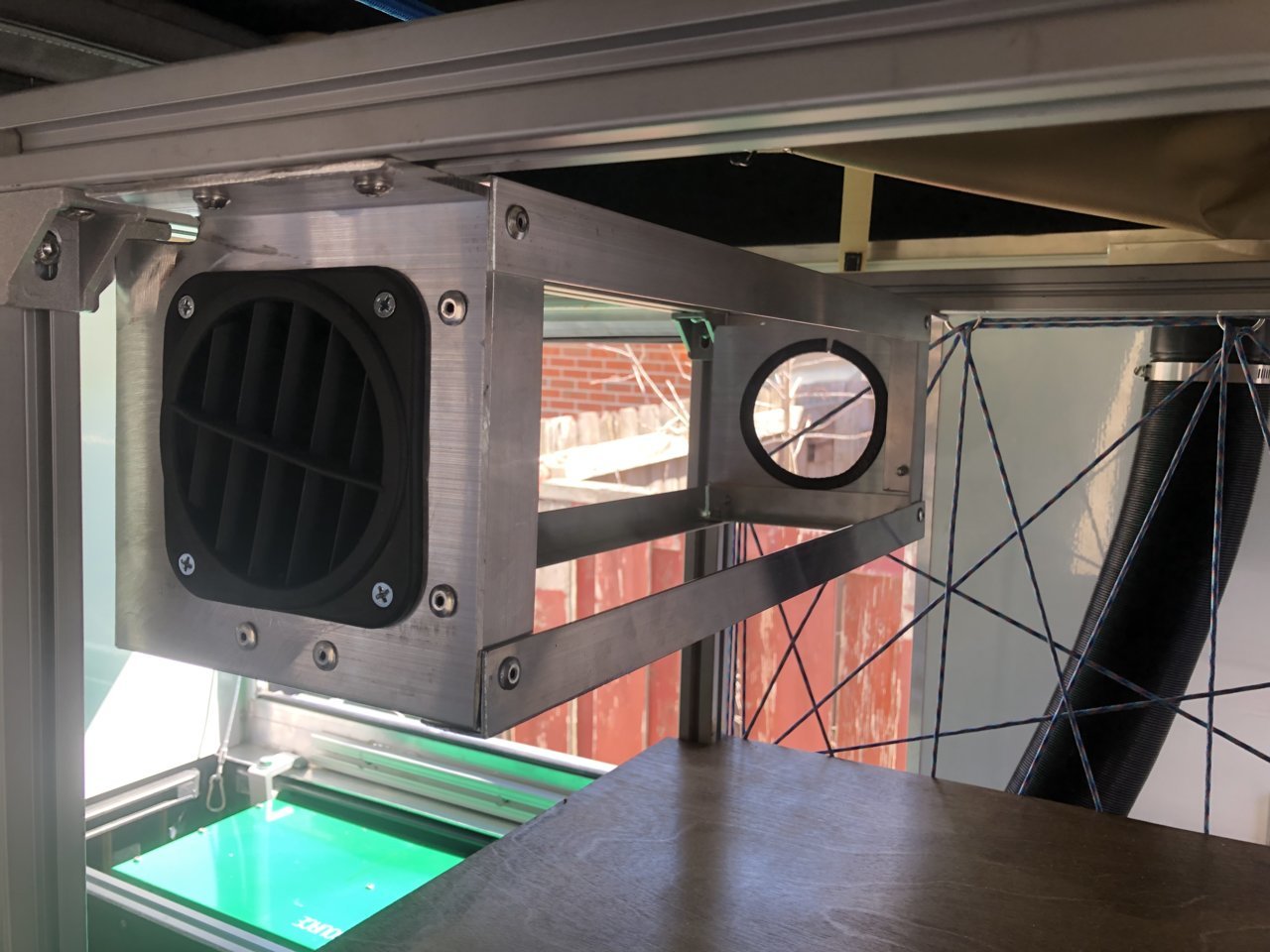

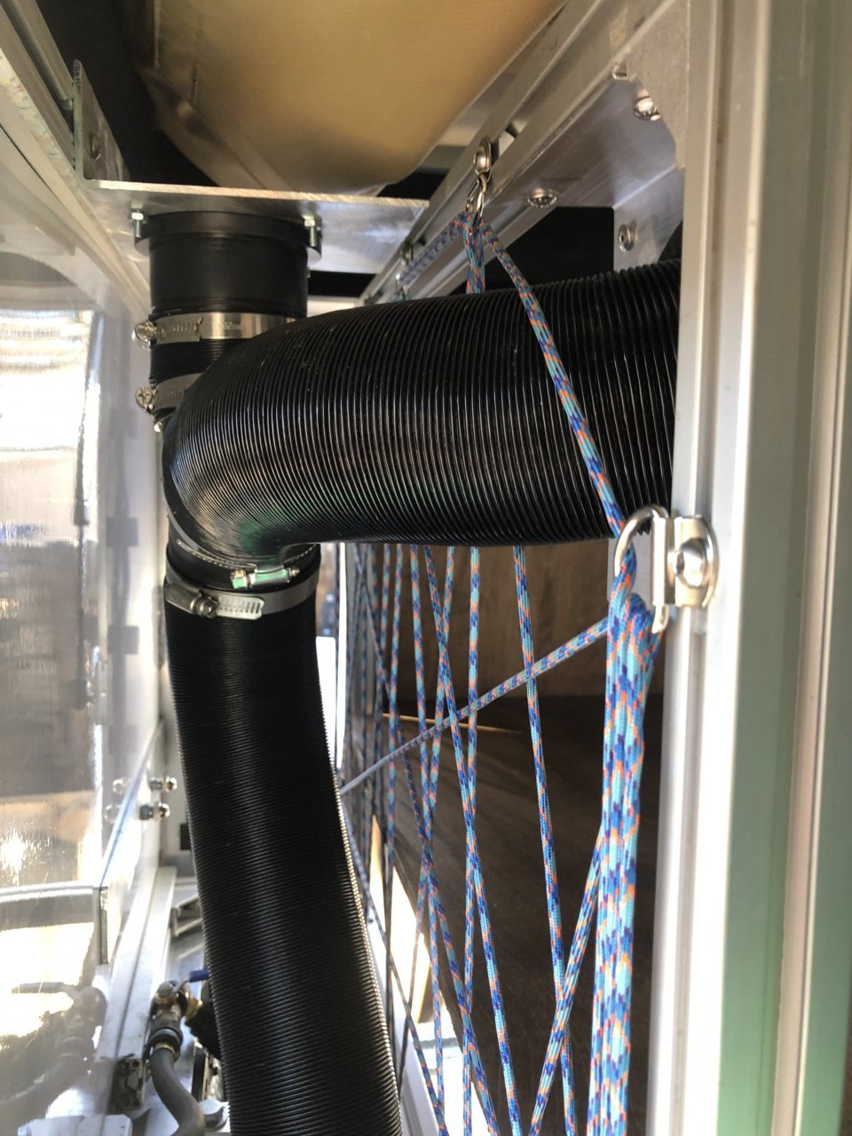

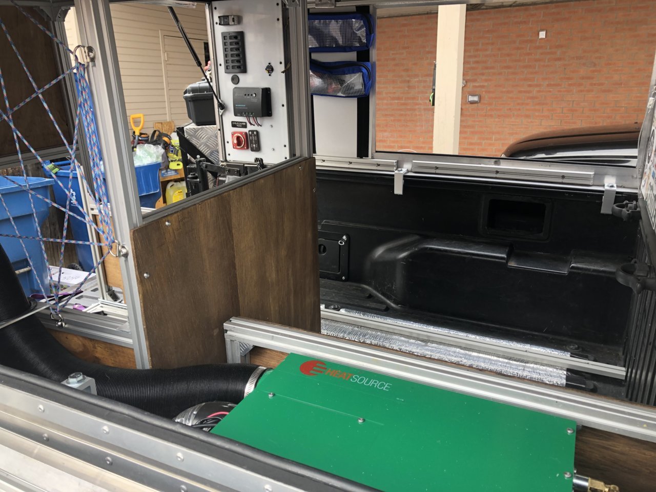

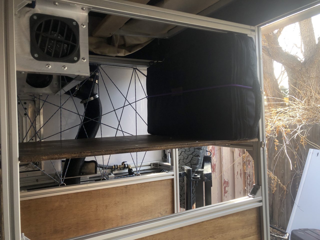

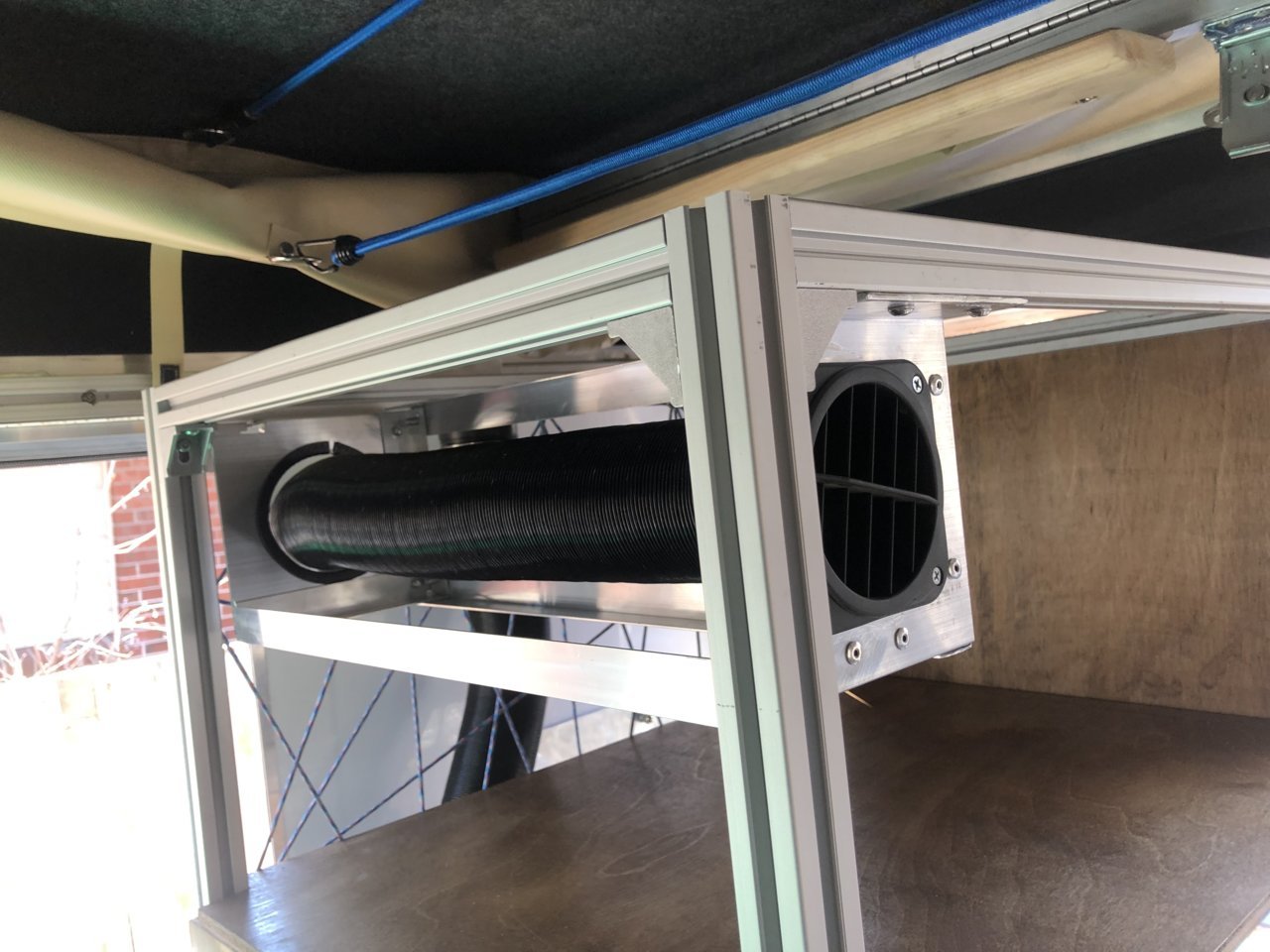

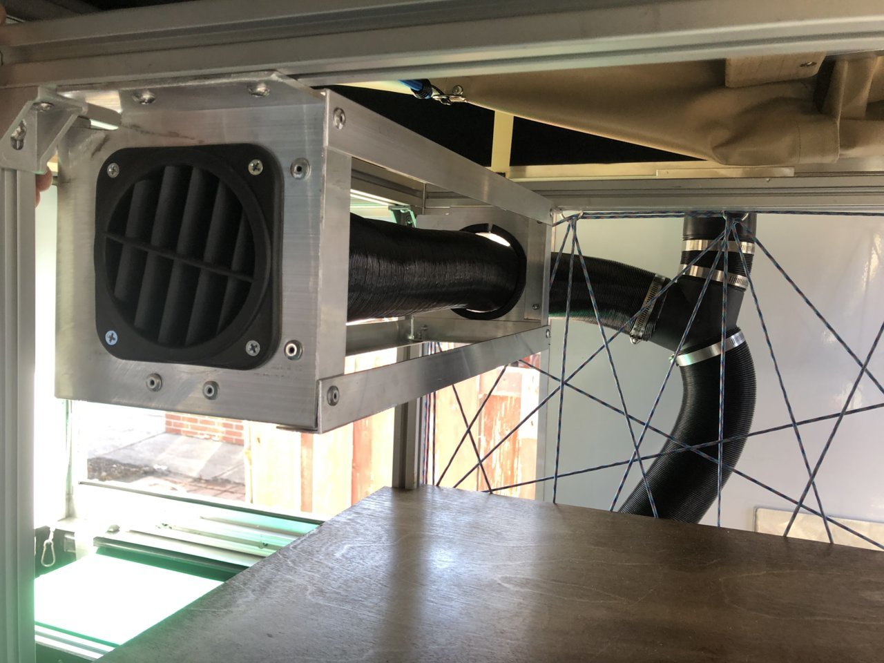

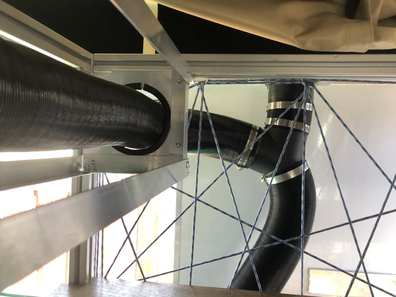

    Worked on the downstairs vent and hvac today.
