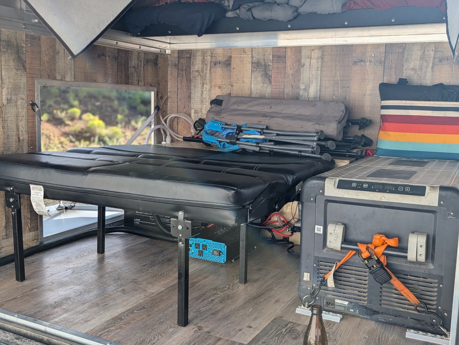

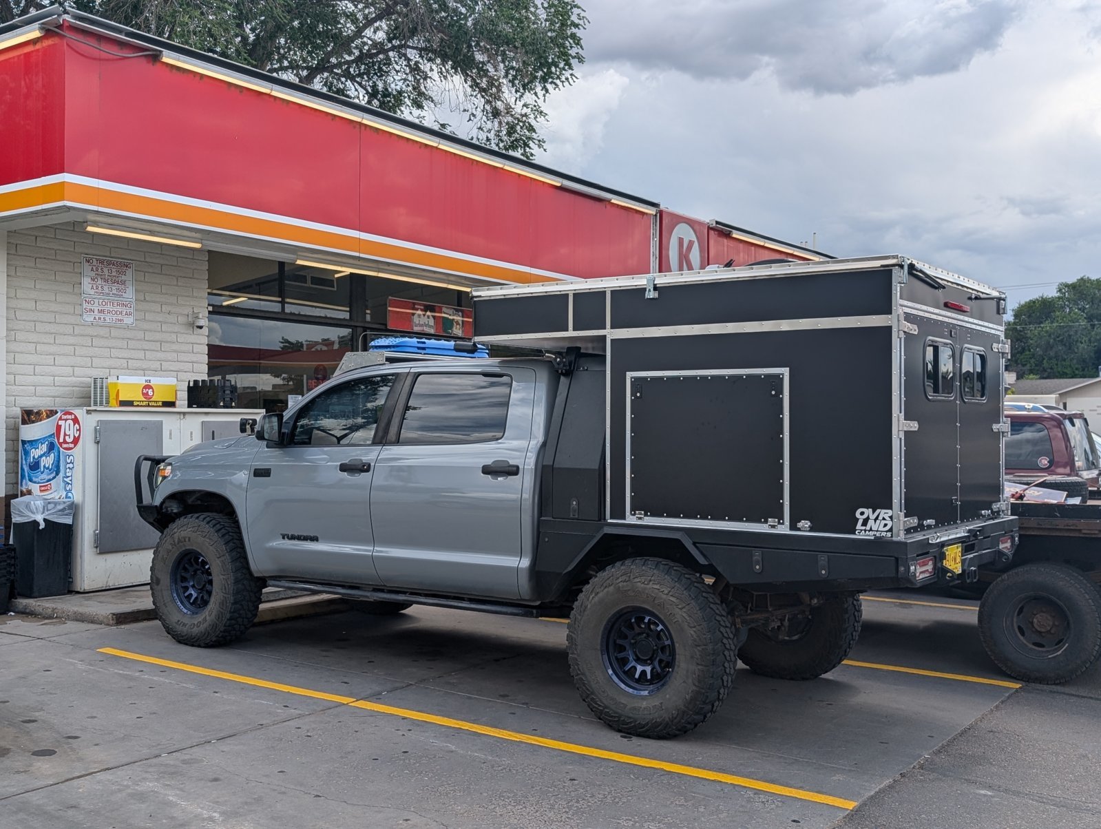

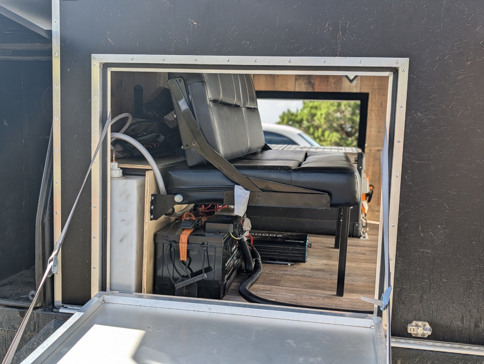

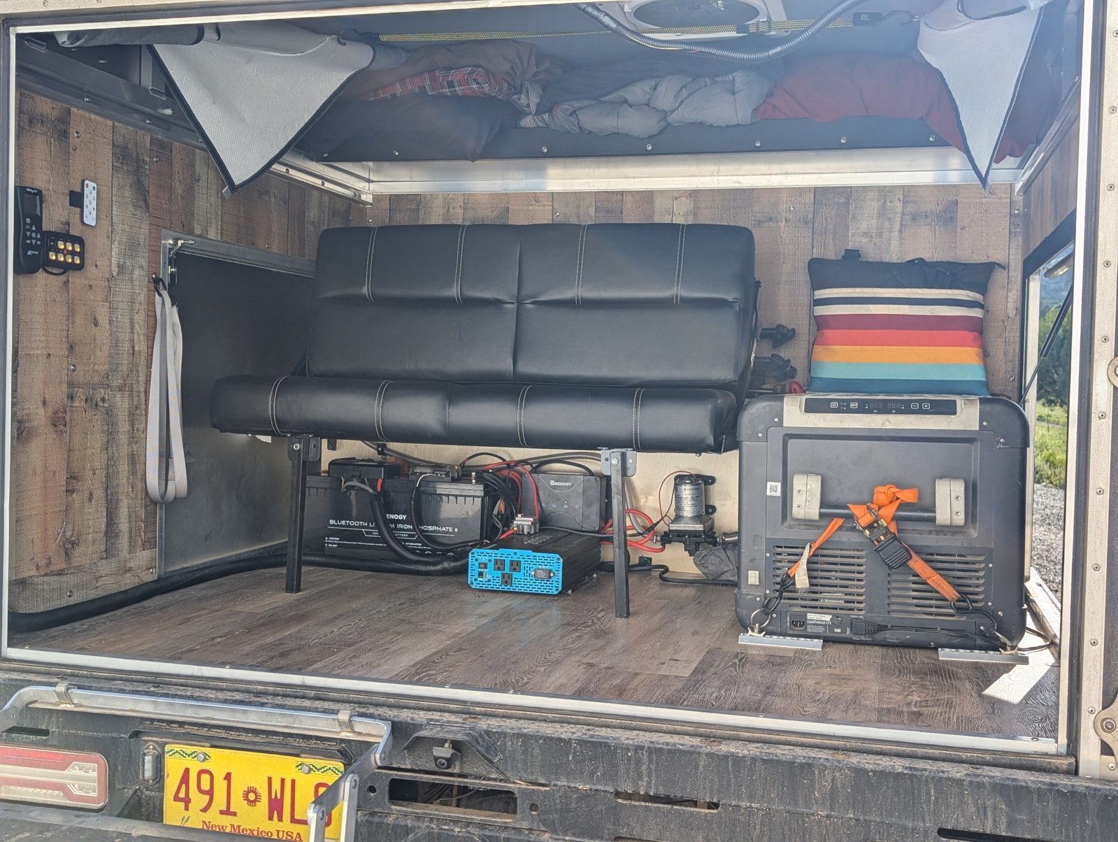

    The interior build on our flatbed camper is pretty close to done. I still need to build a shelf for cooking appliances and storage but it's totally functional now. We had OVRLND put floor "joists" in and we completely enclosed the camper. We used 1/2" birch plywood covered with vinyl for the floor. Then we insulated the walls and covered it with a wood look MDF panel. The front left has a ~25 gallon water tank with a 12v pump. I still need to put in a couple quick connects for the water through the walls of the camper, but I'm not sure which ones I'll use for that yet. We have 400 watts of solar on the roof running through a renogy 50a dc-dc/mppt controller into a 200ah renogy lithium battery. We have easy fridge access from outside via the flip up hatch and it is still easily accessible from inside. Bags and chairs can be stored behind the back of the couch. The couch rolls over into a bed for our 3 year old. I'm going to add some molle panels to the outside of the rear doors for propane storage and a box for our water heater.

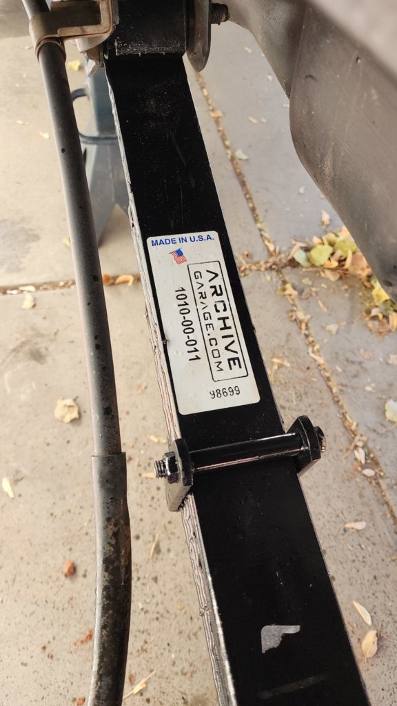

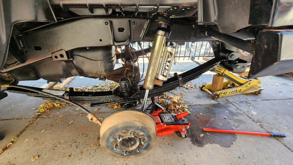

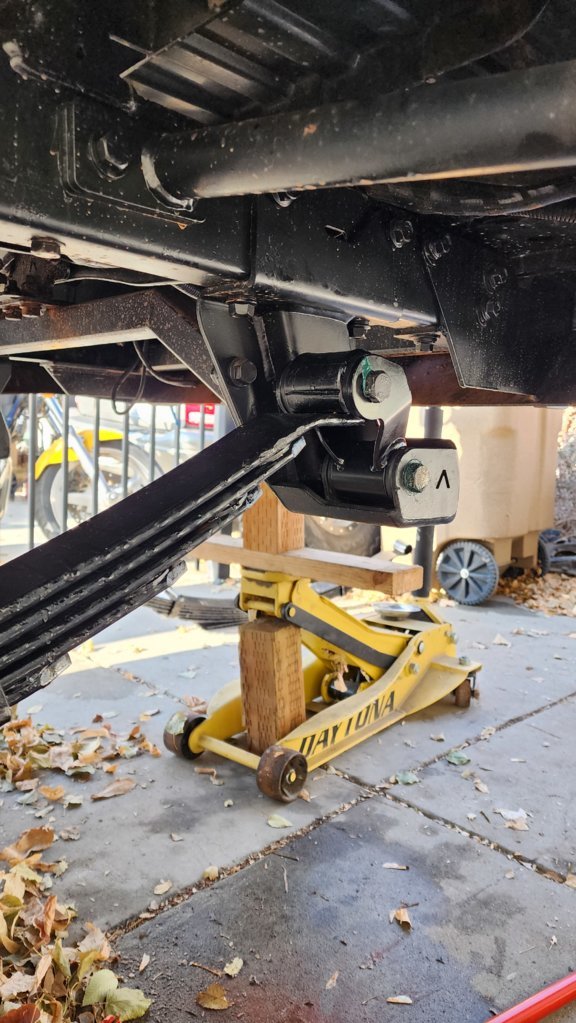

    Just installed Archive garage xd leaf springs. They are replacing the deaver u402 stage 3. These springs seem to be holding the weight better and are rated to just over 1700 lbs of extra weight. I will do a follow up once I have a chance to do some offroad testing.

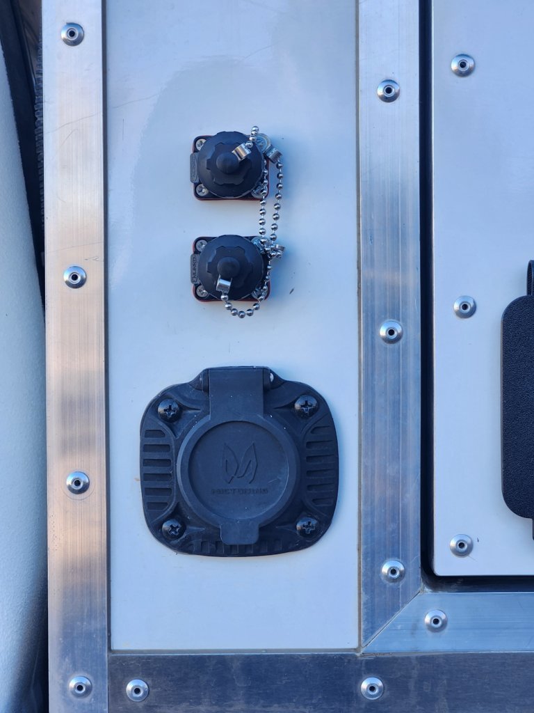

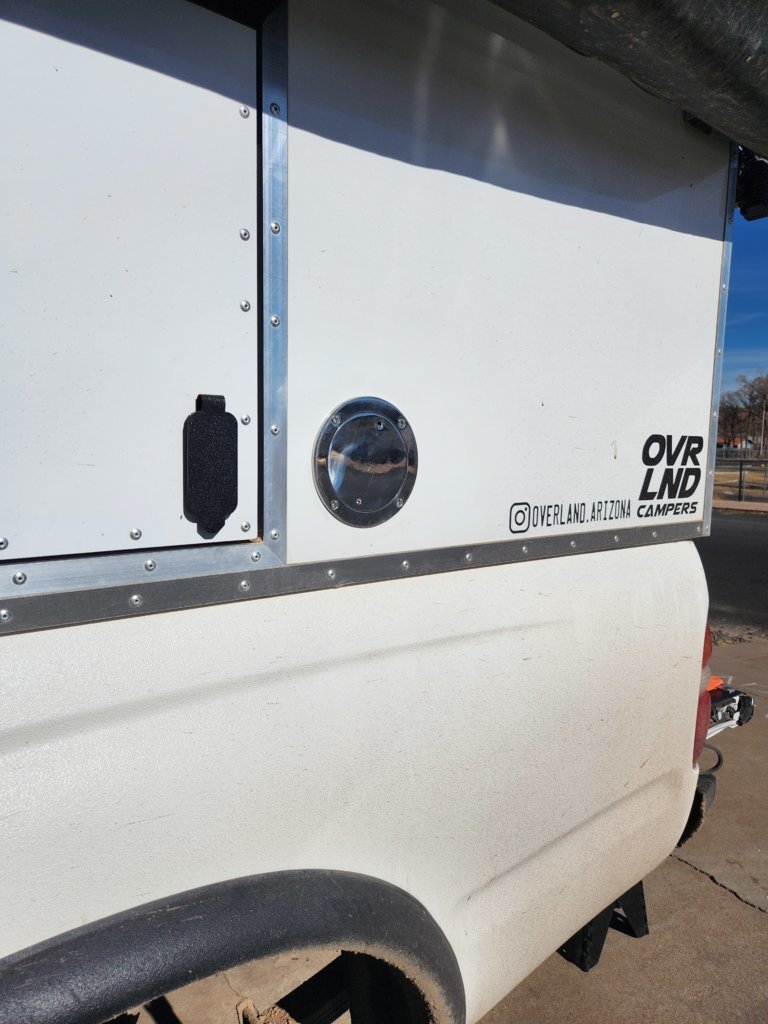

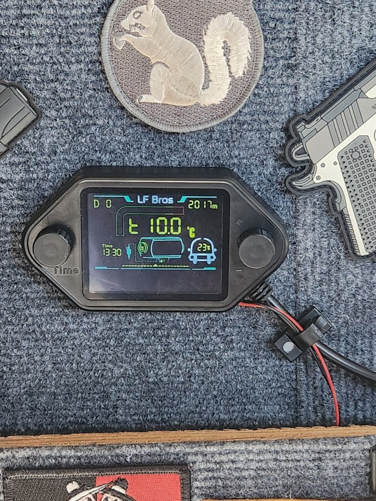

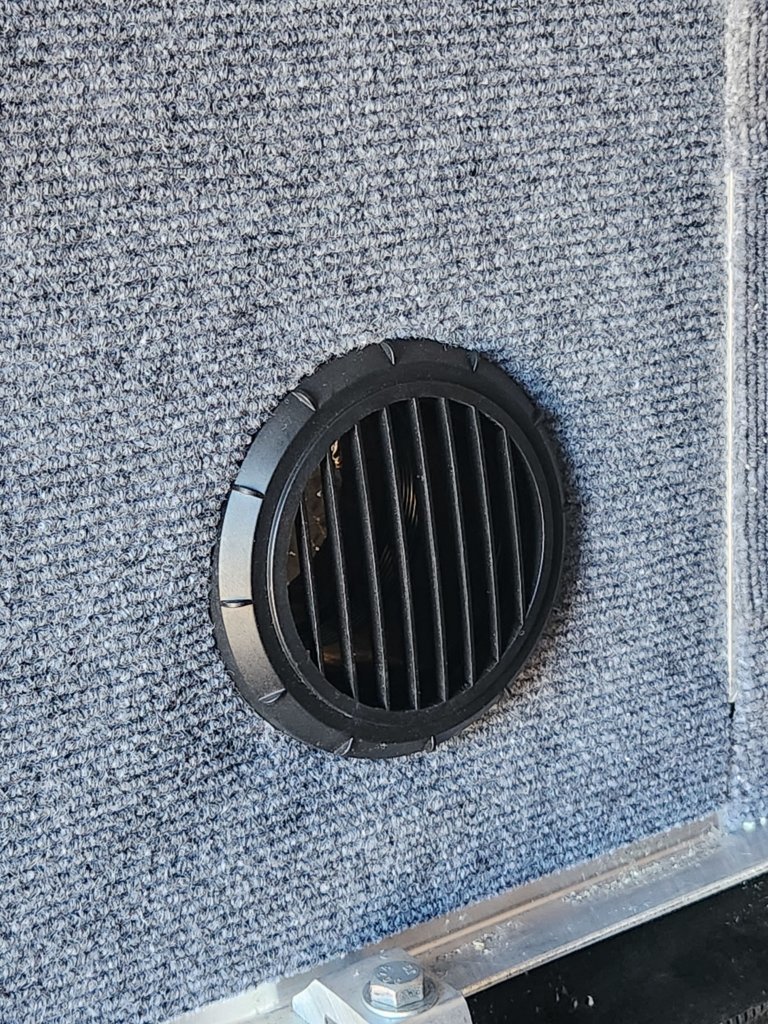

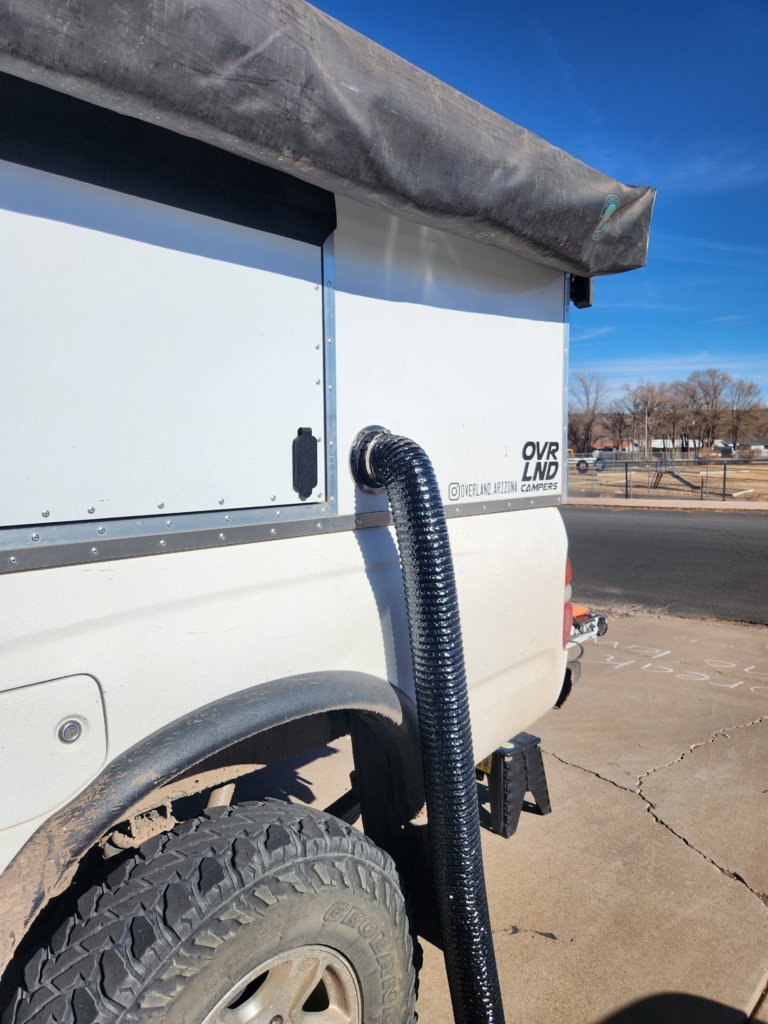

    This page sure doesn't get much love.

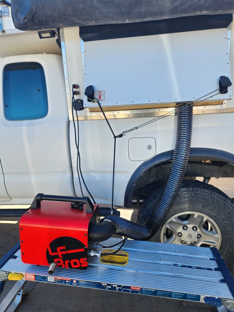

    I have been spending a little more time camping in the cold this year. So I purchased a diesel heater off Amazon and put it to work.
    Played around with my heater today. I cut both the power and control cables. Added twist connect fittings. Drilled and mounted the surface mounts. Ran new wires, and gave it a test.
    Everything worked great. Tested the thermostat setting, seemed to work just fine. The burner shut down when the temperature was reached. The fan slowed way down, but stayed on. Then the burner would reignite when the temperature dropped.
    I was able to get out and test the heater with temperatures in the teens and single digits. Even on low, it kept the camper at about 56º F all night. It burned a little over half of the fuel tank.
    It isn't easy cutting holes in the side of an expensive camper.
    But I feel this is a better answer to my heater ducting solution.
    So before I took this heater out to test, I used it to heat my garage for two days. I discovered that it burns less fuel on high than it does on low. But high would run you out of the camper in a hurry. I am very impressed with how well this little heater works.

    very interesting note. i haven't heard of this in any other reviews. i'll definitely be keeping an eye on mine.

    I was surprised that it burned so much fuel on low.

    i am as well, and just in discussion, it really doesn't make sense to me. it's a very simple diesel fuel burner. it should be dosing less fuel on the lower settings. maybe it just keeps the dosing the same and changes the combustion speed instead or something.
