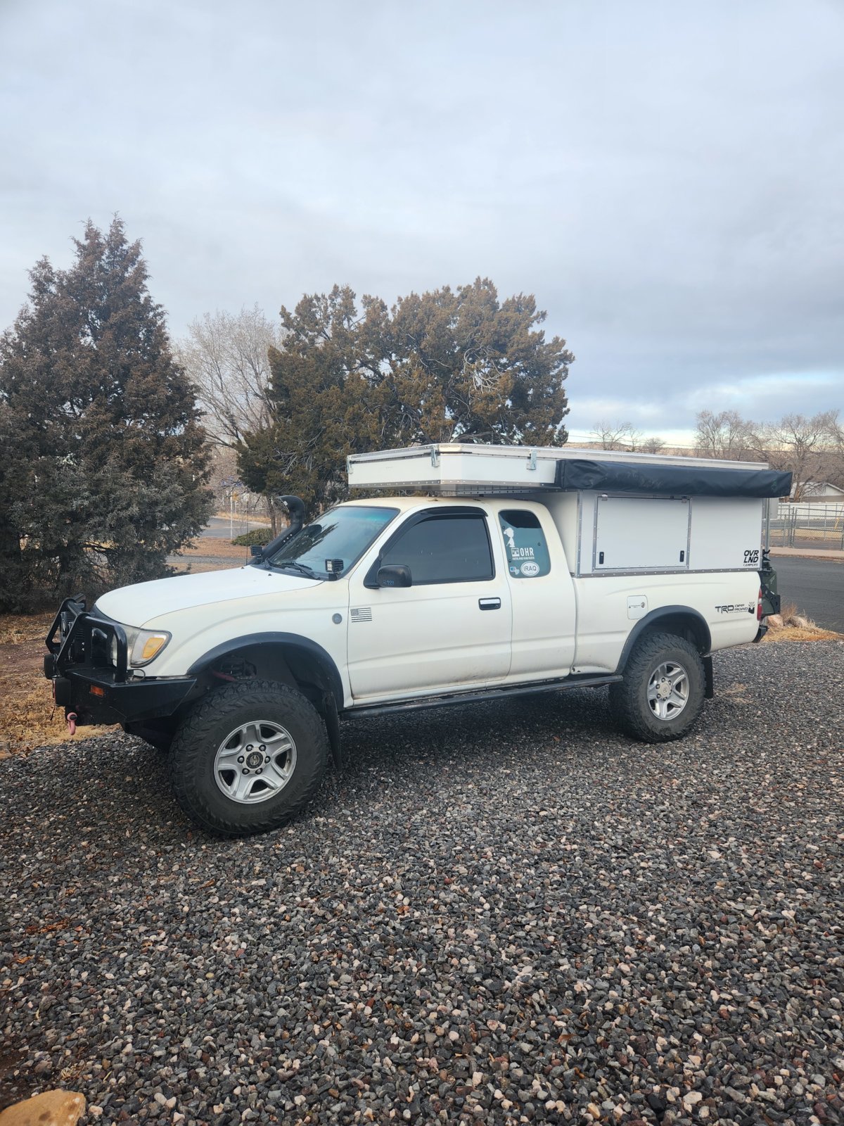

    That's a sweet AC 1st gen you got there!

    Dave: that rig looks great, love to see an access cab with a ovrlnd. Picking mine up in a week, excited.
    I saw in an earlier post you had racks on top, do they at all interfere with the fan? Planning on keeping my surf boards on racks and was wondering about the fan not being able to pop up.

    I honestly can't remember how much room there was between the cross towers and the maxxair cover. I'm pretty sure you could at least crack it open a few inches for ventilation though.

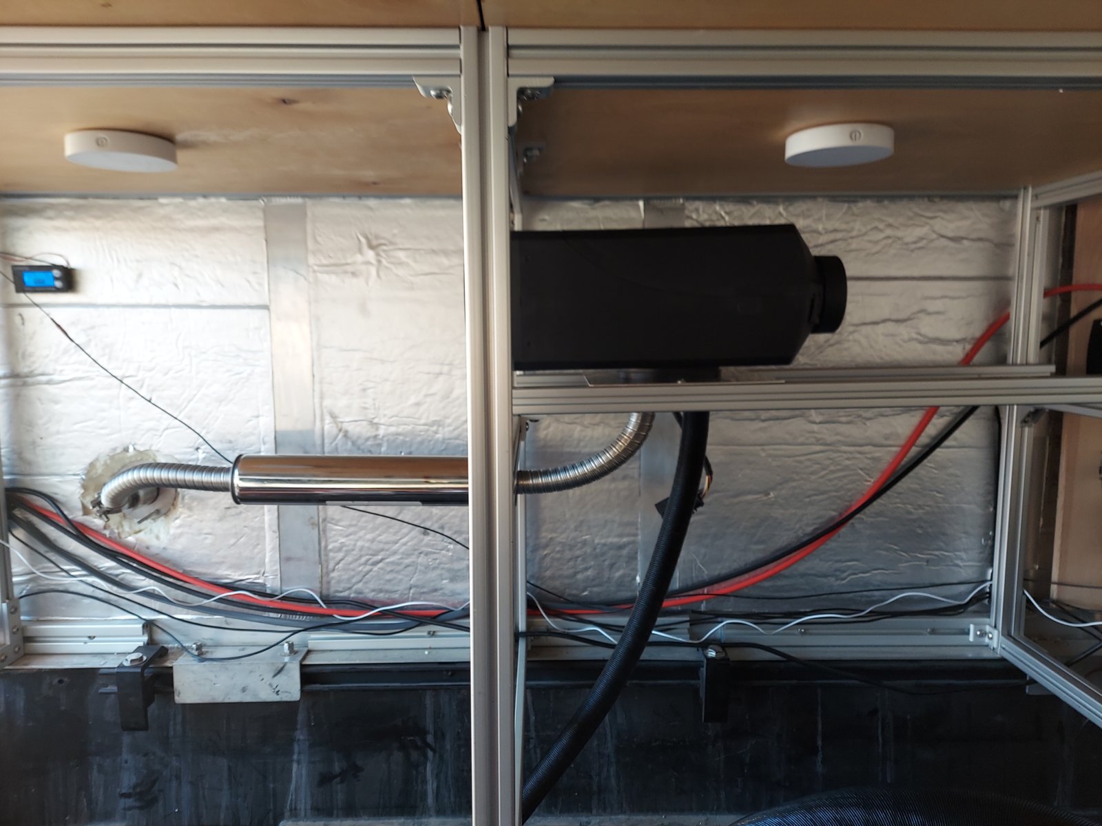

    @Dave-rass Any pics of how you ended up installing your heater? I see the exhaust fitting on the side of your camper there, wondering how you did the inside

    This is the only picture I have and it was right after i got it installed. :) IGNORE THE WIRING MESS. HAHA.
    They tell you not to install these this way because if you mess up (if your exhaust leaks) you can die, but they also install these in marine applications so i figured id give it a try. So do this at your own risk.
    The exhaust is a marine exhaust and is not the same that comes with your heater. It is specifically designed for yaughts/ boats.
    I used some hight temp gasket sealer and some exhaust wrap. It has been running for 2 years with no issues. It has been really great to have.
    I also use a carbon monoxide alarm and smoke detector. Also keep a fire extinguisher in close proximity.
    I wouldn't try this with a knock off heater for what it's worth.

    Thanks for sharing that! Not sure what I was expecting, but that exhaust setup def wasn't it!!

    I do appreciate you posting that and the idea of the marine exhaust - was something I had never heard of.

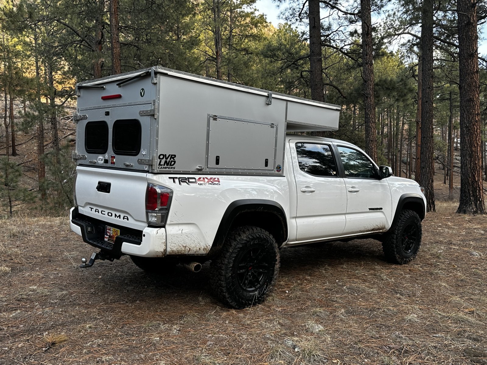

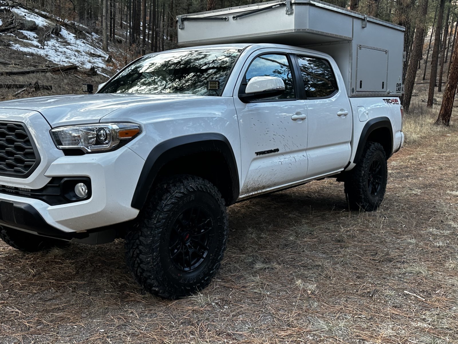

    Just a couple
    Hello,
    I am trying to raise some funds to help my daughter go to school. If anyone is interested I am asking $13k.
    Options:
    *Barn doors with dual windows - excellent visibility
    *Silver powder coating (no maintenance)
    *Clear vinyl windows between netting and canvas
    *2 flip up side hatches (drivers side and passengers side)
    *Maxfan Deluxe (2 way)
    *Sliding window to cab
    *Insulation/headliner
    *Extra bed height
    *Gas Struts/C-clamps
    *Positive pressure vent that pressurizes cabin as you are driving (keeps out dirt and works really well)
    Like new condition. 275 lbs - crazy light.
    Send me an email to ajsaunders@hotmail.com for more info.

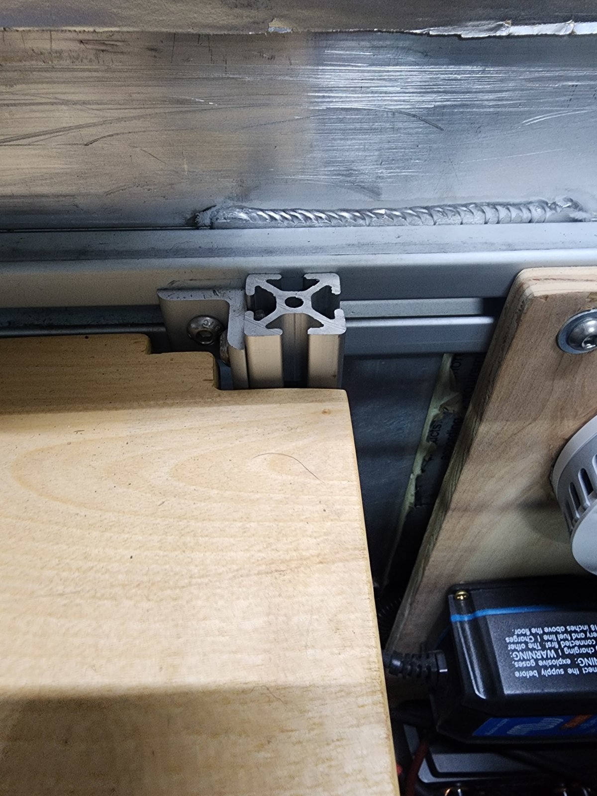

    What is everyone using for cable management at the hinge point?
    What hardware works for the channels supporting the bed?

    I'm just using some wire loom and zip ties.
    There are lots of choices for hardware.
    I have attached a photo of the hardware that I used. Amazon and tnutz are good suppliers of all things hardware. Depending on what you are doing I would just order a few different sizes of hardware and see what works best for your application.
    Here are a few of the items below. I couldn't find all of them but this should help.
    (QTB-010-K) 10 Series Quarter-Turn, Drop In Stud – 1/4-20
    (CB-010-B) 10 Series 2 Hole Inside Corner Bracket20240215_201418.jpg 20240215_201544.jpg
