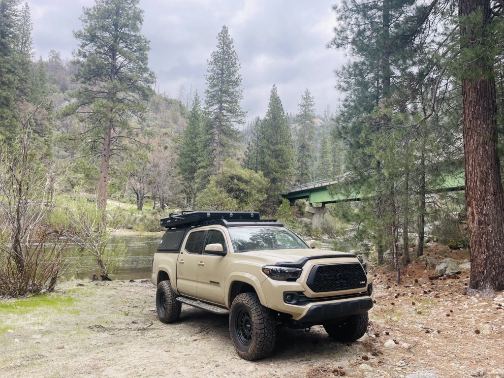

    Installed mine exactly one month ago. It's been raining where I live. I didn't notice the inside of the bed getting wet at all. I imagine if I had put on more Butyl sealant tape on the corners it woudl've helped even more. As for offroading/dirt getting in, I haven't tested yet but could imagine it being the same as the rain. The topper so far has been really impressive. I was able to just install it myself by carefully/ loosly clamping on the side panels and aligning perfectly the panels onto the truck bed, and then re-tightened after the initial 50-100 miles. Been driving over 500+ miles with the new camper and no problem at all. I checked after driving 300 miles and only one clamp was slightly loose which I re-tightened. Like some of the other folks have said, with this modular design you can switch out with the different panels coming Q2 of 2025 (panel with side window, sliding rack, storage shelves, +more).

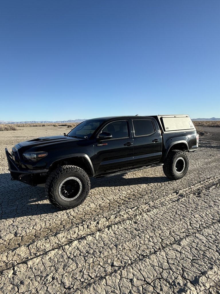

    Any one done anything to keep it cool inside the cap? The OBS top has almost no vents, it gets way too hot for the dogs. Trying to figure out how to vent more air in the shell. Any ideas?

    You can paint or wrap the top panel white or silver (assuming you are not willing to wrap the whole thing). The metal will still radiate a ton of heat inside, so use some double-sided tape or spray adhesive to install panels of rigid insulation anywhere inside you can stick them. Both of those will bring the internal temperature down perhaps 20°, but that’s still not cool enough for dogs.
    Finally, you can put a standard 14x14” RV roof vent in the top panel. You can do a passive vent, but I recommend wiring it; you have several fan options from reputable companies (like Dometic and Maxxair). I use a Maxxair on my camper and it moves enough air that I can cook salmon in the back and go to bed without my bedding smelling like fish. And it keeps the interior the same temperature as outside (with insulated ceiling and walls), meaning I can sleep in during the summer after the sun rises.
    Edit: if you are not willing cut a hole in your top panel for a fan, consider installing sliding windows on the side doors.
