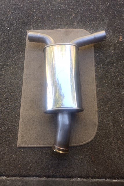

    URD has a new part for their spec U. At the “y” there is now a plenum chamber.

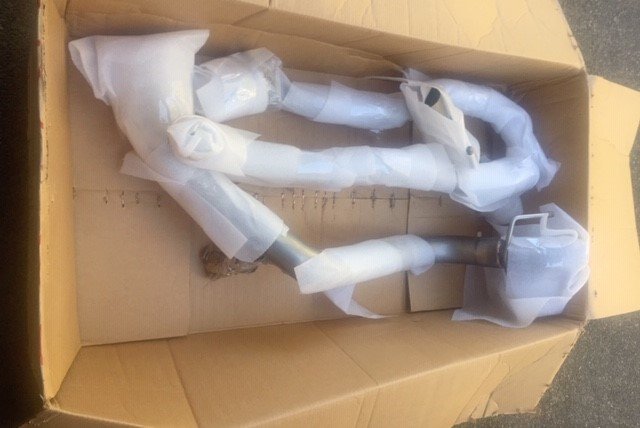

  11. Feb 21, 2020 at 9:16 AM
    #271
    jomopdx
    jomopdx Well-Known Member
    May 30, 2016
    #188267
    279
    jomo
    2016 Tacoma Sport
    Below are three photos: 1) the "plenum chamber"; 2) box of mostly unwrapped Spec U components; and 3) the shipping box.
    All for sale - $995. I've decided not to install. Pickup in Portland Oregon only.
    CanadaToy[QUOTED] likes this.
  12. Feb 21, 2020 at 9:29 AM
    #272
    su.b.rat
    su.b.rat broken truck
    Jul 30, 2016
    #193316
    9,874
    gawd. they band aided it? ugh

    what’s this do? Lowers the volume?
  14. Feb 22, 2020 at 8:30 AM
    #274
    jomopdx
    May 30, 2016
    #188267
    279
    jomo
    2016 Tacoma Sport
    Well, you can call them and ask but what I gather is that it solves some noise problems due to small failures at that point.
