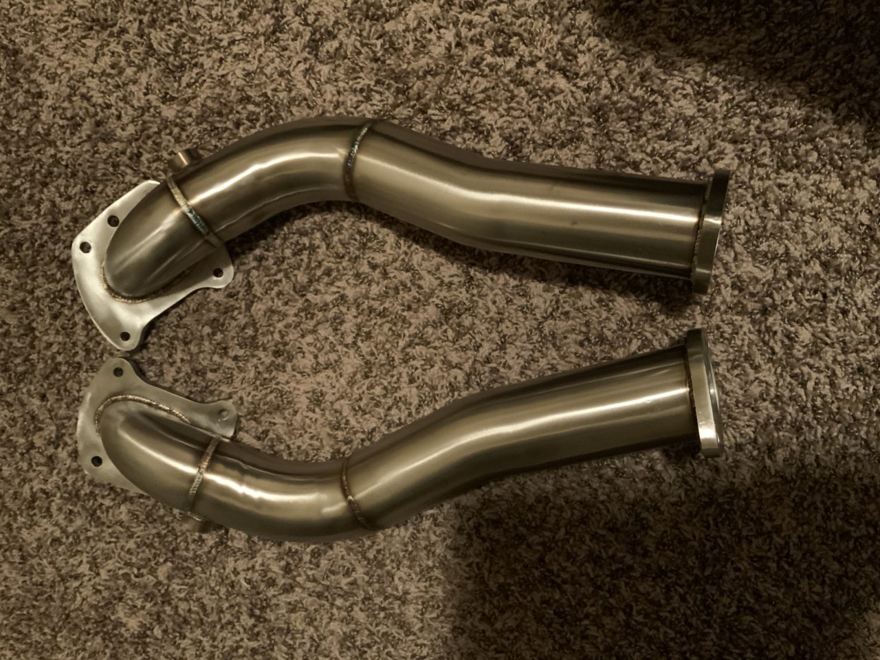

    Got these today now to get them installed.
    tater taco and Gtdznts like this.

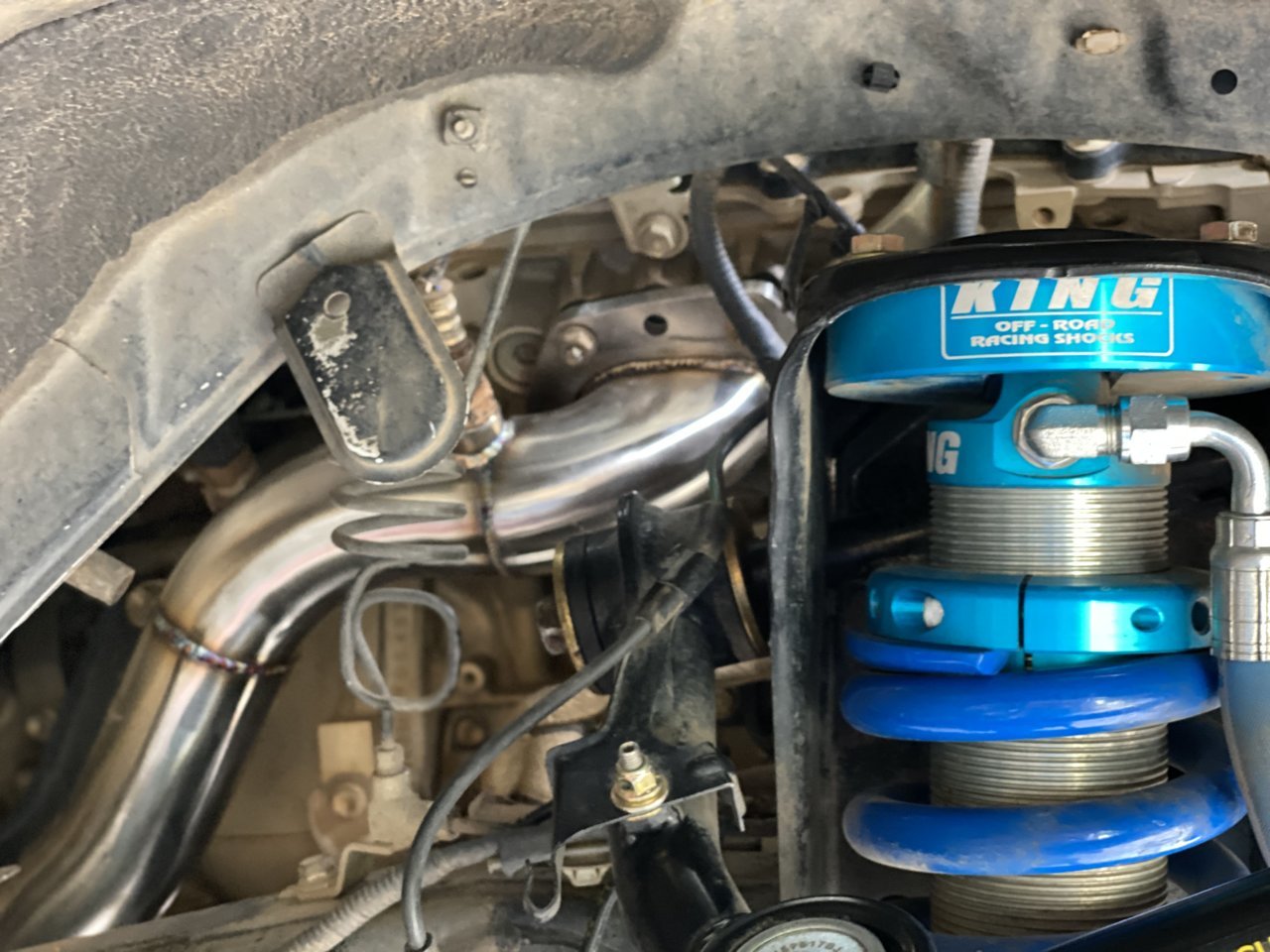

    Go them installed yesterday after the test drive I noticed a small leak. Took care of it this morning sound good so far haven’t put too many miles on yet. I like the start it’s a little louder. Plan
    To take a drive later. So for intake I have the snorkel then HPS intake tube.
    rlx02, skyking3 and Gtdznts like this.
