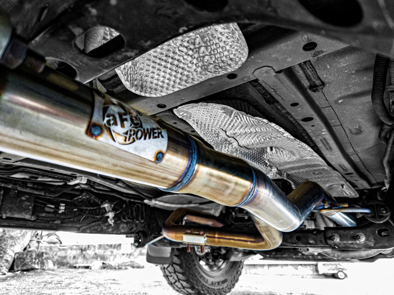

    I thought you went with the aFe ypipes?
    I installed my ypipes, and I personally like them better than the URD mark 2 Ypipe. Also no more clearance issue.

    #394

    Nick

    For me, the pipe from the driver side would be too close to the transmission's crossmember, could barely fit a finger in between.
    Now I run aFe ypipe, to Borla ProXS to dual exit resonated exhaust tips.

    I like it, much better than the ricey sound when it was the URD paired with MBRP and dual resonator tips. Much less boomy than the URD paired with Borla and dual resonator tips.
    aFe with Borla and the resonator tips is like a good in between. I have not tested it without the resonated tips though.
