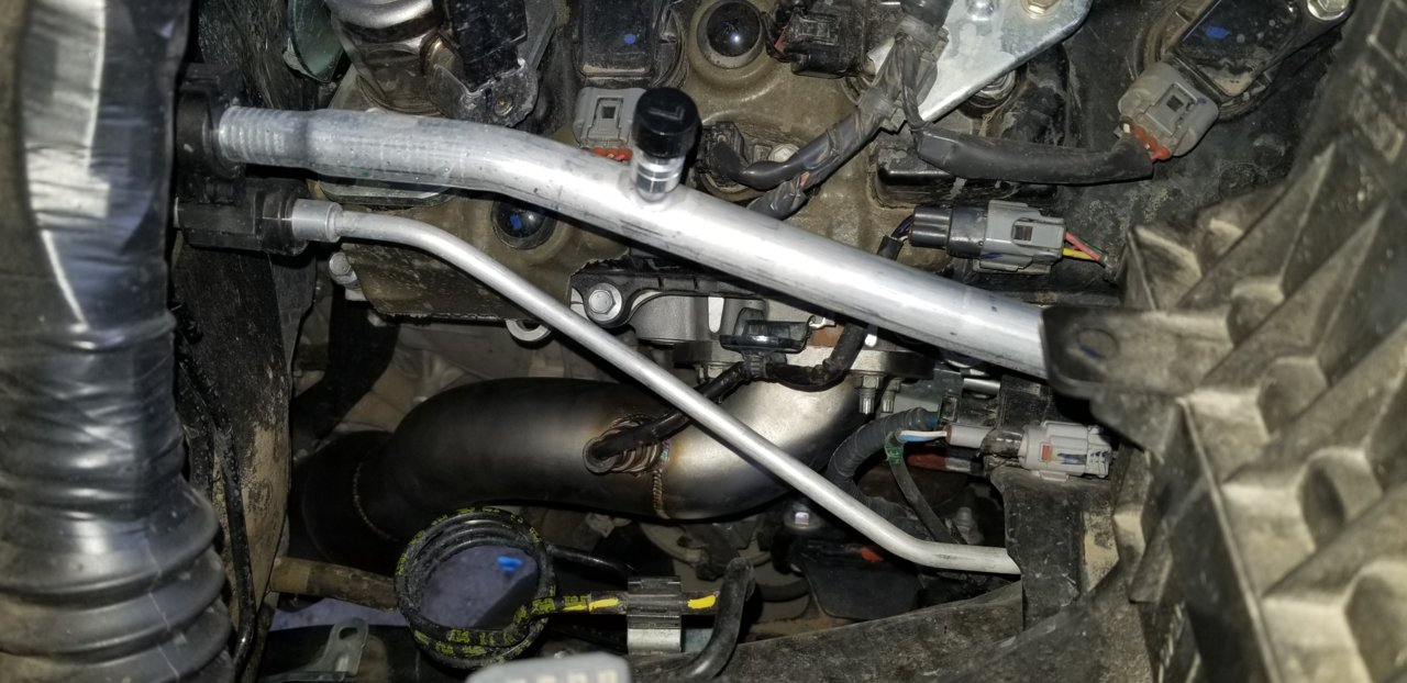

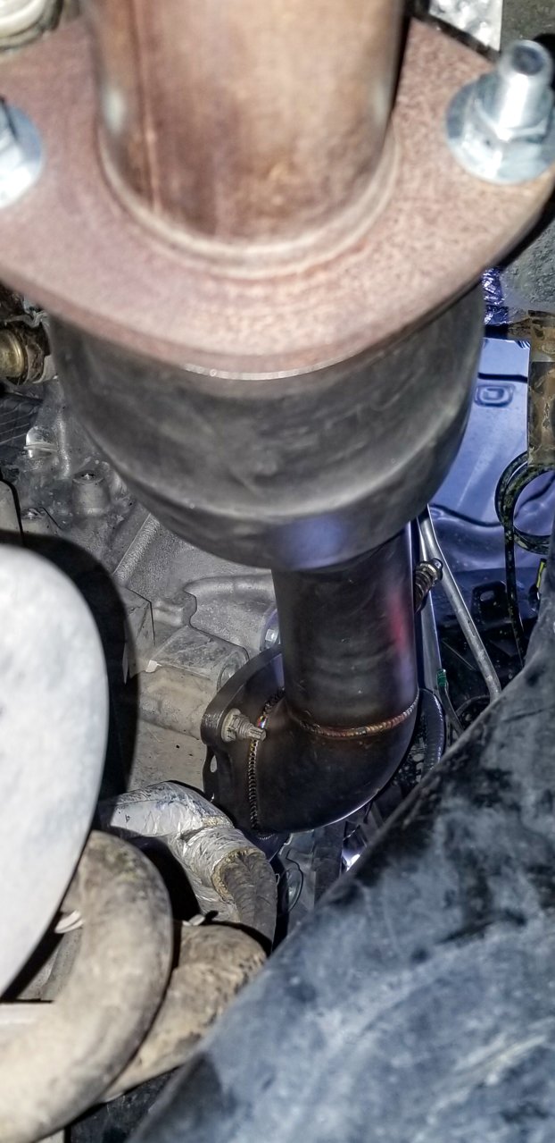

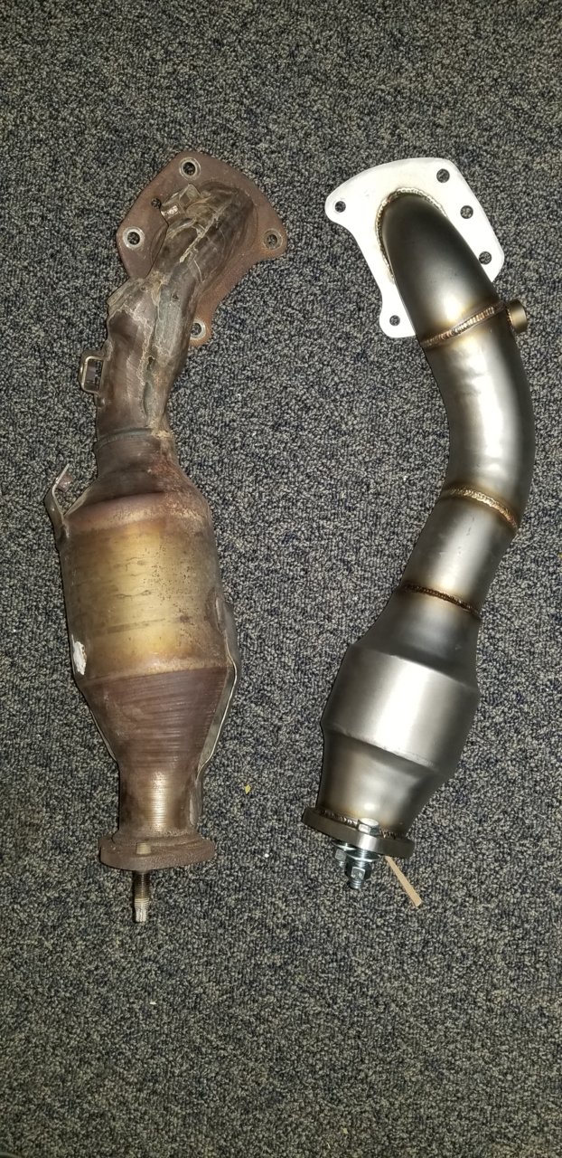

    Got them on... vids to come since it's late. First impressions... sounds better, flashed the 91 performance catted tune (04A61) and NO CODES! Can't judge on the short test drive I took. I have spent a limited amount of time driving since I flashed the TSB, the new beta 2.0 and now this new setup too. All I can say is I like it. May have a small exhaust leak but it doesn't smell in the cabin... yet. I have been under the truck most of the afternoon so I can't make a good judgment call right now. Does anyone know if new parts just smell slightly for a bit (outside cabin) as they break in? Also, swapped the manifolds with the truck on the ground by myself... it can be done just takes some finagling with a cardan (double?) socket piece, an extension and drive speed handle (and a lifted truck helps).
