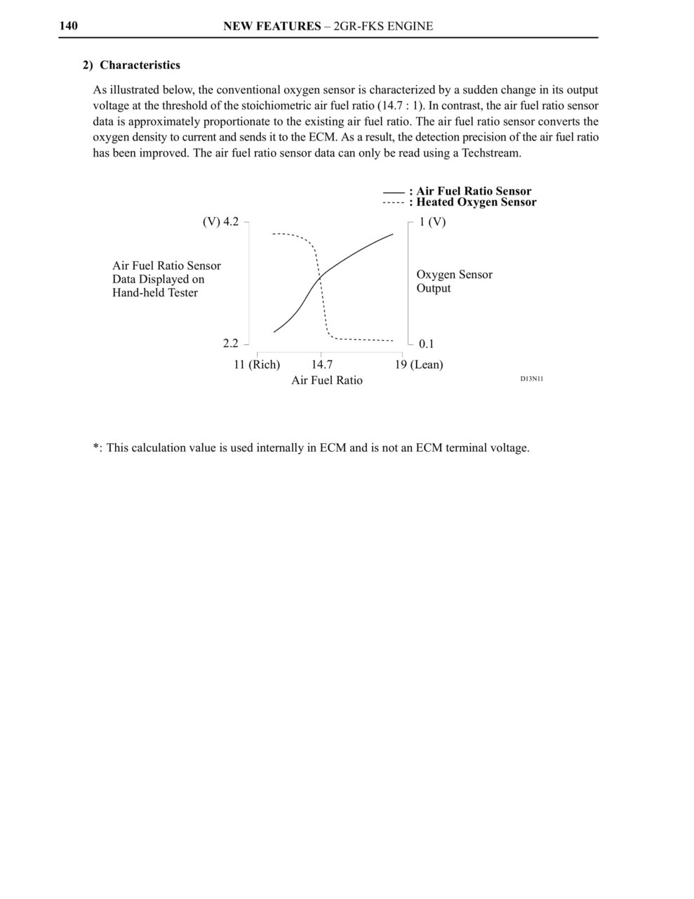

    @Phich thanks for passing along the info about Copper RTV. Have my driverside (bank #2 Sensor #1) O2 sensor put back in with RTV and didn't apply any (used copper antiseize tho) when I removed/replaced bank 1 sensor 1 (passenger upstream sensor) for the second time. Code P043000 (bank 2 cat threshold not met) has not been thrown since I put RTV on threads of B2S1. Code P042000 (bank 1 cat threshold not met) has been thrown consistently since installing new catted manifold (dump tubes). About to apply RTV to bank 1 sensor 1 and should be good to go (will post an update). Thank you TW and OVTune...
    Edit: I also found this helpful when looking at sensor data.
