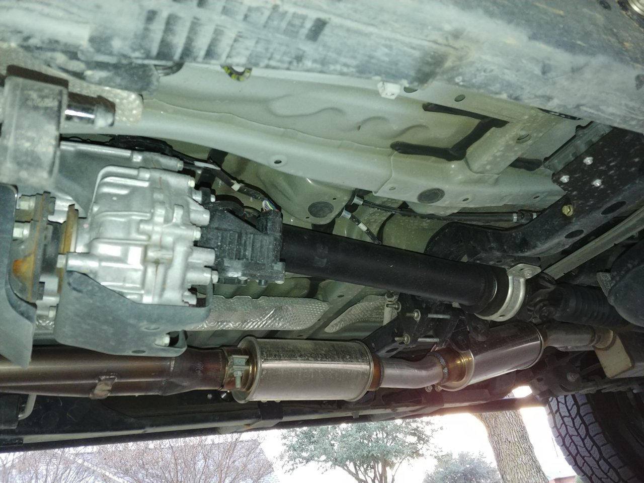

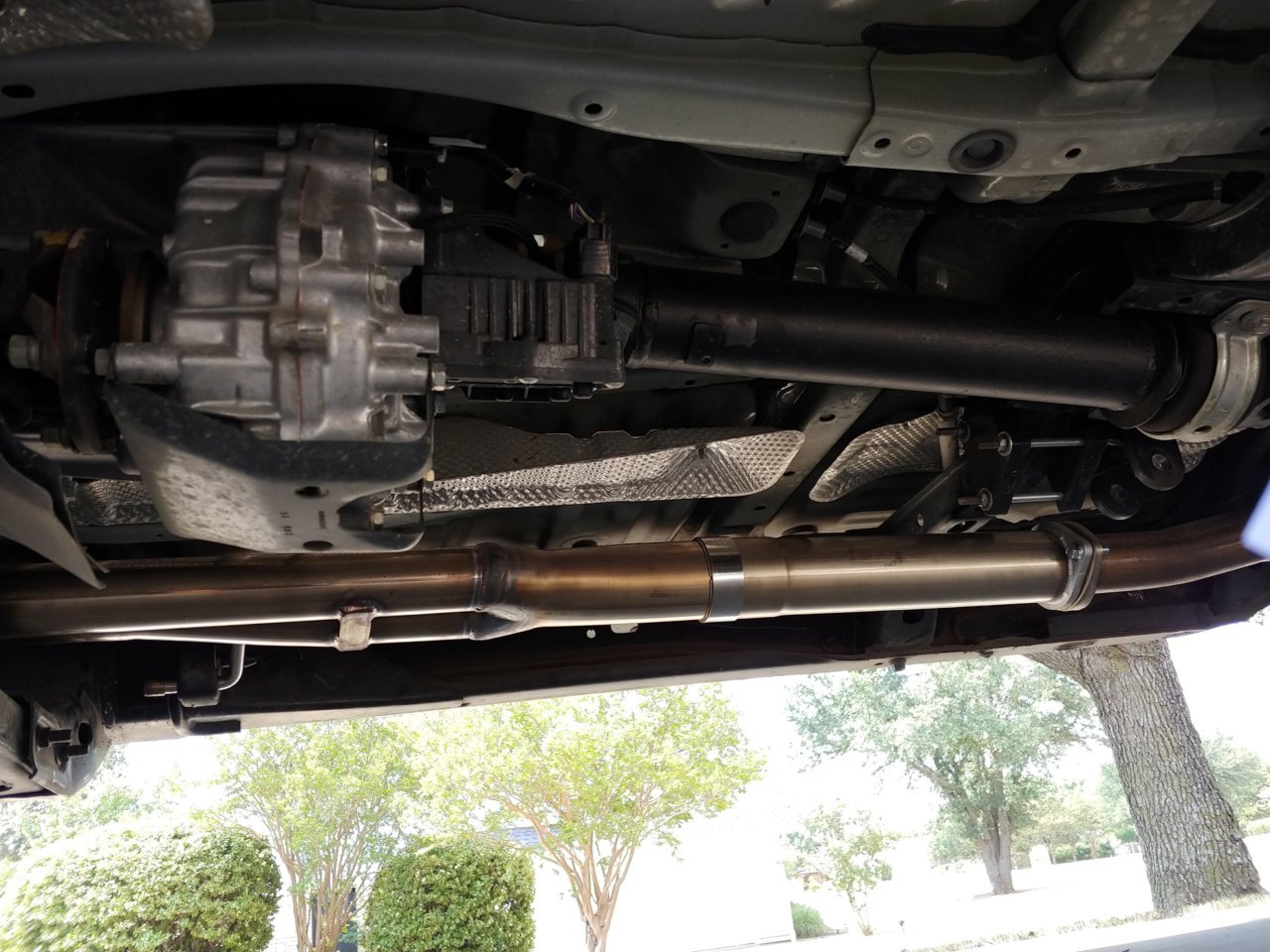

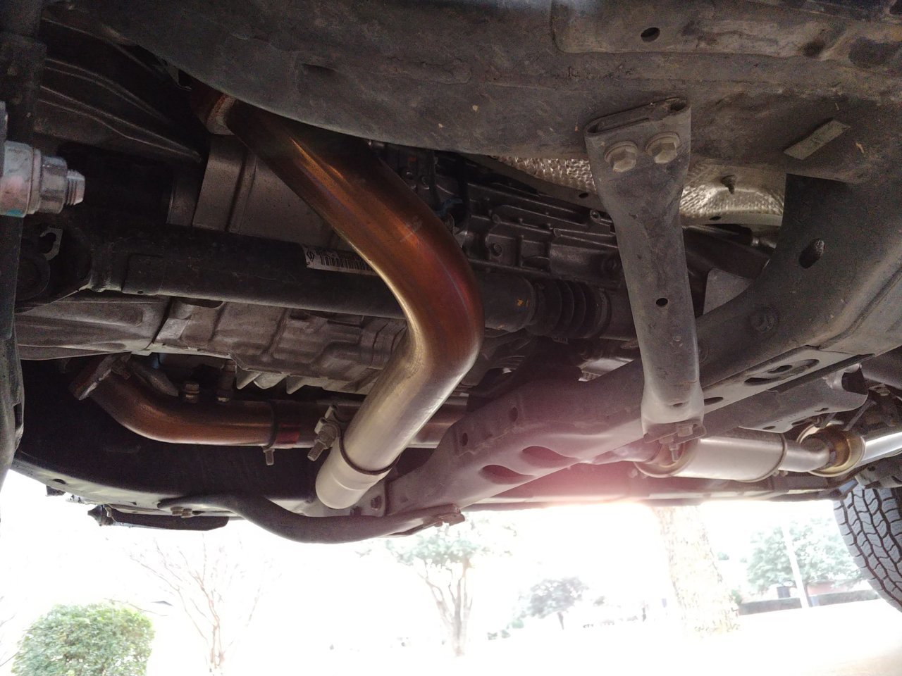

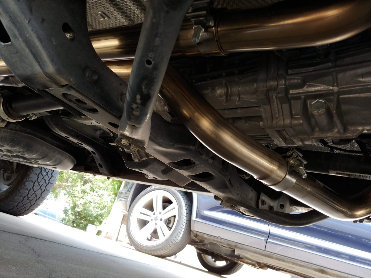

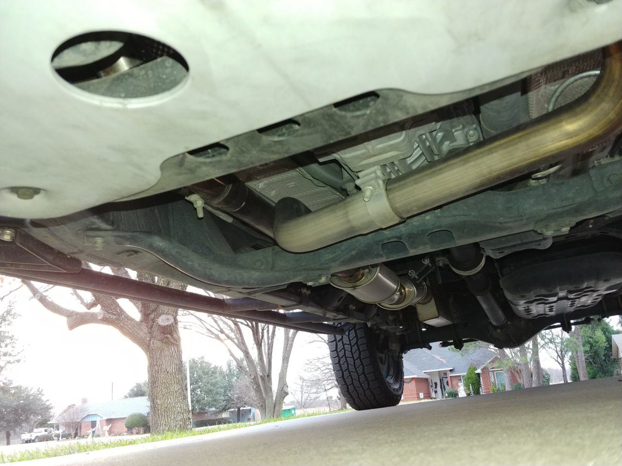

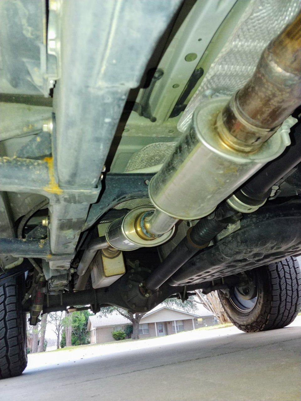

    i am telling you man, the right exhaust on this NA motor is the second biggest thing you can do after OVT. go for it. most don't know the difference because they aren't willing to tear it all out and start fresh. any aftermarket catback or typical solution will not wake up this motor for certain, just some sound and a little throttle bump. but if you do it right the return is big.
    round 3 is coming early next year. I'm about to tear it all out and do it again. these pics are round 2...
    IMG_20181217_170430.jpg IMG_20181217_170447.jpg IMG_20181217_170540.jpg IMG_20181217_170611.jpg IMG_20180804_113220.jpg IMG_20180804_113145.jpg
    currently stock cats (after trying the catless tubes which leaked badly, then got the catted which ii haven't installed), URD mk2 Y pipe, reroute, two 3" Vibrants, a Spintech 3000XL and a J pipe. all of this will be replaced next year with custom tuned solutions. it's a massive performance improvement over stock, but I'm focused on inefficiency from the 3" mid and dual resonators, and i have a somewhat nasal sound, not bad just not my zone. sorry no sound clips atm.

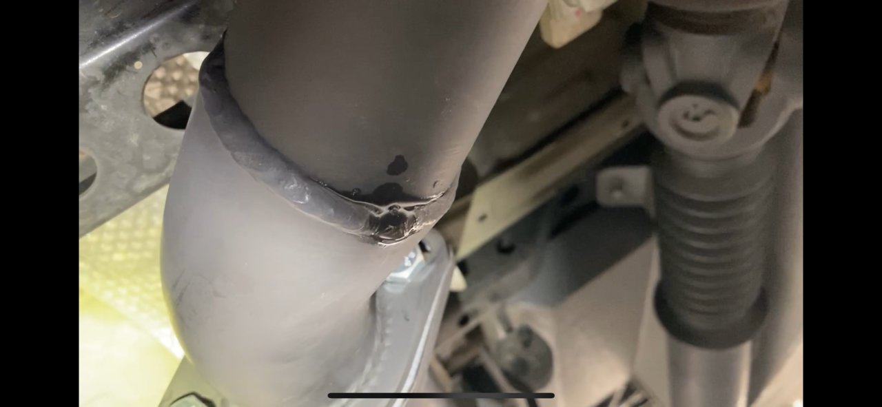

    And It is surprising to see that exhausts from URD, Dirty Deeds, etc are leaking, have leak spots from a hole in the welds, etc. It's a little disheartening for people to try to blame our product when the welds, material and over-all quality its far and above what I have seen posted on here from other company exhausts.
