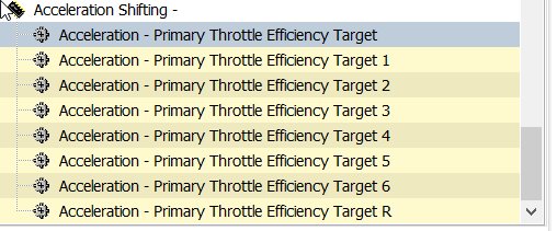

    It seems like the individual gears maps would override the primary (first) one. Then again if each gear has a map what does the primary map do. Bringing me to what is the difference between these files and how do they relate to one another?

    Each of the ones with the numbers is the throttle per gear.
    If you have 2.0 from ovtune then the only one it uses is the first gear map.
    The very first one is somewhat of a gain setting if you will. I have that one as stock except for right off idle, i lowered the numbers a bit too help with over shooting rpms on take off.
    My current tune pretty much only uses edits to those maps, they are the most important maps to edit for customizing the throttle to your individual driving style.

    So with the 2.0, changing the other 7 maps beside the first one does not change anything then?

    Nope. That is @OVTune 's Single Torque Map Patch. Only PTTT nad PTTT1G are functional for us.
