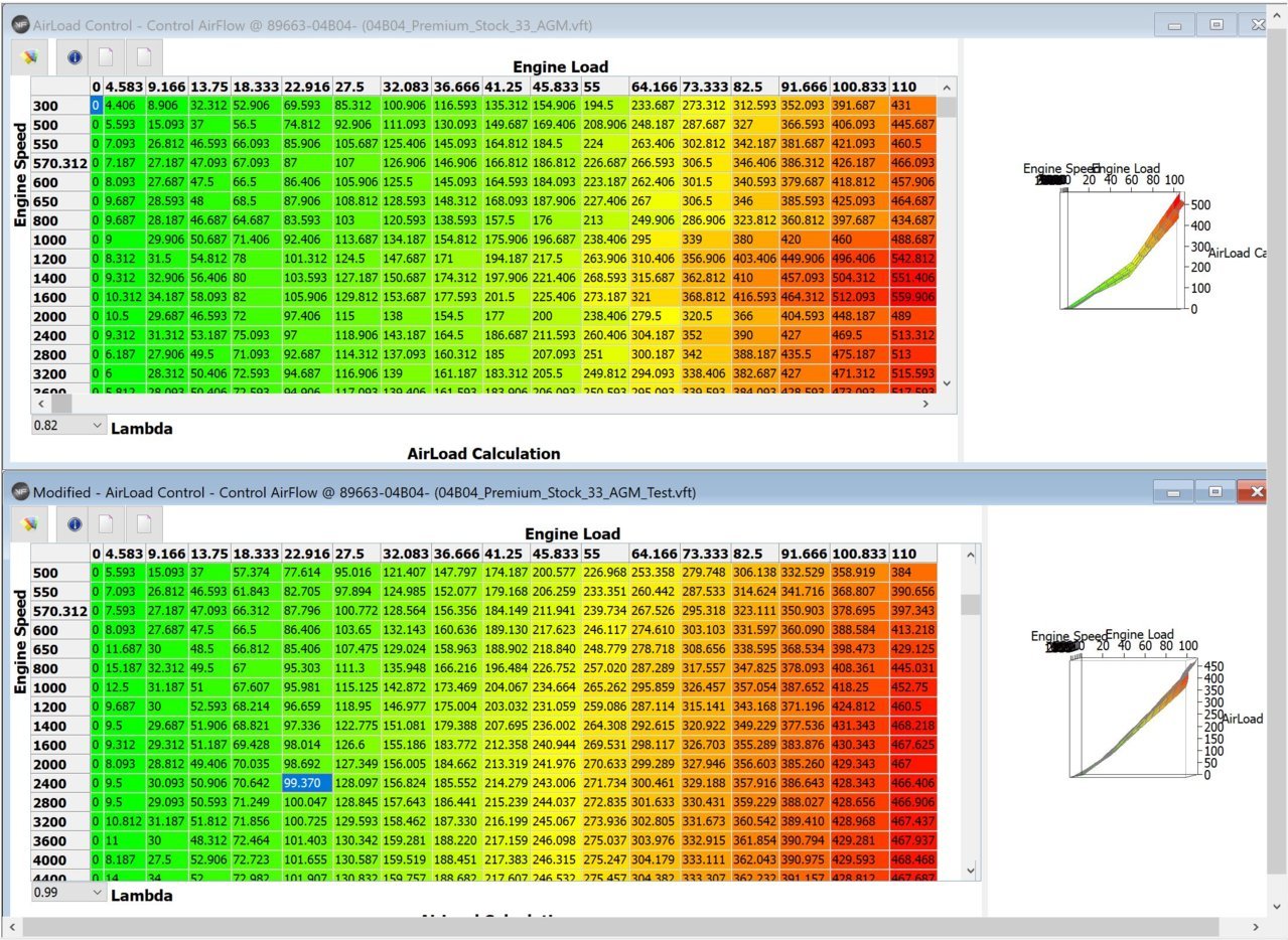

    I'm playing with this smoothing thing for giggles. I see a lot of smoothing at the tops of the charts, which seems to correlate to higher RPM's and Engine Loads. Should we be smoothing the green stuff as well? Is the goal to make this 3D chart as linear as possible, or should we leave some kinks in it? @OVTune

    I’ve been playing with the smoothing and I can make the 3D chart a flat plate if I want and still keep the color gradients in family with original tune. I just don’t know if that’s a good thing or not.
    It’s fairly easy to highlight cells and “CTRL+I” and work in overlapping patterns to totally flatten it out. Target red gradient in top right, some bottom right, some just right to left, etc...based on what the stock file was doing. I just don’t know if that dip early on is beneficial.

    Just for show and tell. Mat's 2.0 Premium Stock 33 non-THX on top, modified on bottom in both images. I tried to take out the sag in the lower end of the charts. I did this for both the 0.82 and 0.99 maps on both Control and Expected maps. Will this make the truck more snappy and sensitive to throttle inputs? Will it lower my MPG's by adding more air/fuel? Help us @OVTune, you're our only hope... What can these magnitude changes do to the truck? Suppose I could flash and test, but I'm chicken and my truck is my daily driver...

    I think I did too much. It redid it and mostly kept to the upper end. Much better.

    I think I went too far. So, I put both versions up for comparison. The second version seems very nice.
