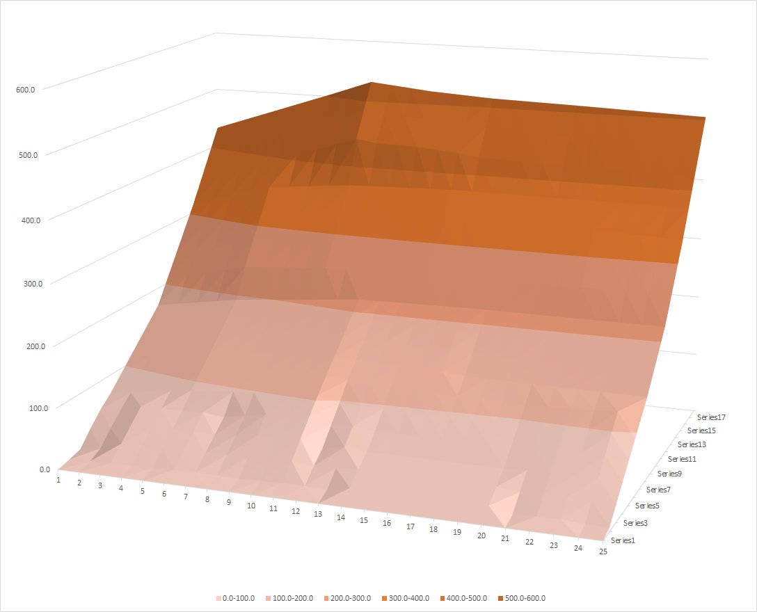

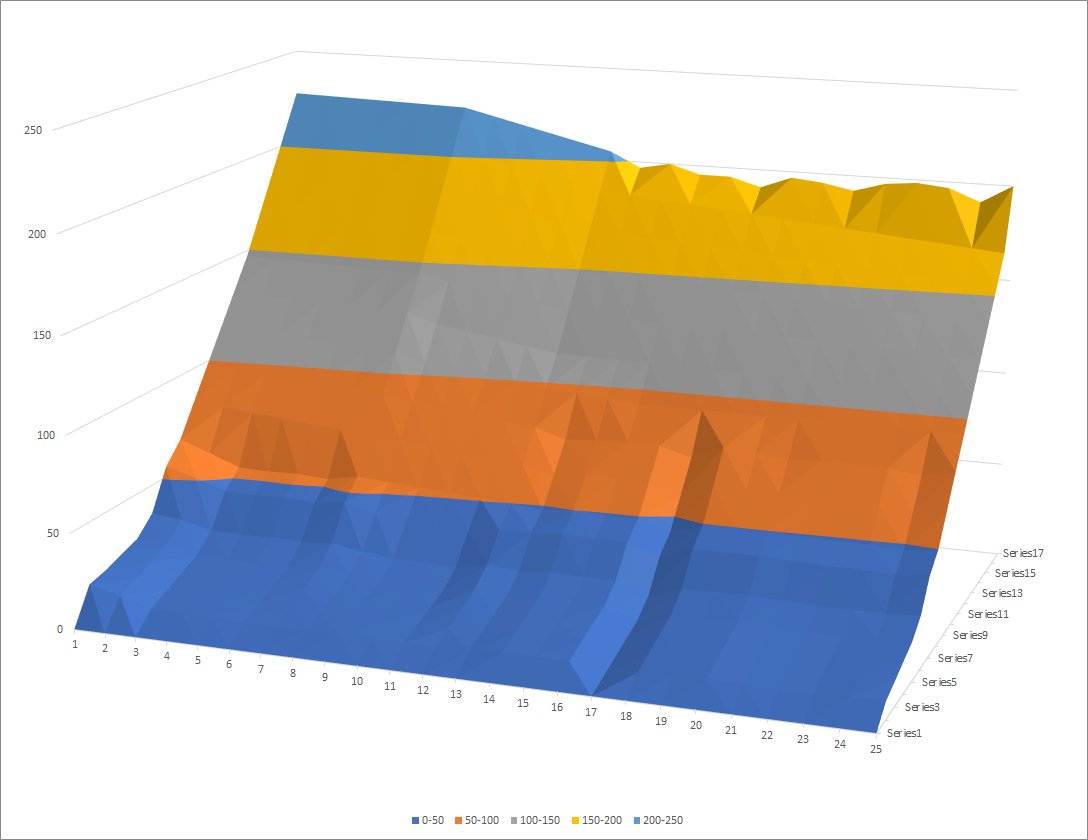

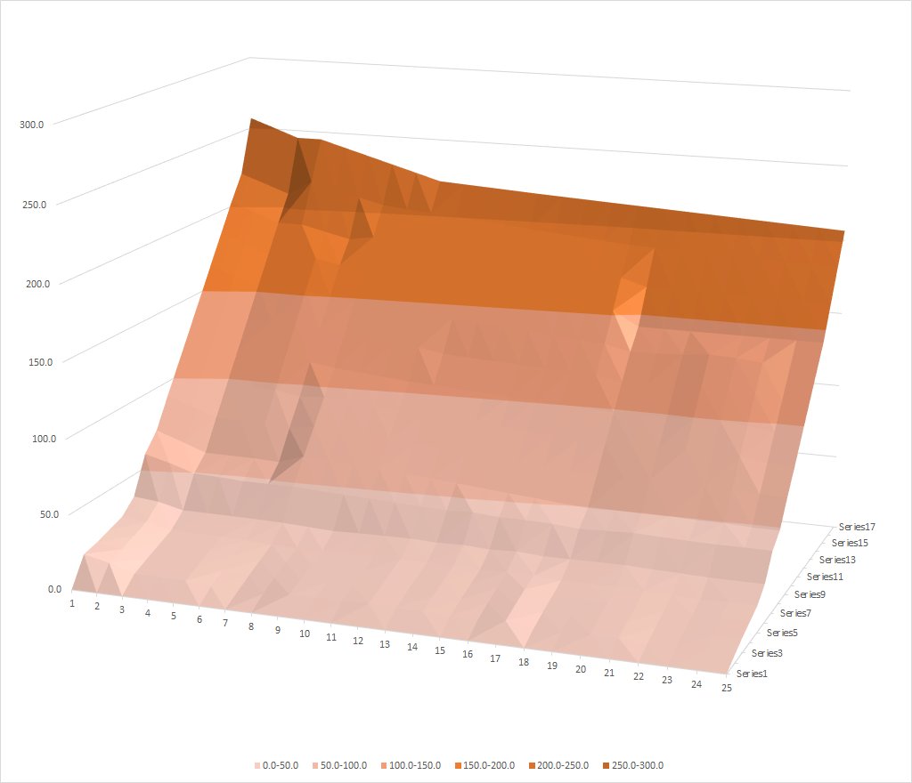

    I was thinking about how to better visualize and smooth the maps . . .
    In Excel:
    -- Select the data
    -- Go to: Insert / Chart / Surface
    -- Click Okay!​
    I'm not too worried about axis labels at the moment. More about smoothing those puppies.
    To move it around: Right click on the chart and pick 3D Rotation. :cheers:
    04B04 Example tune
    Air Load Control - Control Airflow Lamda 0.82 and 0.99 maps:
    Air Load Control - Expected Airflow Lamda 0.82 and 0.99 maps:

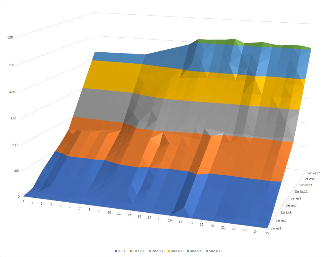

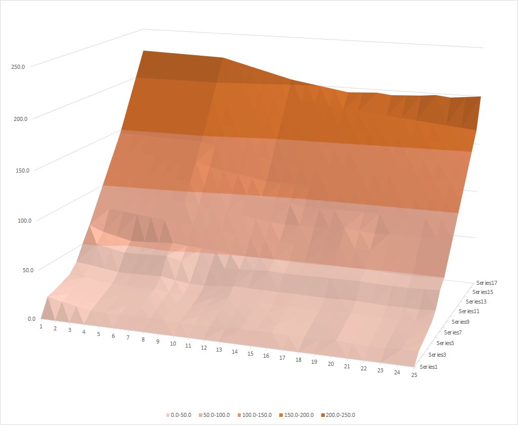

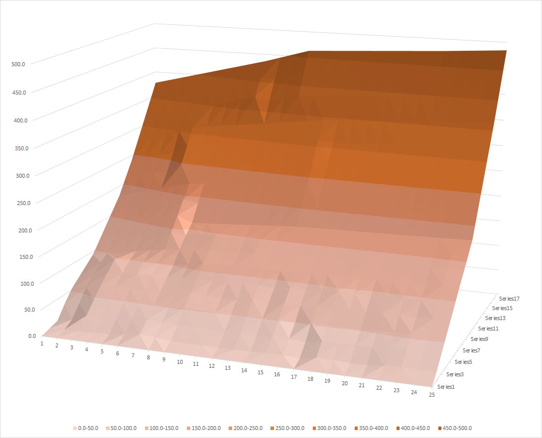

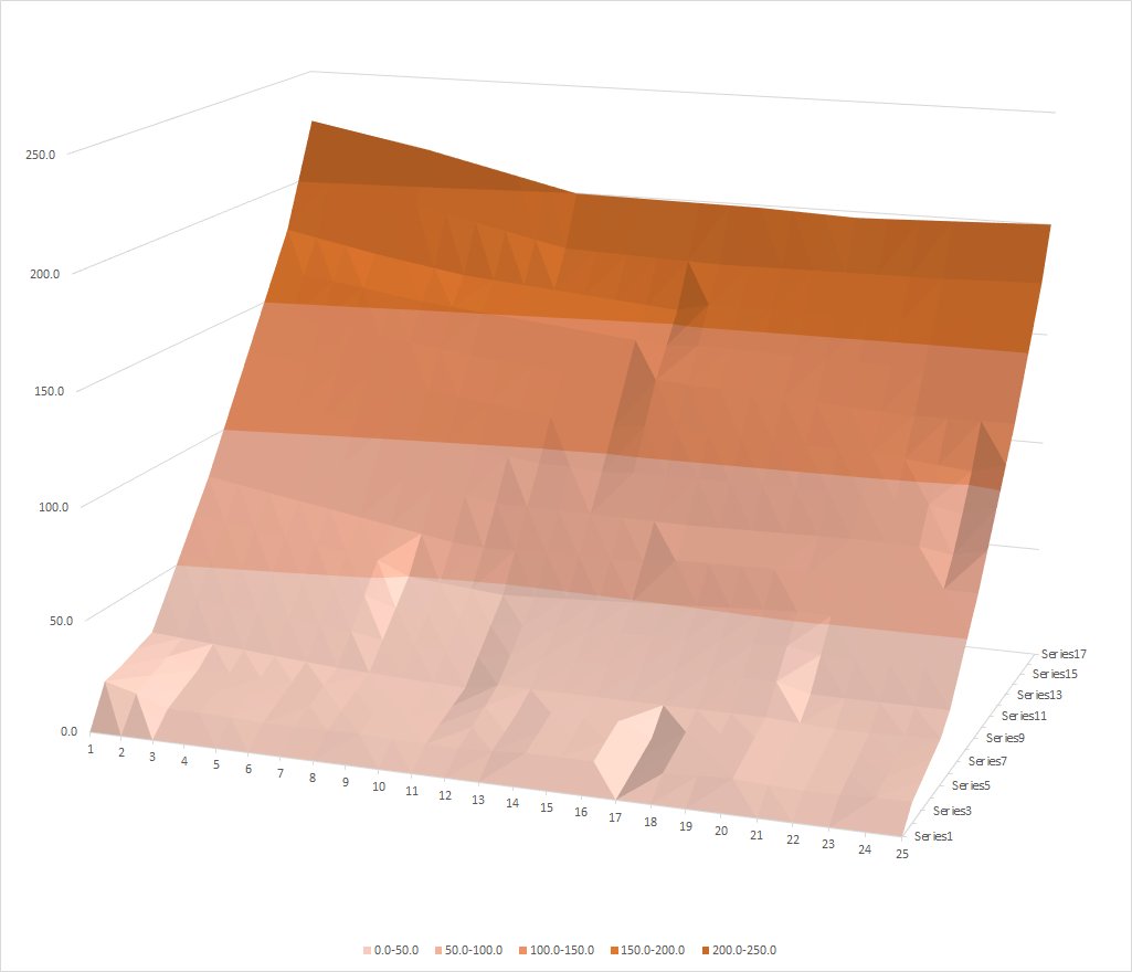

    I made a Thread Title edit since Air Load Control seems more accurate?

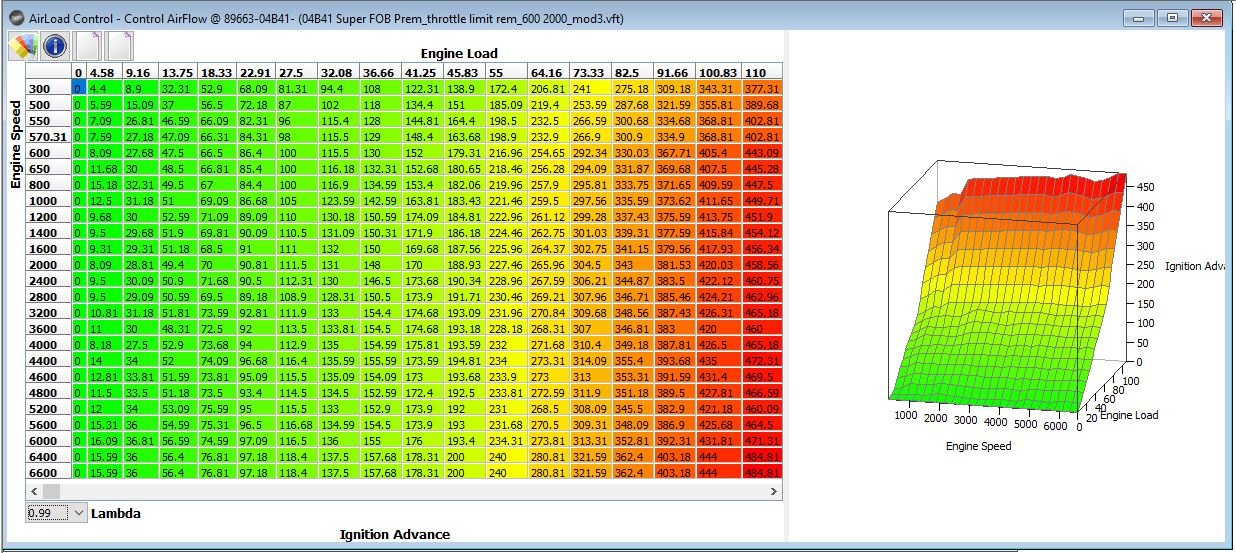

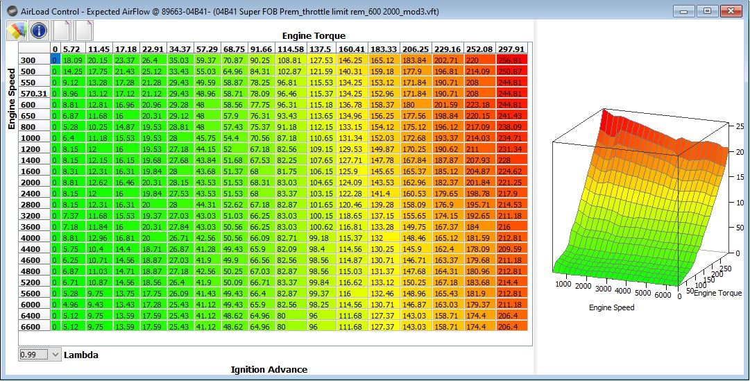

    Also, the 04B04 Example maps were gnawing at me, so I got to it and will give these a try. My 04B14 edits look rough in comparison. Both files are attached.
    I will be loading the first four maps on the 04B04 file into my existing tune. OVT's 04B04 Example maps are the second group of four.
    And, I will test the revised High Idle settings (all at 900rpm).
    Crossing fingers that there is at least no rocky throttle / heavy tip in.
    Smoothed 04B04 Example Control Air Flow 0.82 and 0.99:
    My V2 0.82:
    My V2 0.99:
    Smoothed 04B04 Example Expected Air Flow 0.82 and 0.99:
    My V2 0.82:
    My V2 0.99:
