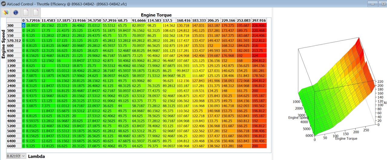

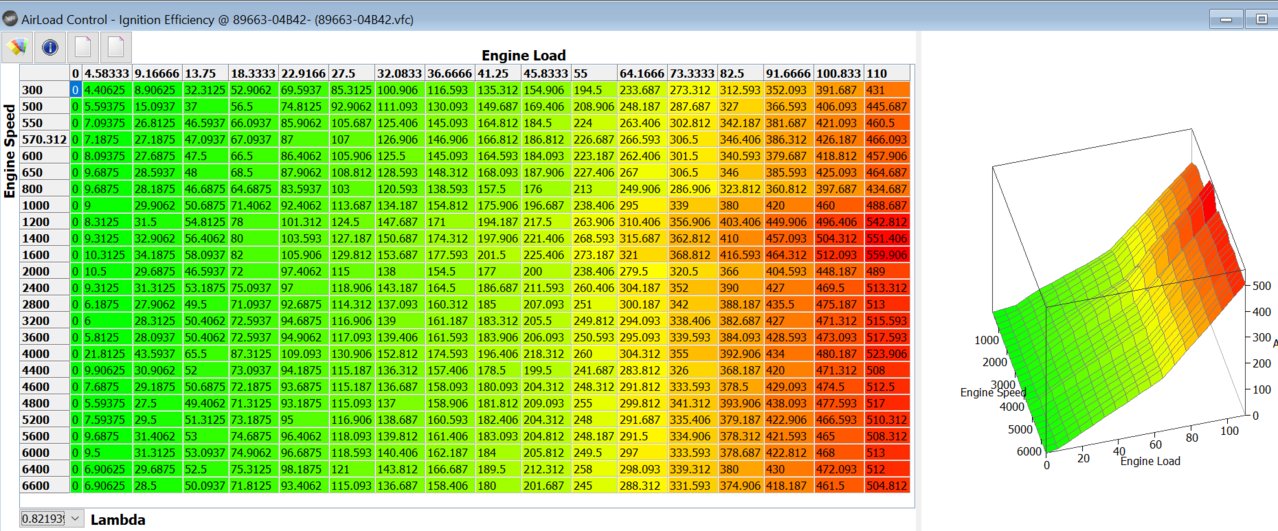

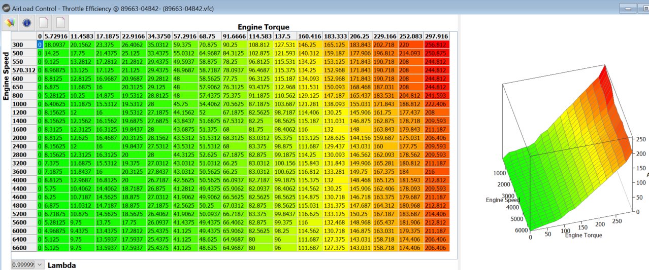

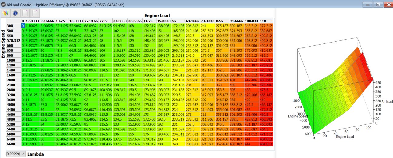

    Ok, here are all 4 maps for 04B90
    Control AirFlow .821 lambda
    Control AirFlow .999 lambda
    Expected airflow .821 lambda
    Expected airflow .999 lambda

    Thanks! I'll do a check later unless someone beats me to it.

    From memory, they look pretty identical to 04C30. I could pull them all as well to be sure but I doubt they'd be much different if at all.
