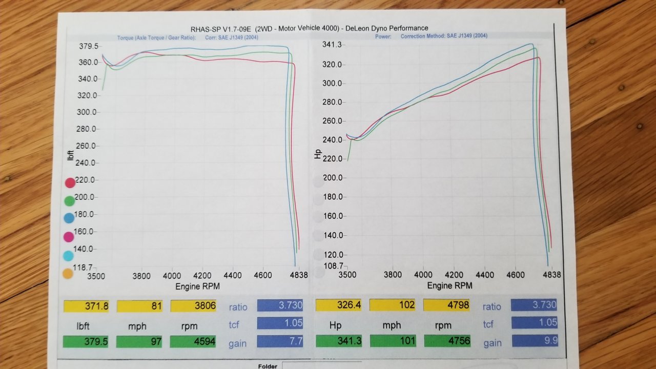

    Stock: Max Power: 326.4 Max Torque: 371.8
    OVT 91Oct Max Power: 335.8 Max Torque: 371.7
    OVT 93Oct Max Power: 341.3 Max Torque: 379.5
    1. Truck had 91Octane pump gas cut with 100Octane. I aimed for a 50/50 mixture hoping to ultimately have fuel in the 94-95Octane range. Octane93 is not readily available at California pumps.
    2. Had three pulls on the Dynapack. Baseline, 91 Octane file, and 93 Octane file
    3. Dyno pulls were done in 4th gear. When attempting to dyno in 3rd, the tachometer was inaccurate which would affect the plotting of the results.
    4. Dynapack dynos are performed with the drive wheels removed from the vehicle. Thus, it doesn't matter what size tire I have, nor the weight of my wheel/tire combo.
    Stock = RED line
    Octane91 = Green Line
    Octane93 = BLUE line

    Baseline (yellow boxes/ RED line on chart)
    326.4HP / 371.8TQ

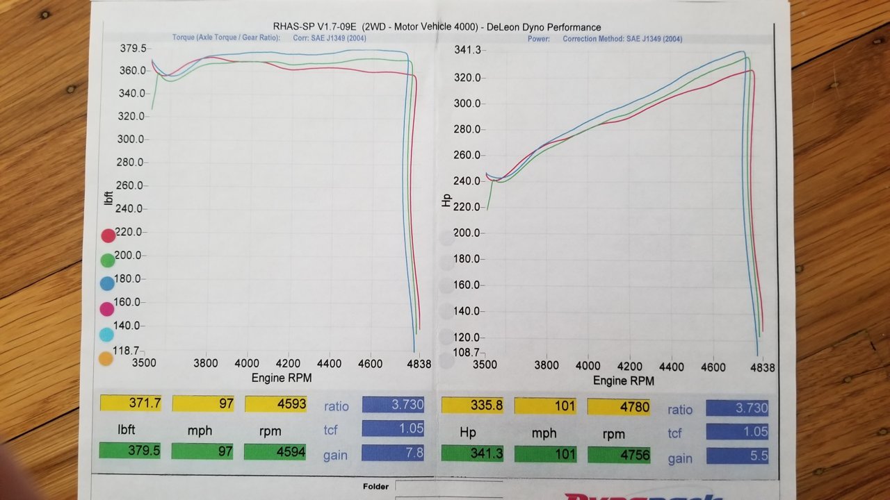

    OVTune Octane91 program (yellow box/GREEN line)
    335.8 HP / 371.7 TQ
    OVTune Octane93 program (green box/BLUE line
    341.3 HP / 379.5 TQ

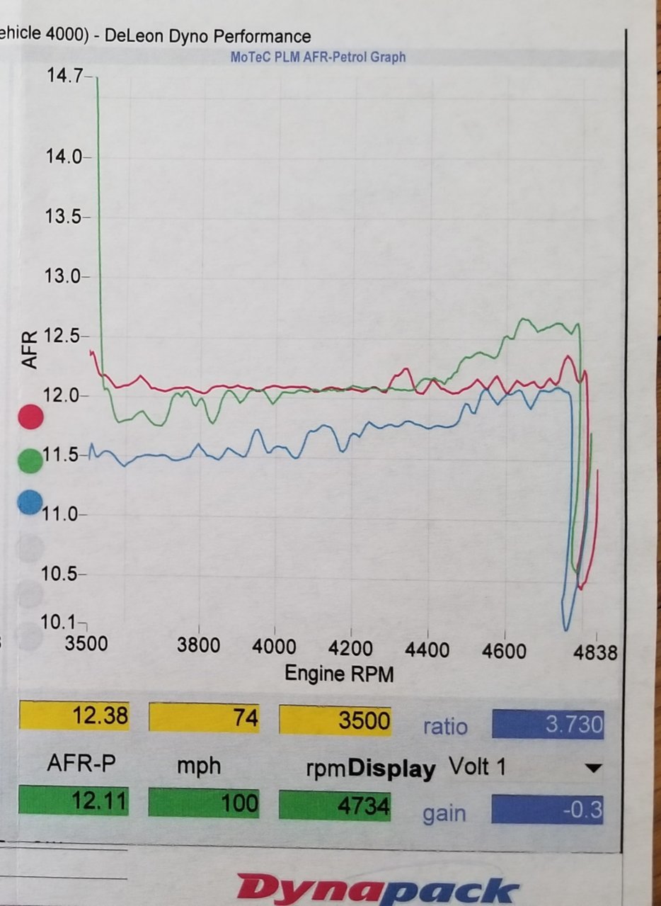

    AFR chart. Reading was taken with a sniffer probe at the rear tailpipe.
    Stock = RED
    OVT Octane91 = GREEN
    OVT Octane93 = BLUE

    Conclusion:
    1. stock TRD supercharger software didn't look like it was pig-rich
    2. Both OVT oct91 and oct93 tunes starts to lean out on the top end.
    3. If keeping the same setup, I should do the boost reference fpr mod.
    4. Need OVT to remove the speed limiter

    Strong results. Thank you for sharing, and especially the graphs!

    Ya I’d like to see the graph go to 5500rpm and see where it goes then. My truck goes more rich the higher the rpm I go.

    Very similar mods and power as @Murphinator's OVTune dyno but big difference in max torque. I think he posted 329 max TQ.

    also why were dyno runs only done to like 4800 rpms, should of ran that bitch to fuel cut, peak torque and hp on a stock motor occurs at 4000rpm (tq) and 5200rpm (hp)

    You're correct...my mistake. Still curious as to the near 50 lbft TQ difference with nearly identical max HP

    Yes, also keep in mind the dyno I went to was at about 800 ft and by the time the ovtune was flashed it was a little warm out. Atleast 80 F, probably more.
    Good numbers! My pulls were done in 3rd gear sadly.

    Dyno operator said he believe it was hitting a speed limiter. I do not have the governor removed although it is doable (confirmed with Mat).
