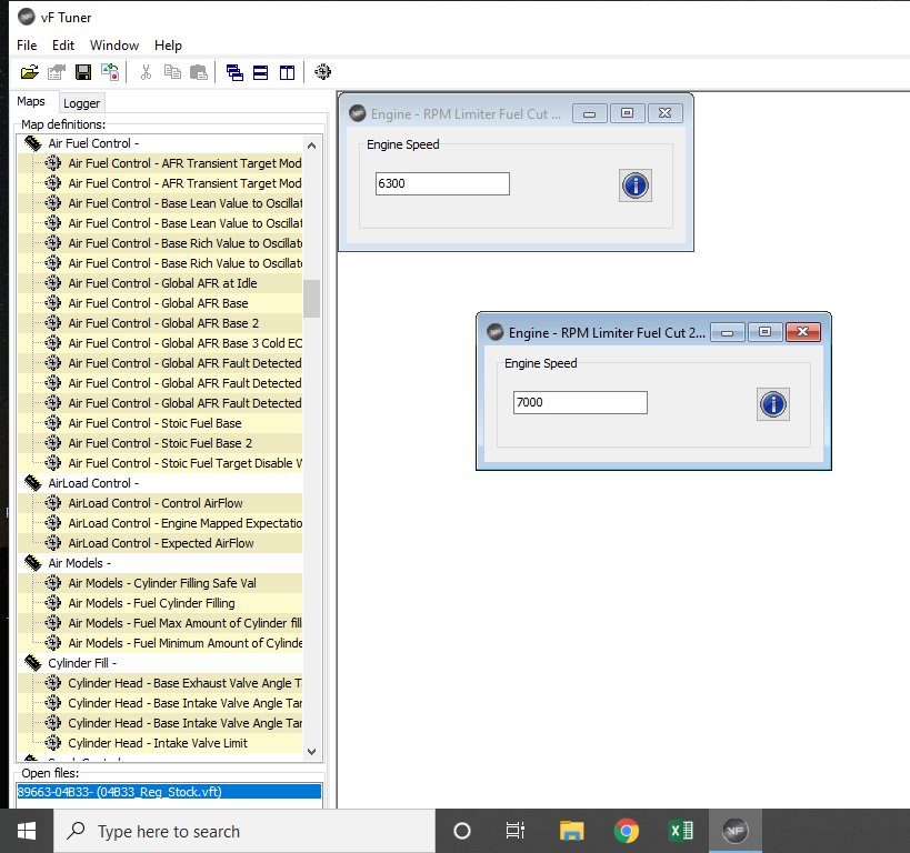

    You should be able to get up to 7000 rpm on a tuned truck. Stock was 6300.
    If you cannot, I'd get it flashed again. The custom tunes that people are flashing are much better than 2.0. Ask for a custom performance tune. And tell them that you want the RPM Limiter raised to 7000-7200.

    I was the one who flashed his truck...after going back and forth, I see what the problem is. I used some of my credits to unlock 04B33 and here is the problem...the rev limiter wasn't updated to 7000 like the other files are.
