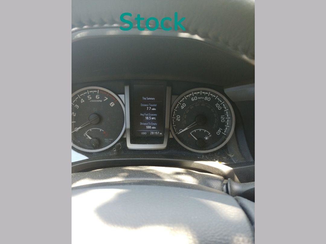

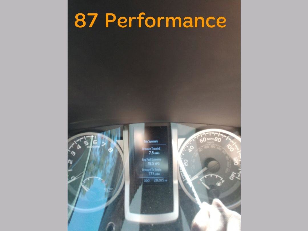

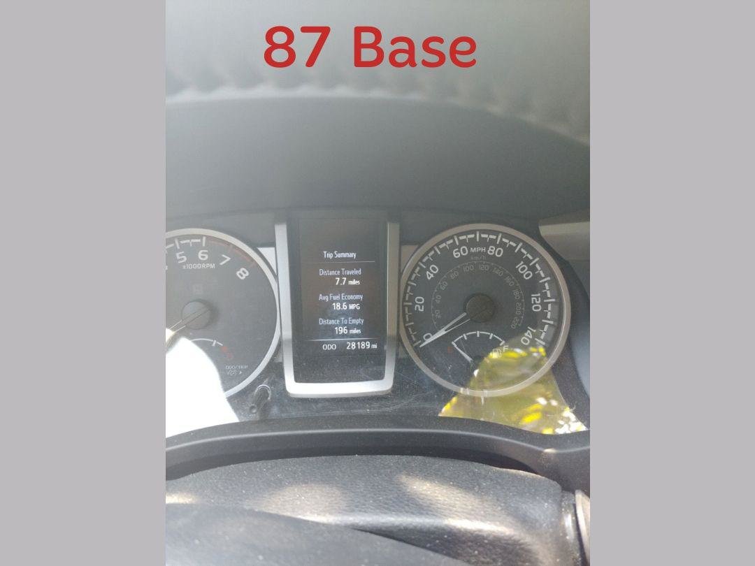

    I was curious about how OVtune would effect mpg and performance on my setup and so I tested stock, base and performance.
    Testing vehicle: 2017 double cab 4x2 with 265 70 17 Falkens(Get about 1-1.5 mpg less than stock) running 93 octane gas.
    The loop I chose to test it on is almost 8 miles and is a mix of suburbs with a couple of stop lights here and there, and a 3 mile highway section so I feel it's great for real world testing.
    *Clarification: MPG test is simply aiming to compare how different tunes fare over the exact same route with varied driving conditions, not aiming to compare several tank averages which would all include different impossible to replicate routes.
    MPG on a short varied route
    To my surprise, there wasn't a huge difference between all 3 tunes.
    I was expecting 87 base to perform a bit better and 87 performance to be worst but .1mpg is.. well nothing.

    I did not do a test on 87 stock this time but I just reviewed old footage of a failed test on the same testing location(I did not stop the vehicle completely before mashing on the pedal)
    87 Stock: 8.50 secs (With advantage of lighter tires and starting from about 3mph)

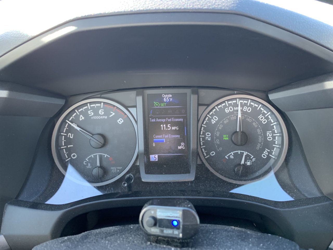

    2017 TRD Pro, 2" lift, 33" tires, OVT 1.05 91 performance gear lock tune with 92 octane Costco fuel, lots of miles on the tune, driving against a 10mph wind on mostly flat road.
