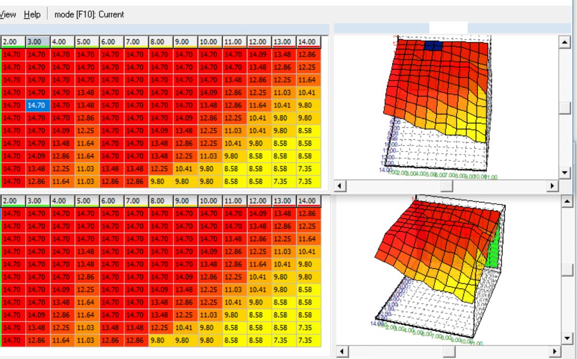

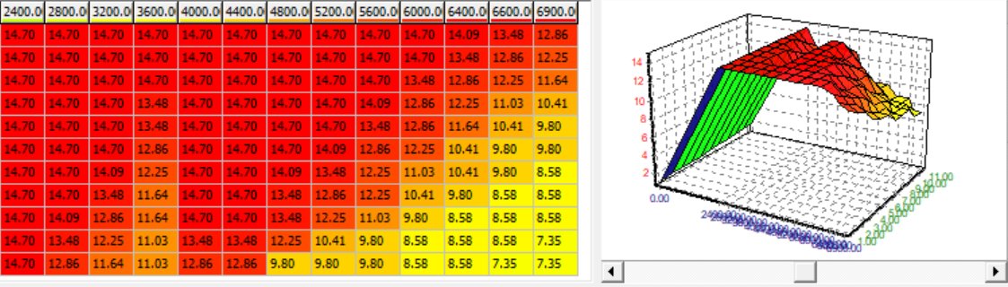

  17. Nov 9, 2017 at 8:50 PM
    #357
    20tacoma17
    20tacoma17 Well-Known Member
    Nov 8, 2016
    #201910
    7,079
    2017 DCLB Sport AT
    Kings, 275/70/17, a few custom items, lots of Meso mods.
    what are we looking at Matt? Thanks

    OVTune
    AFR Table v X (will find out) high Load v Temp
