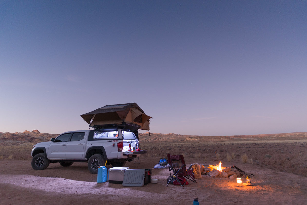

    Good lookin truck. This tread is great as is, but the occasional photo adds life to it

    thanks. Having fun with the build. It's getting there. Just can't decide on tire/wheel setup... Still loving the tune BTW. Last tank per Fuelly was 21.5 mpg.
