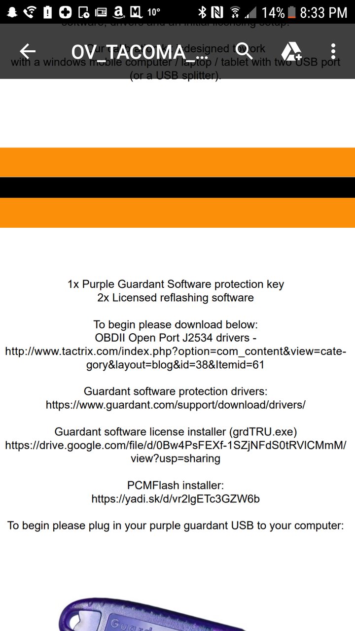

    Guardant license installer isn't working

    What exactly isn't working?

    The website for the guardant software license installer says it doesn't exist

    Trying to install everything now. Mine is saying the same thing!

    Well... it seems to have worked when using google chrome. It didn’t work using internet explorer.

    I'm using Windows 7 with Internet explorer and it' not working. Anyone have suggestions on a good cheap laptop

    What part isn't working? Windows 7 should be easier than Windows 10 to get working because you don't have to worry about Windows Defender. If you are running ANY virus software make sure you turn it off.
