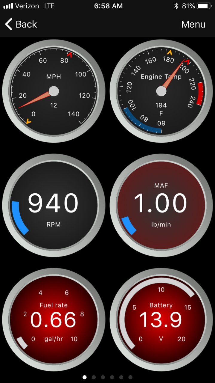

    I just flashed from 91 shift a to 87 shift a last night. Truck has about 9 gallons of 91 and 10 of 87. Some I’m 89 octaine.
    I have about 150 miles on it and the truck is running rough off idle under mild acceleration. My misfire counts are way up. I might have seen 1 in two months running 91 tune. This morning in traffic thing was missing a lot.
    Anyone else have a similar problem.
    Acceleration in first feels more advanced/faster than the 91 tune.
    Here are some screen shots, 4 misfires, low rpm, uphill.
  4. Feb 15, 2018 at 7:49 AM
    #784
    bshammer0
    bshammer0 Well-Known Member
    Nov 6, 2016
    #201655
    3,366
    Brandon
    Nashville, TN
    2017 DCSB TRD OR 4x4
    Prinsu, TruckCovers USA, Coverking, OVTuned
    It will probably level out - 4 misfires is nothing for these trucks based on my experience. If I use gas with the wrong additives (like my experiences w/ VPower, I get that many or more misfires stock or tuned) but it takes like 35 misfires in a single cylinder in a 100 rotation cycle to even trigger codes. that said it almost seems like you're still running the 91 tune - perhaps a reflash to make sure no issues with what was loaded?

    Which app is that...?

  12. Feb 15, 2018 at 5:04 PM
    #792
    MOC221_
    MOC221_ 3 pedal metal
    Feb 20, 2016
    #178858
    7,850
    Frank
    2019 DCSB Sport M/T Barcelona Red
    vF Tuned; ADM; Core SS
    That's OBD Fusion if I'm not mistaken. I have it, awesome!

    PB FAB
    PB FAB Well-Known Member
    Apr 11, 2017
    #215942
    805
    2017 SR DCSB 4x4 v6
    Correct obd fusion
