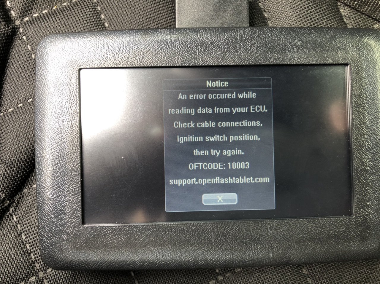

    i did not skim the thread to see if there’s been any new updates since December but i am still getting the same error as before. Has there been any developments on OV getting this to work with 2018 Tacoma’s? If so Does OV have a tech support by phone at all bF0CE2181-8AAB-491A-9BEE-BE5D8BE83A13.jpg ecause obviously something ain’t jiving here and i am not sure what i would be doing wrong with the software downloading updates from my computer to we’re it will not read my ECU.

    I don't have the tablet but on the laptop it happened to me when my battery charger was above 13 volts. I disconnected the charger and wait the voltage to drop to 12.7 and it worked. They are swamped with the new stuff so it will take a while for them to get back to you.
