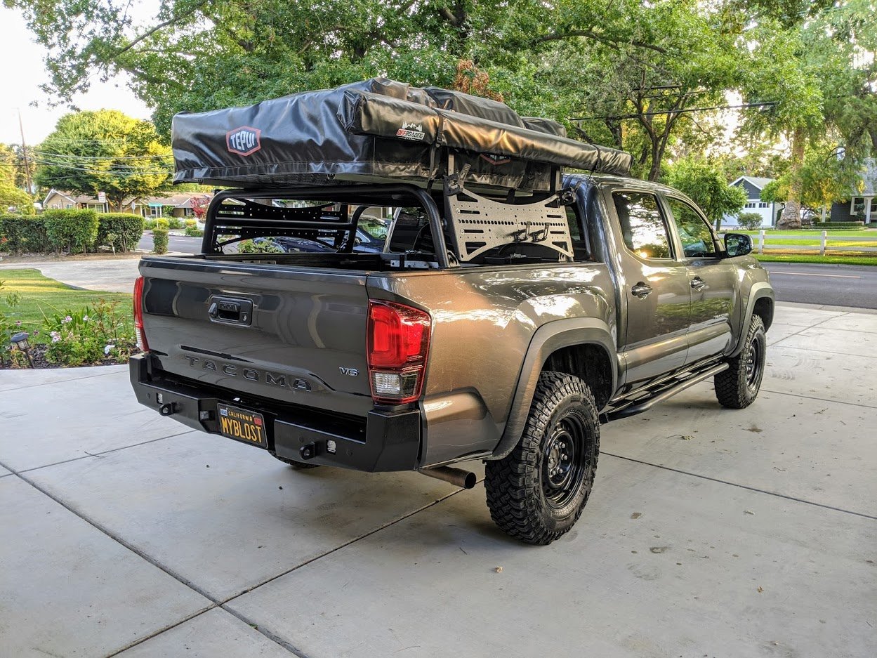

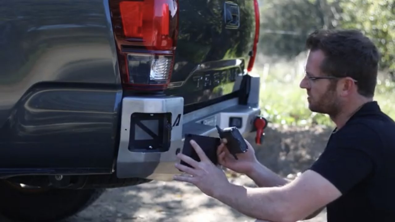

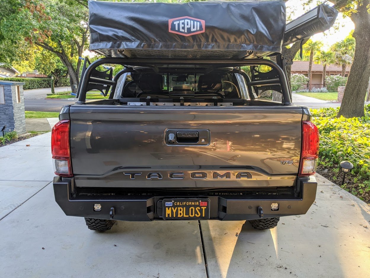

    BAMF steel bumpers come with holes for the back up sensors. Uses the factory grommets. No BSM support. I took the BSM sensors off and sealed up the plugs to prevent water and grime intrusion. With BSM turned off you get no errors in the cab. The BSM alerted me to unseen cars and pedestrians a few times but the added clearance was worth losing the feature for now.
