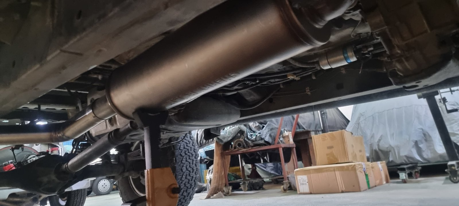

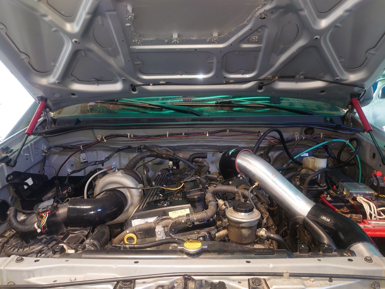

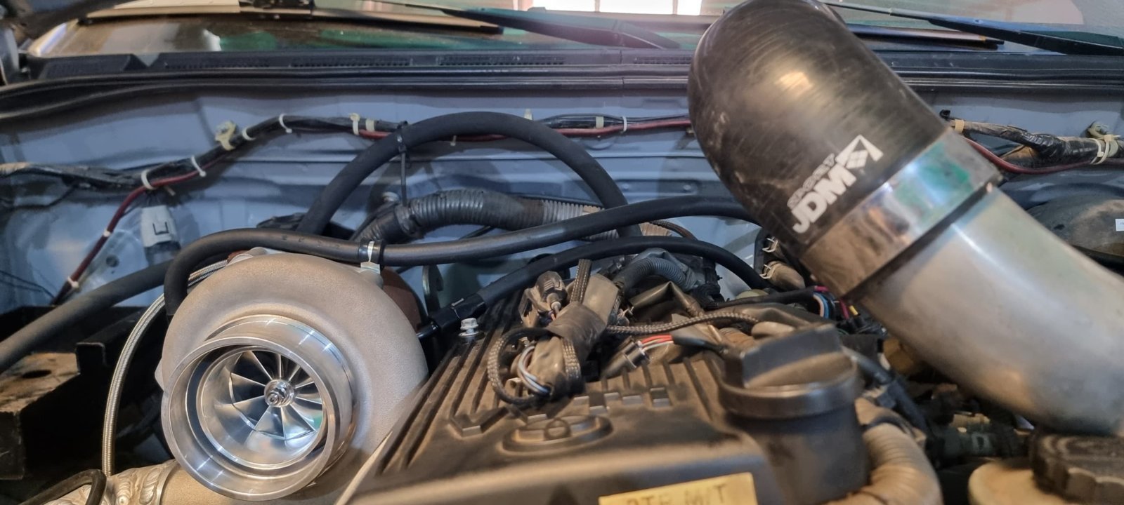

    after 5 years have my turbo installed. I'm still in the process of installing the ecu standalone. the turbo header is same as alibaba all other part of the kit is custom.
    DSC_0073.jpg 28/10/22
    I have an ecu master emu black and the rest of the hilux works with the original ecu.
    2 weeks ago my turbo was damaged. I'm waiting to finish calibrating
    After so much time, I changed my turbo to a pulsar psr3584 gen 3 ball bearing a/r 0.63 and 3 inch exhaust with 4 inch cherry bomb (3 inch modified) I have problems controlling the psi, they have peaks of 17 psi. has a stand alone emu black ecumaster injector 750cc
