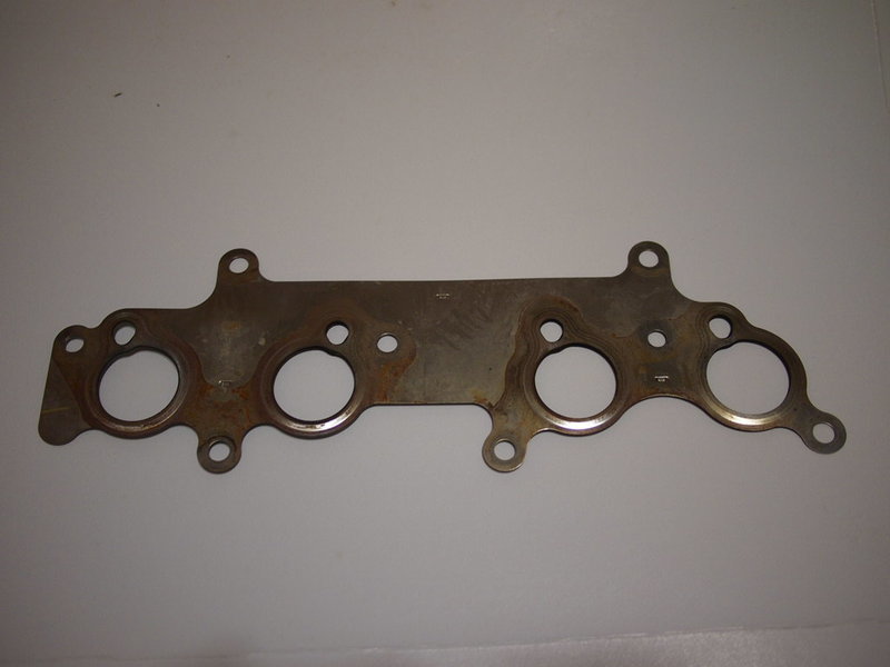

    @KirkRio , do you have the OEM header? I am curious if you could post a picture of the flange's mating surface? The flange which bolts to the head.
    If it is the same as the 3rz flange, then there is a solution to just purchase the turbo header.

    Here's a pic of a 2tr exhaust manifold gasket. The side facing the viewer is the manifold side.

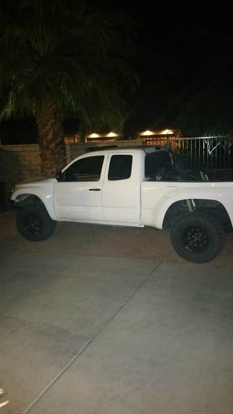

    2005 white 2tr-fe actual prerunner

    Where did you guys order it from? The ozboost website or ebay? I want to buy it but for some reason theor ebay page for the kit isn't working. Im on my phone so I will try it on my laptop later but just curious which you bought it from. Thanks

    Hey man, your vehicle description has me intrigued! Got any info or pics? Sounds like a sweet ride!

    #190391
    35
    Trenton
    There isn't much that's stock anymore

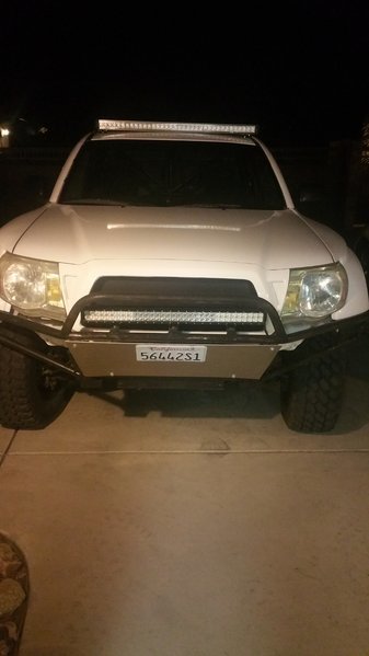

    Just ordered the kit! Very excited to get it. And sure I'll put some up. It's an 05 with a full cage in cab that ties into bed cage for 2.5 x 18" fox triple bypass and Deaver leaf springs. Front has a total chaos ucas and 10" icon coilovers. Hopefully I'll be getting their long travel kit soon! Lots of other things too. Fiberglass fenders and besides racing seats two light bars. And soon a turbocharger! Haha

    Here's one more
