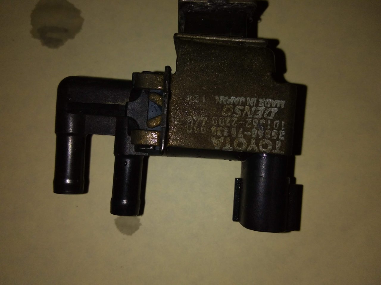

    My 2000 tacoma prerunner has been recently diagnosed with check engine code P-0446. After researching this error code, it seems that there can be a multitude of reasons why the check engine was activated in the first place. I ran the code at the local autozone and it recommended to replace the "evaporative emissions (EVAP) Vacuum Switching Valve (VSV). I purchased the recommended part, an EGR vacuum solenoid, but I am having troubles with finding a video tutorial to DIY. Do you think I should replace the solenoid or replace the charcoal canister?
    Any tips and suggestions would be greatly appreciated.

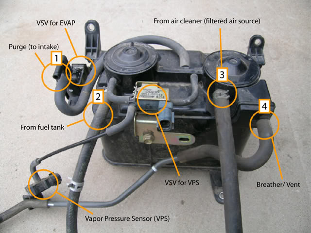

    P0446 is a flow code
    Usually Purge Selnoid
    Possibly Vapor Pressure Switch
    Is your charcoal cannister above fuel tank or under hood?
    Replacing old vac lines with thick wall Silicone is good maintenance.

    This is the Purge Selnoid
    VSV for VPS
