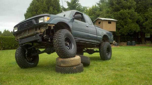

  5. Jun 29, 2011 at 2:05 AM
    #185
    P_Tree
    P_Tree [OP] Well-Known Member
    Aug 7, 2010
    #41381
    349
    Tyler
    Beavercreek, Oregon
    1995 1/2 Tacoma
    Custom plate bumper Trail Gear sliders/rear bumper Magnaflow exhuast Warn M8000 Winch Rocklights 8" Hella Fogs Cargo Bed Basket Tint 35 12.5 KM2s SAS Swap CB and PA Hids 8k highs and lows Fogs 12 inch alpine sub Spec intake Blacked out Grill, Emblems, etc...
    Thanks for those who got my back. I will try to get Mord pics and a list up. Should have it completely done by tomorrow other than front drive line.

    Rough list:
    Axle-350
    gears and seal kits front and rear-900
    Install-free
    Hyme. Joints-150
    Drag and tie rod-400
    Knuckles and arms-300
    Steel-100
    Pitman arm, front and rear shocks and hangers-100
    Frame plates- 109
    steering shaft-10
    Firewall plate-75
    brakes and rotors-200
    Wheel spacers -100
    Custom brake lines-100
    oil pan conversion-230

    Were did you buy the km2's? I think my question got lost in the last page? I heard they were running a deal on 35"s. Did you buy 5?

    Where can you find a pitman arm, FRONT shocks, AND REAR shocks AND THE F**KING hangers for $100? Pitman arms alone are $75+.

    Pitman arm, front and rear shocks and hangers-100????? where the hell did you get it that cheap??

    tires i got at american tire company from my friend who works there. i bought all of it from a buddy that was helping me on the build. traded for the ifs box so it was free. dont need ball joints, thats what the hyme joints are for. they are way better and rebuildable.

    with out ball joints how did you get the knuckle onto the axle housing?

    Sorry didn't think you ment those ones. They were 55 anyone know a good way to get better braking power. Like a bigger master cylinder maybe

    Not at the time. Lol dana 44 out of a waggy. 4.88s are perfect

    also how much did the new hubs and stuff cost?
    and also there is no way you only paid 55 for ball joints, they cost between 35-55 each, you have 4.
    just the new hubs alone costs 111 dollars per side
