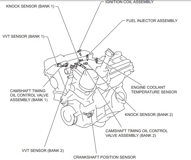

    If the below is true ( Timing Chain ) and you take it to the dealer it will be greater than 2000 $ if the timing chain has jumped a tooth. It could be the OCV ( Oil Control Valve ) that controls the VVT and or the filter associated with it. I would start there at the OCV and Filter.
    This is what the Toyota service manual says:
    P0011 - Camshaft A Over advanced - Problem areas:
    • Valve timing
    • Oil control valve (OCV)
    • OCV filter
    • Camshaft timing gear assembly
    • ECM
    P0016 - Crankshaft Position - Camshaft Position Correlation (Bank 1 Sensor A):
    • Mechanical system (Timing chain has jumped tooth or chain stretched).
    • ECM
    bruinsrme[OP] likes this.

    Sorry to revive an old thread. I need the part number for p0011 code. For the oil control valve. Thanks
  7. Jul 18, 2023 at 7:57 PM
    Dm93
    Dm93 Test Don't Guess
    Mar 3, 2015
    #150066
    13,220
    Texas
    2014 DC OR 6spd 4x4
    Predator tube steps, Ranch Hand grill guard, Magnaflow CatBack exhaust, Toyota tool box & bed mat, 2LO Module by @Up2NoGood, Rearview Compass/Temp Mirror, Tune by @JustDSM.
  8. Jul 18, 2023 at 8:48 PM
    TacomaDblCab
    TacomaDblCab Well-Known Member
    Feb 12, 2014
    #122939
    52
    Virginia
    2011 Tacoma Dbl Cab Off Road
    Window Tint, Kenwood DDX 470, Polk Audio DXi6500 (front), Polk Audio DXi650 (rear)
    Thank you. Is OEM recommended or has anyone use one from Rockauto?
