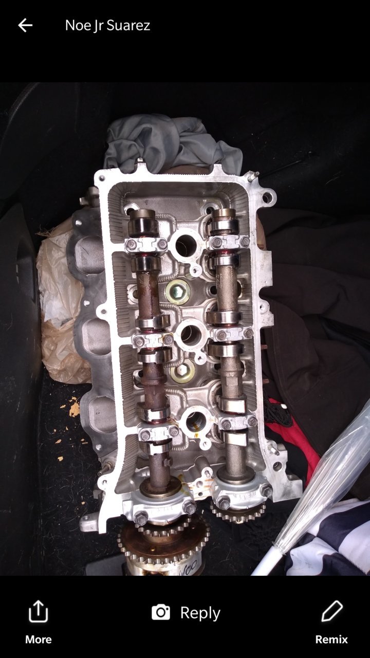

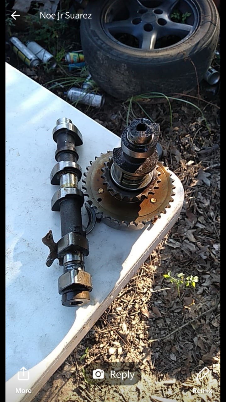

    Yeah the cam shaft is brand new. New head gasket .heads and valves we're worked on at the shop. Only things I can think of is he didn't put the timing on correctly but I don't think it would run good then . And the other is this sensor .

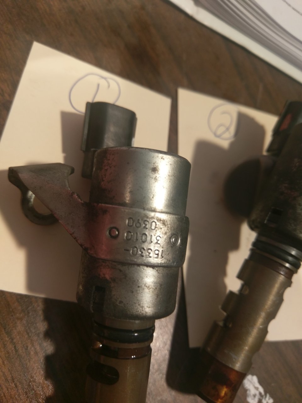

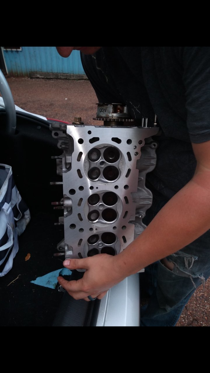

    Did they mill the heads? If they did that will throw the timeng off. No solution but new heads.

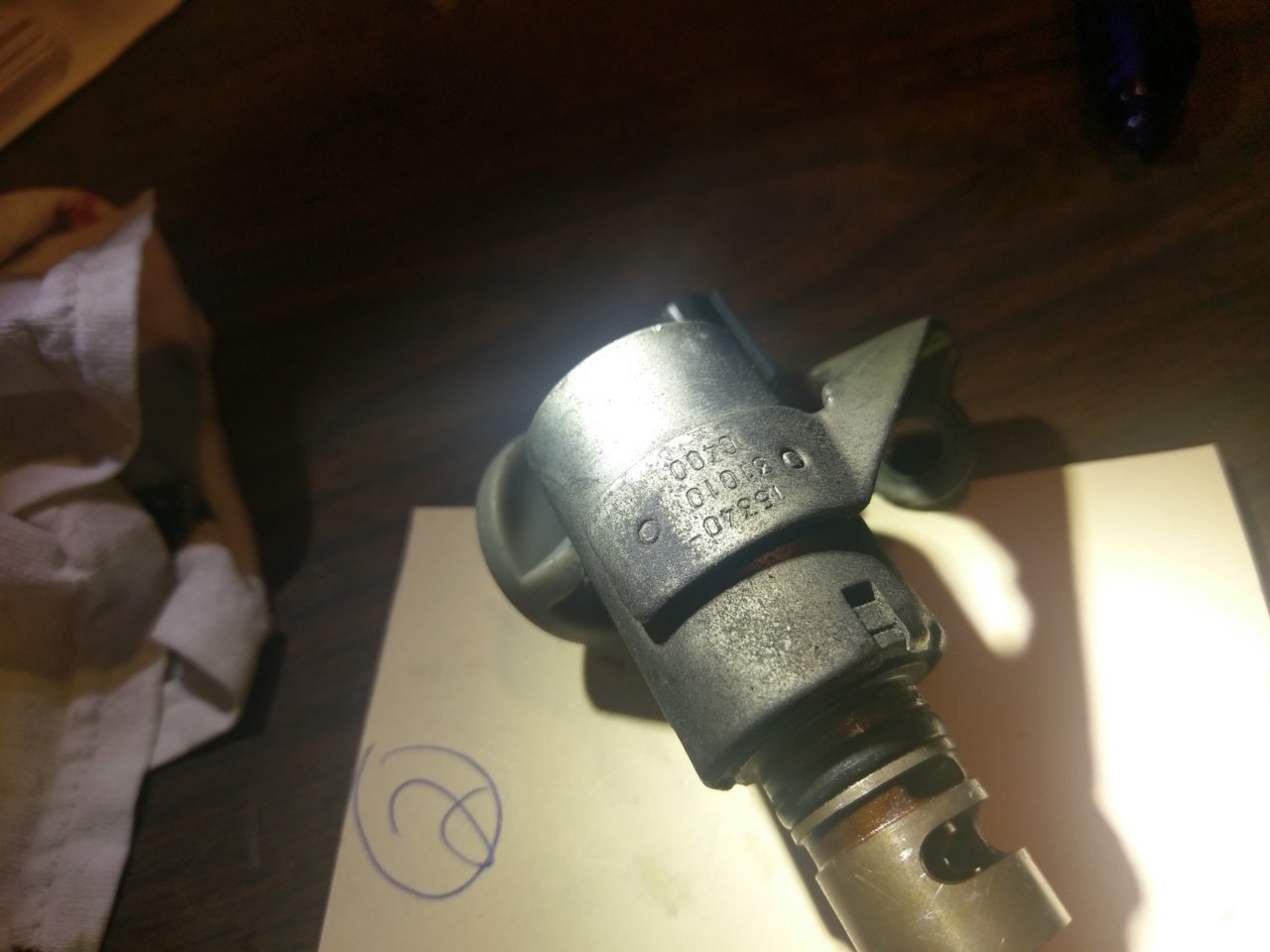

    I think they are different part numbers. I'm tearing down a 1GR-FE tonight, i'll see if part numbers are stamped on OCV's.

    Yeah they did . Really? Never heard of that . How come.

    Here's the OEM's I just pulled.
    You let some guy in his back yard do a head gasket job?
    You are not supposed to mill the surface of the heads.
    Dood, that's literally in like Toyota Training manual 101 (I think it's 101, maybe 105, have to check)
    The reason is because the distance between the Cam and Crank has been altered.
    Stop by a dealership and ask a Toyota Master Mechanic :)
    SR-71A likes this.

    The guy knows his shit. Used to have a shop. I have read post after post of ppl getting theor heads machined and a valve job done while doing a head gasket job?

    The soleinoids are different from bank one and bank two.
