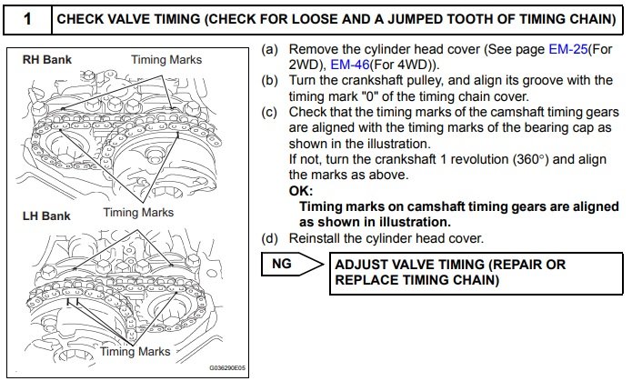

    Most common cause of timing codes on the 4.0L is the Oil Control Solenoids sticking, the screens can clog but that's usually on engines with neglected maintenance. Timing Chain stretch is another possibility but not as common.
  3. Oct 11, 2022 at 9:01 AM

    You can try to clean them but most of the time that doesn't work.
    The pictures are from service info, I have service info access through the shop I work at. There's an 06 FSM you can find if you poke around but we aren't allowed to link to it.
