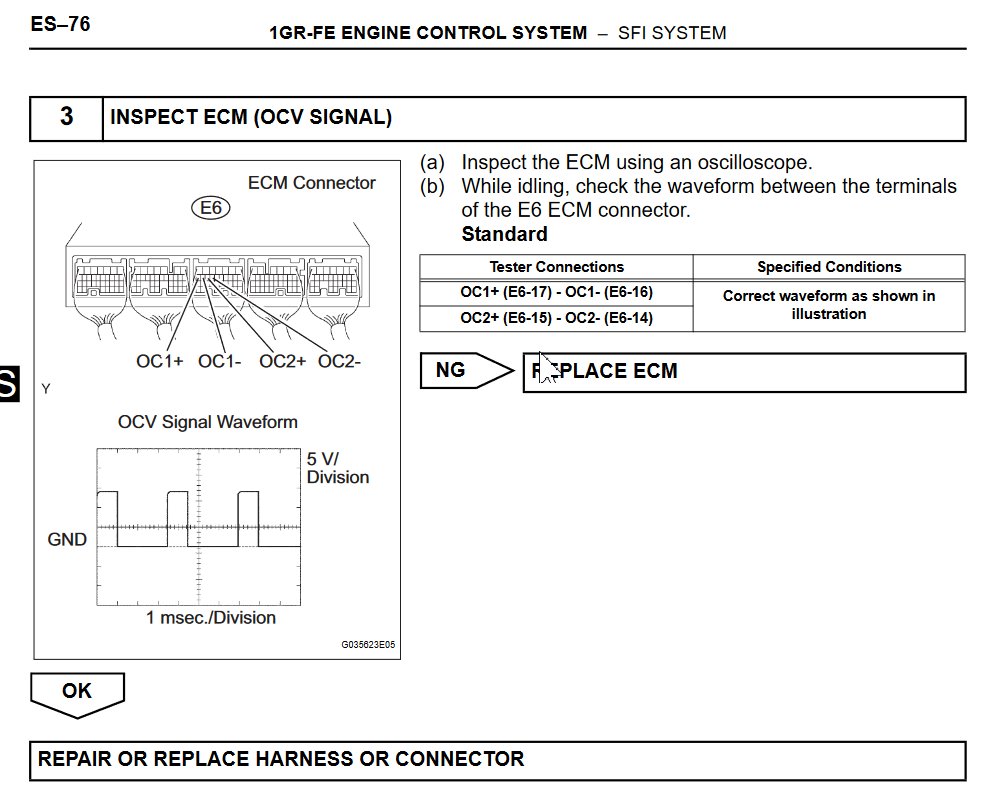

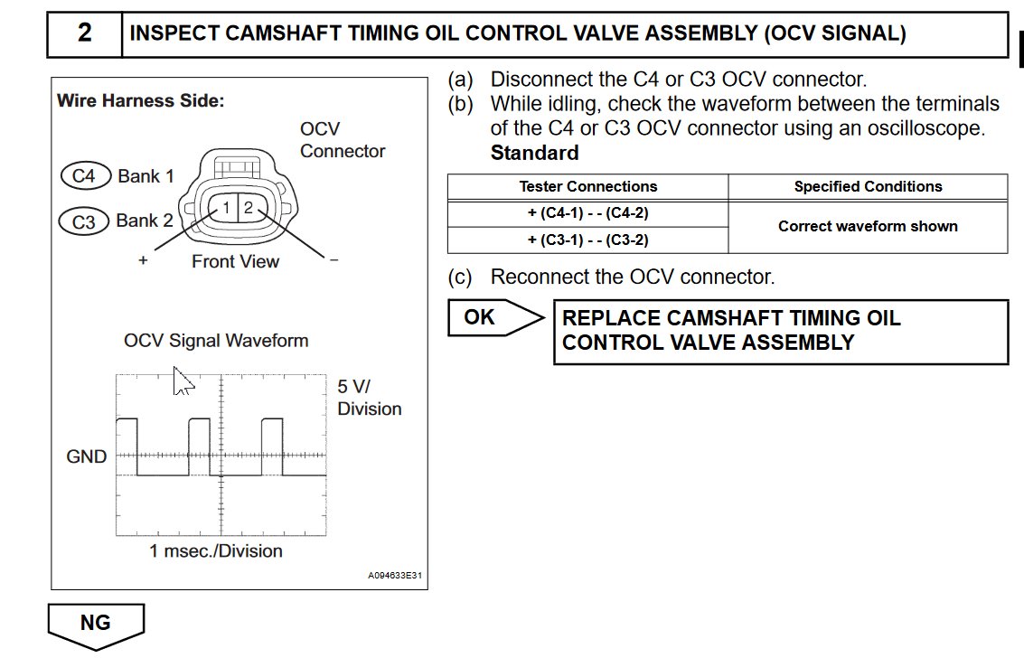

    2012 Prerunner SR5
    It sounds like you have done it all correctly except the part with an O-Scope. If the signal is bad at the OCV Valve and good at the ECM then there is a wire harness problem. You may want to inspect the harness first. Rodent Damage is a possibility.
