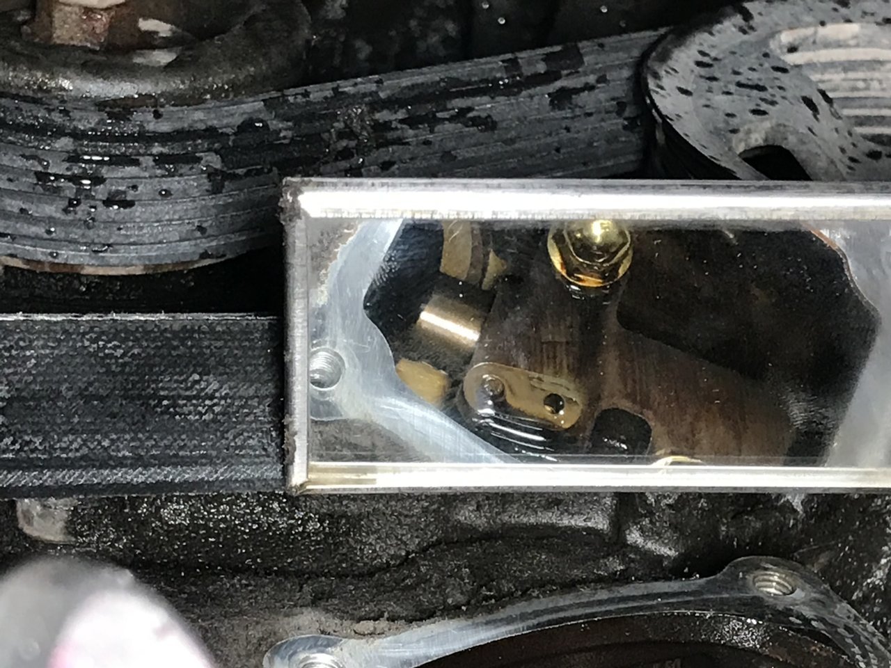

    I removed the inspection port to look at the tensioner. From what I can tell, there is no movement on the tensioner. It does not have visible rings from extending, nor does any art of it appear cleaner or anything indicatiing any movement.

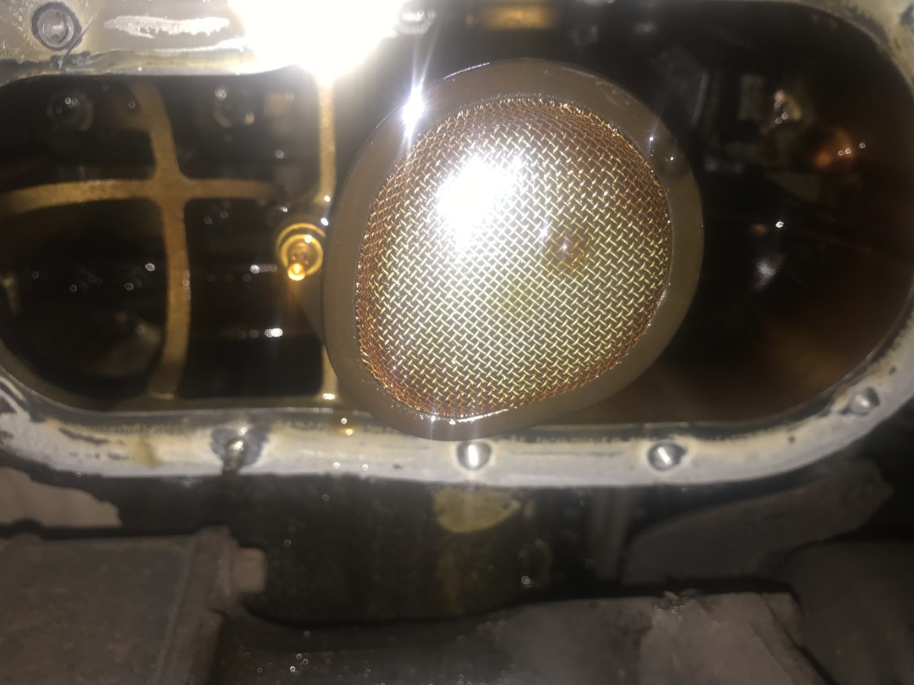

    IMG_0845[1].jpgSo I pulled the oil pan and inspected the pickup tube. It appears to be in great shape with no blockage or sludge buildup.
    IMG_0844[1].jpg The tensioner is tough to see on the left hand side of this image through the mirror, but it seems to be in good shape and has no signs of movement.

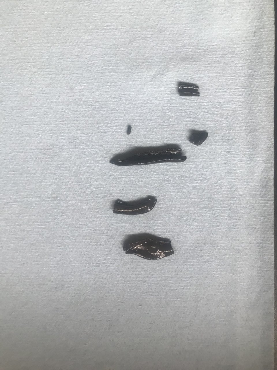

    The oil pressure tested at 70 psi in N and 60 psi in D. I let it idle for five minute at that pressure. Now I am not sure what to check. I dropped all the oil out of it to inspect the pickup tube. In the bottom of the oil pan I did find some very concerning pieces of a some rubber material? gasket maybe?

    After further inspection, the pieces of gasket are definitely from the oil pan gasket and probably occurred while i was removing it, so nothing to worry about there.
    TireFire likes this.
  17. Apr 22, 2020 at 4:42 PM
    #17
    TireFire
    TireFire Superunknown Member
    Feb 6, 2016
    #177349
    7,666
    Olympic Peninsula
    That looks like old and brittle FIPG which may be one of the reasons your timing cover is leaking. Be happy it ended up in the pan and not clogging a vital oil galley
  18. Apr 22, 2020 at 5:05 PM
    #18
    Renengade
    Renengade [OP] Member
    Apr 21, 2020
    #325418
    19
    2007 Toyota Tacoma 4.0L
    Yeah, no doubt about that. Could have come from up there too, but it looks like the oil pan gasket had a few spots where it was missing material. Who knows, I just am very confused why I am reading good oi pressure and there is no sludge buildup anywhere. The next step is to remove valve covers and look at the timing closer? To see what is causing these codes to be kicked on and why the idle is so rough suddenly....
