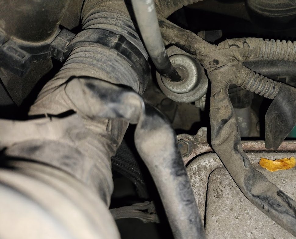

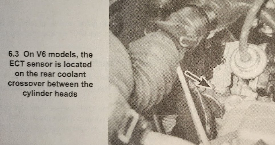

    I tried to dig into it today but I am baffled. The photo in the link you posted shows it is closer to being behind the driver side cylinder bank. The schematic shows it is near halfway between both banks. My Haynes and Chiltons both show it is next to to the vacuum actuator which is directly behind the right bank. There are wiring harnesses that are inhibiting any visibility to the area between the engine and firewall. I don't see it anywhere.upload_2024-2-10_20-41-48.png upload_2024-2-10_20-41-26.png

    Follow this hose down behind the intake manifold. It's just in front of the hose.

    I just can't get my fat hands back there to get a good grip on the wire connector. I am afraid I'll tear the wire out of the connector.
