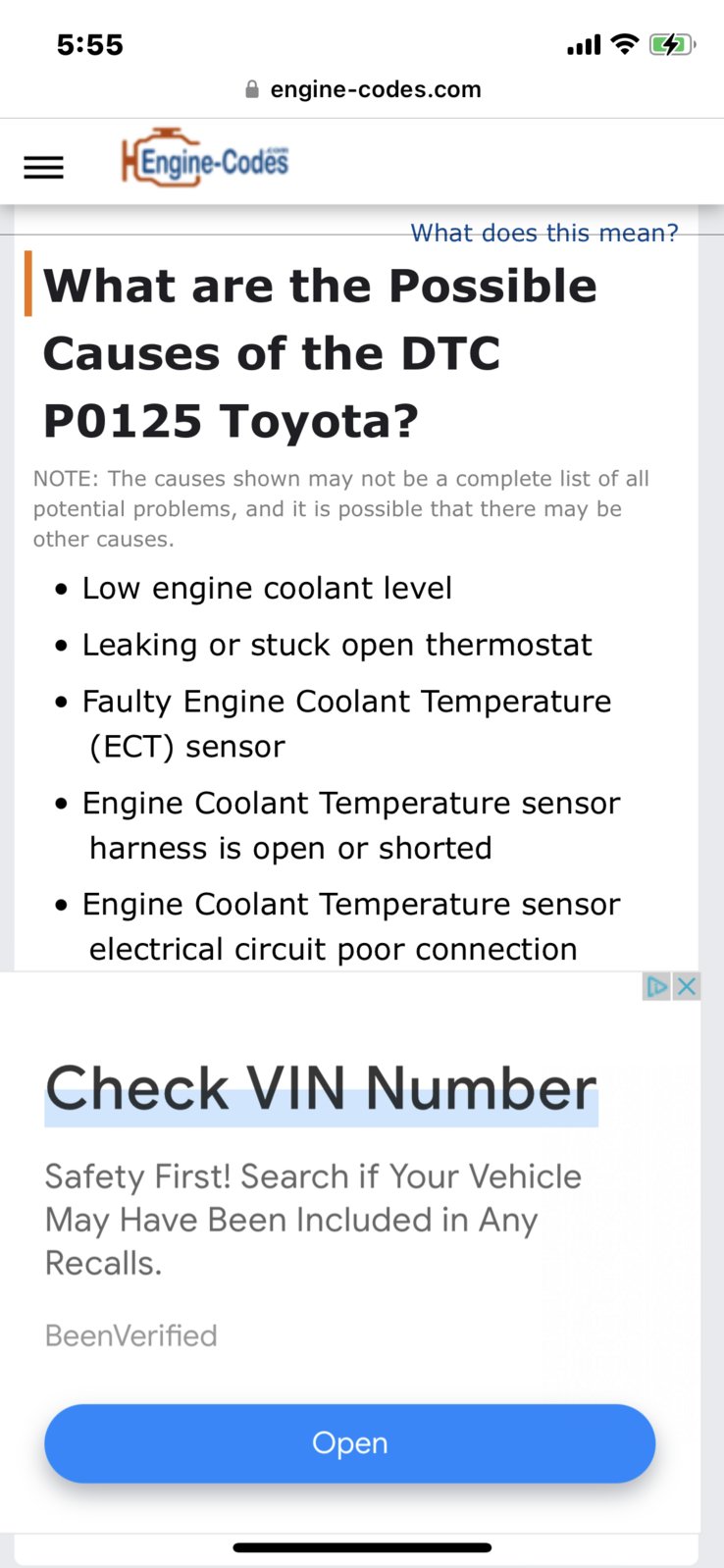

    What other members are saying, there are ways to pinpoint the issue thru real time engine data from ECM. They are saying don’t load the parts cannon and this saves you time/money.
    lucky for you both thermostat/coolant temp sensor pretty cheap parts
    check out some threads about ECT replacement on your engine
    Lots of videos out there as well
