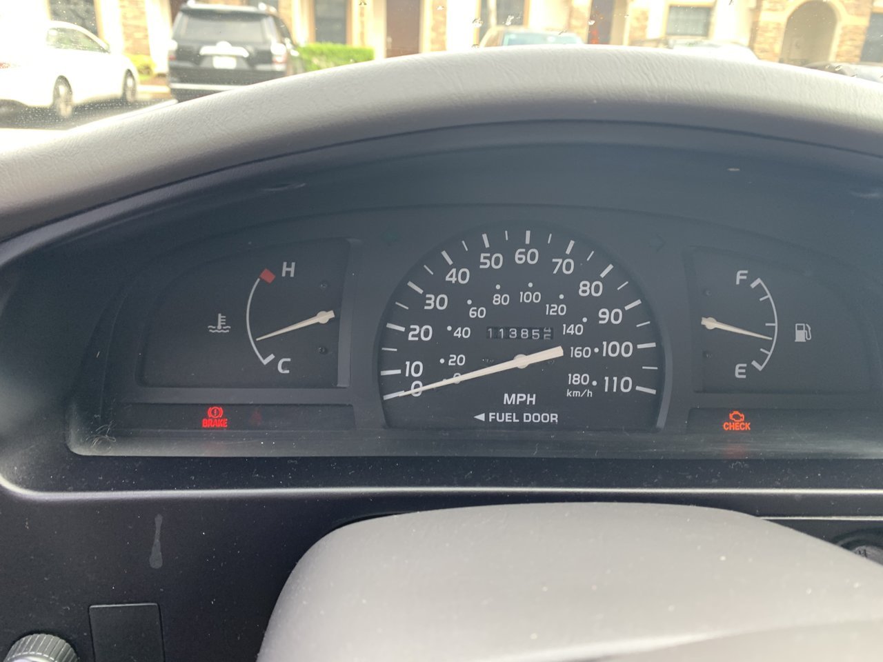

    2002 Taco Regular 5 speed
    Also this is what it looks like on the dash

    Any thoughts?

    I'm going to go ahead and say your thermostat is stuck open and needs replacing. It should open mechanically at 180°F (as someone else mentioned). Most are 160°F or 180°F, but you're not getting to that which tells me it is open or not completely shut.

    Toyota Red is what your vehicle came with. Pink is for years 05+ (04 in some caes). You would be able to use any color if you do a full flush, but keeping it simple would be Red. Aisin and a few other brands make compatible coolants - it’ll say for Toyota / Lexus in your model year somewhere on the bottle.
    136* is not what your engine is probably running after it’s completely warmed up - I’d drive it some and see what your scanner reads after normal use. The thermostat only opens to keep it in normal operating temperature but that doesn’t mean it won’t reach normal operating temperature with it open. If the scanner still says 136* or anything under 180* there’s a good chance your coolant sensor is giving incorrect readings and you could remove it and put it in some boiling water to test how accurate it is with a multi meter, but that’s a few steps down the line.

    Correct, start with the cheap solutions. But, I'm willing to bet the sensor is fine. Definitely won't hurt to test or replace though

    But he showed the picture of both the scanner and the temperature gauge and they each use a different sensor and they both showed a low temperature, so it's unlikely they are both wrong. More likely it's the thermostat.
    You don't have to drain the coolant but when you remove the thermostat a lot of coolant will come out from there, so it's just a question of where you want the coolant to come out of. Draining the radiator will be less messy.
    There is also a drain on the engine block on the passenger side more toward the front from the oil filter (2.4/2.7 engines). And this will dump a bunch of coolant on the ground unless you have a drain pan with a large surface area.
