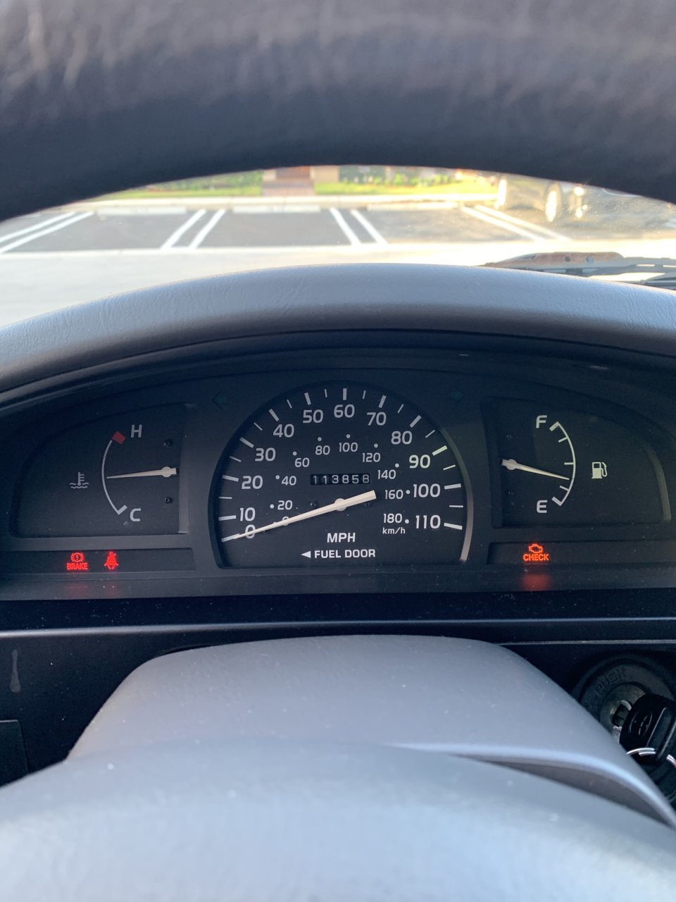

    Here is my ect now after i installed the new thermostat it went from 136 degrees to 194-196 is there a reason why my cel light is on

    Here my gauge now for the temp

    Yeah, those gauges look much better! I always get that "engine is running smoother" feeling after fixing my car. Usually it is a placebo effect, but still. And yes, without resetting the code, you'd have to drive a few times to get it to recognize it is functioning as normal and turn off the light.
    I'm glad it worked! Just be sure to check your radiator/radiator overflow to make sure your coolant is topped off. Obviously, not while it is hot. Other than that, I'm glad we could help!
