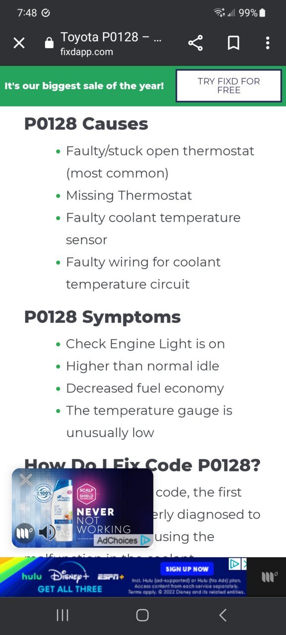

    Screenshot_20221228_194858_Chrome.jpg plus it can make it run lean. Sending false signals to ecu.

    Thanks I found that as well. I will check the thermostat in the morning. The shutter has me confused.

    Might be, because it's not getting to operating temp, or bad signal to ecu.
