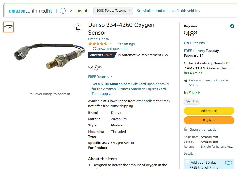

    I know that there is not exhaust leak, because if it was, I could hear it during my 2500 miles return trip, with the Eng. light on.
    Well, at this point, I think my best option is replacing bank 1, sensor 2 and see what happens.
    does 48$ for a Denso sounds right?

    Possibly but I wouldn't reccomend buying anything like that off Amazon or ebay. Too many fake "OEM" and name brand parts on those sites.
    If your buying online go with Rock Auto or a verified dealer. If buying locally go with a Denso from an auto parts store or dealer.

    I Agree. Amazon has become a “Buyer Beware” marketplace. I’d go with the one from RockAuto at $44

    I was under impression if seller is Amazon, then we could trust the item would not be fake.
    Anyhow, I ordered one from Rockauto, and will post the results when I install it.
