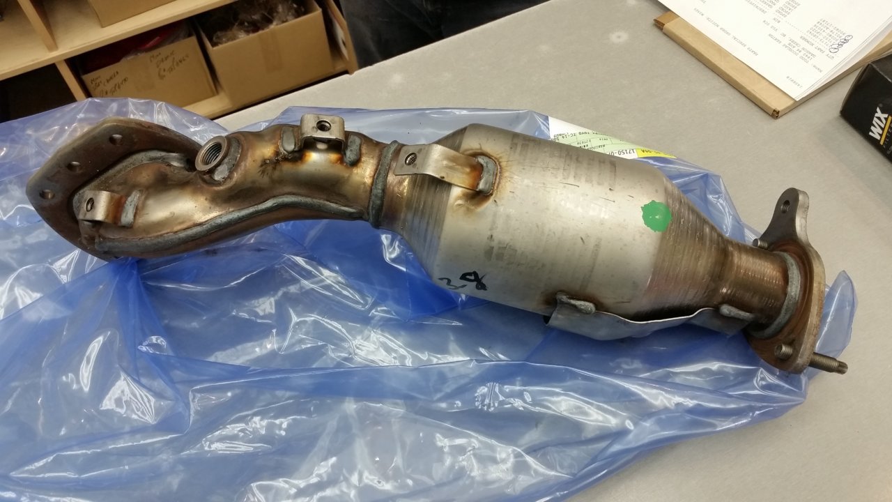

    They said they found a pin hole in the weld where the 02 sensor screws in.......hopefully these 30 days waiting comes to an end.

    Well exhaust leak makes sense from the errors you were getting. But never knew a pin hole could trip it. Hope this fixes it.

    I actually read on a google search from a Toyota mechanic that this has been a common issue and suggested to check that welded fitting. Strangely today, my toyota dealership mechanic said that his tech line people told him he should check carefully this weld also. So pretty sure now Toyota actually knows more about this than they are saying. Either way, after 30 days I just want my truck in my driveway and not at the shop.

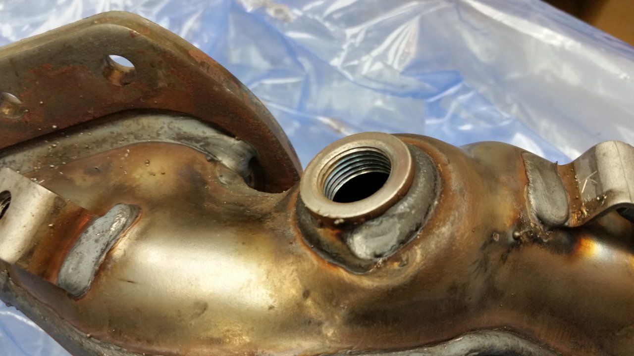

    Am i blind? where is the pin hole??

    Fucking welding robots can't make a good weld.

    Hey! I’m the one w/ the above post, code P0420 under 100 miles, getting new cat put on Friday. Just looked at my paperwork and it looks like they’re replacing the “Pipe Assy, Exhaus” and “Manifold Assy, Ex”. Did they do both on yours or just the pipe assembly (w/ the cat)?

    tJc...just the part shown in the picture and the 02 sensor that screws into it. Toyota canada is now involved and they are going to rent me a vehicle to drive.
