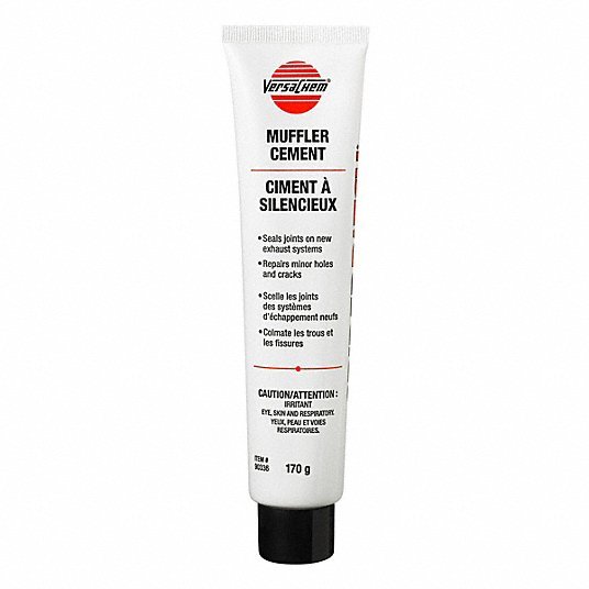

    I found this thread when googling around for the same P013c code. A friend had the engine light on for some time and I had a look for him.
    thinking that it might be a small pinhole causing extra oxygen to set off the downstream sensor, I had a look in that area. There didn’t seem to be any visible holes, but just to see I put some muffler cement all around the threads and the factory welded bung of the downstream o2 sensor.
    Well, nearly 1000 km and 3 weeks later the code has not retuned. It might be a good first step for others in the same boat, before they spend tons on new converters and god knows what else.
    I attached a pic of the cement. I’ve had good luck with it.
