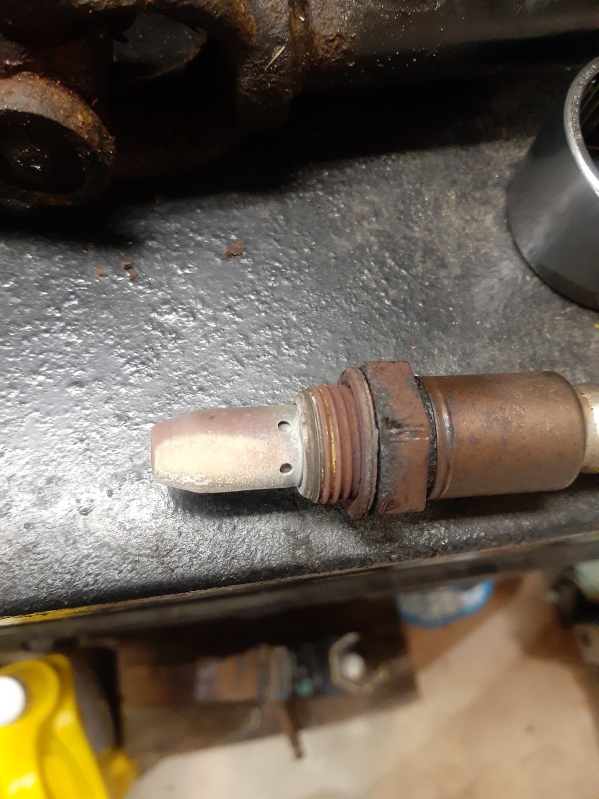

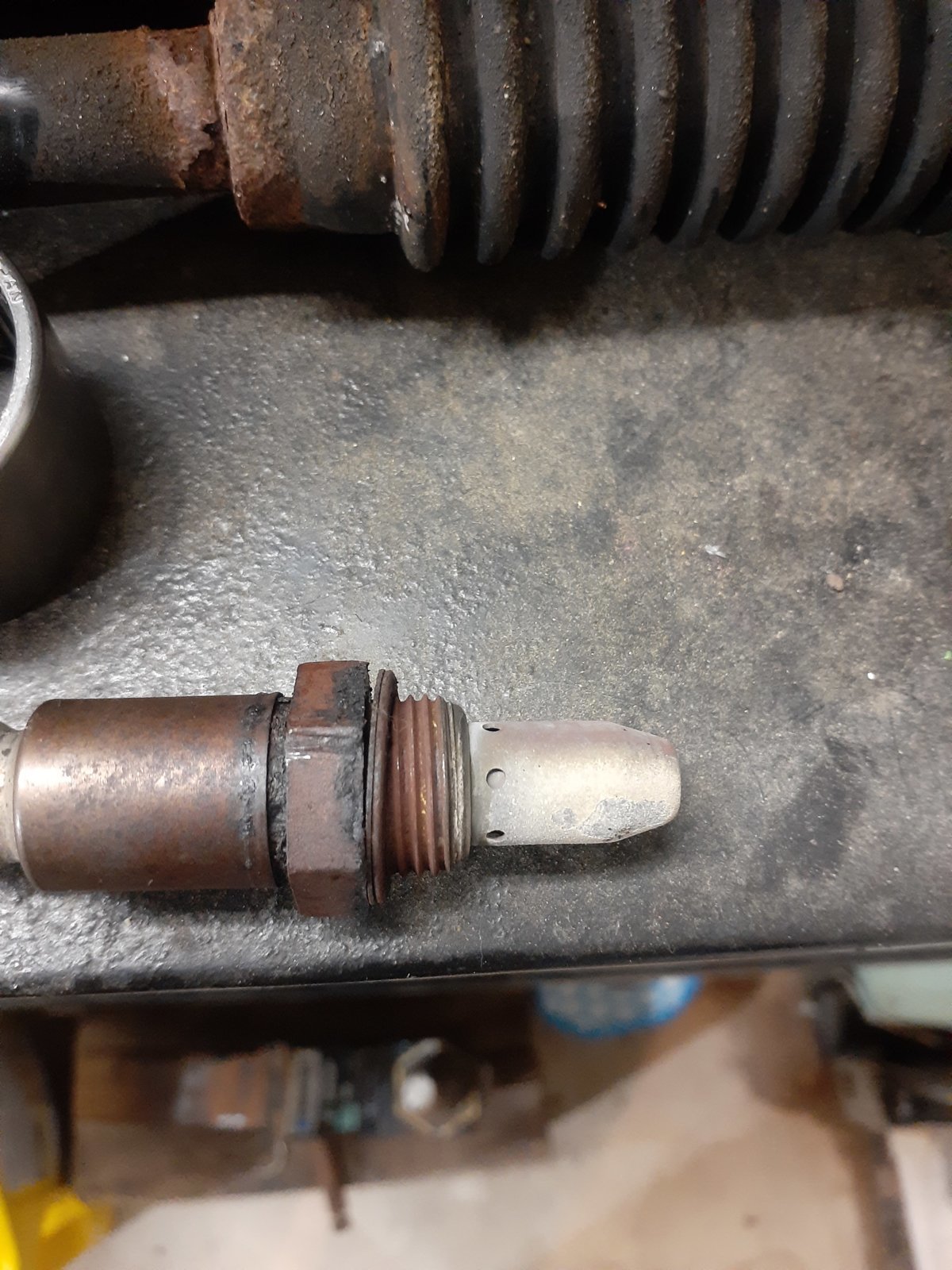

    Stuck the plugs back in, replaced AFR sensor, and cleared codes. Drove it around for a while and no lights came on. Thanks for your input!!! Here is a couple pics of AFR sensor that I pulled out. 20240425_193932.jpg 20240425_193917.jpg
